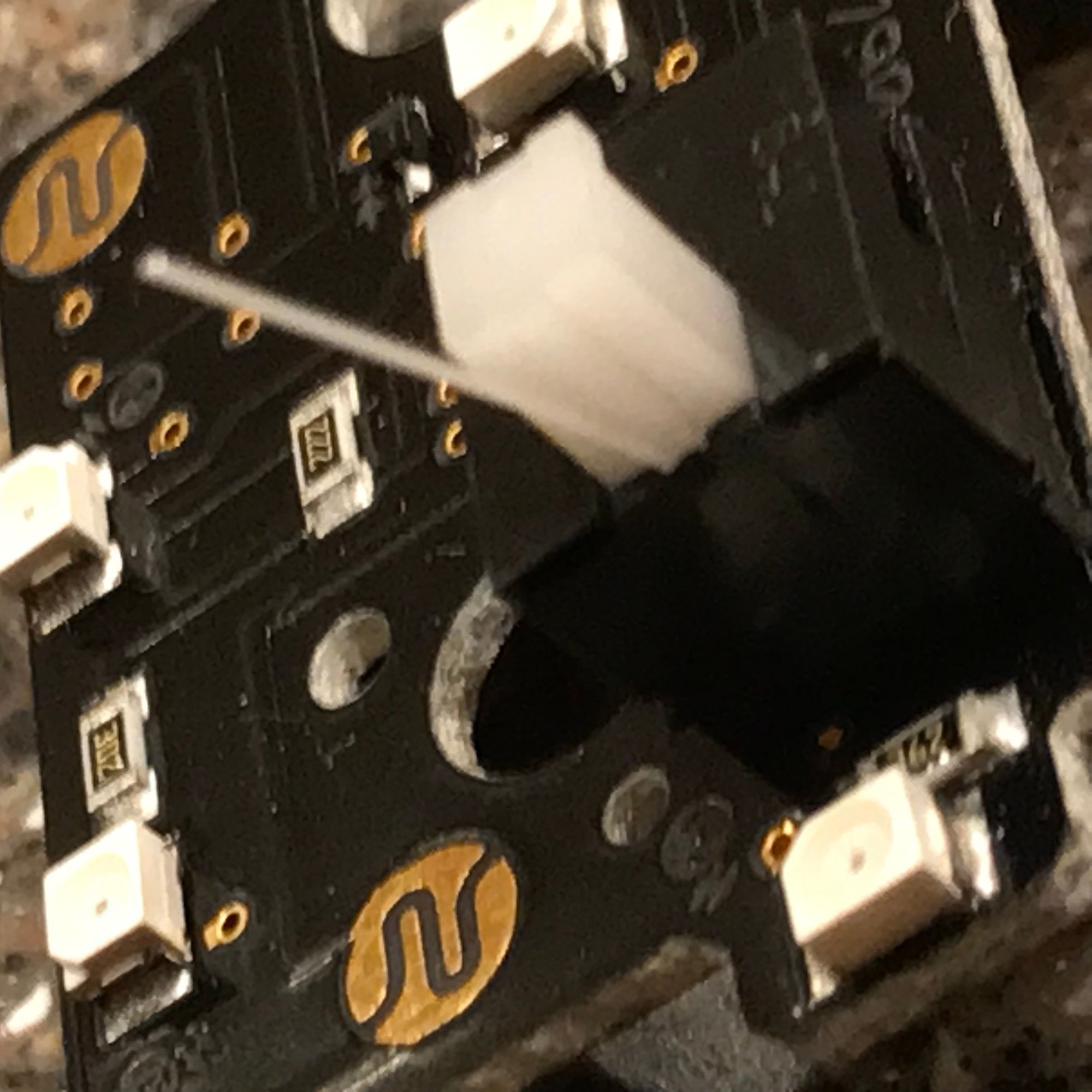

The problem was that the cruise control button on my 2007 GD3 would not stay engaged. A replacement switch was about $125.

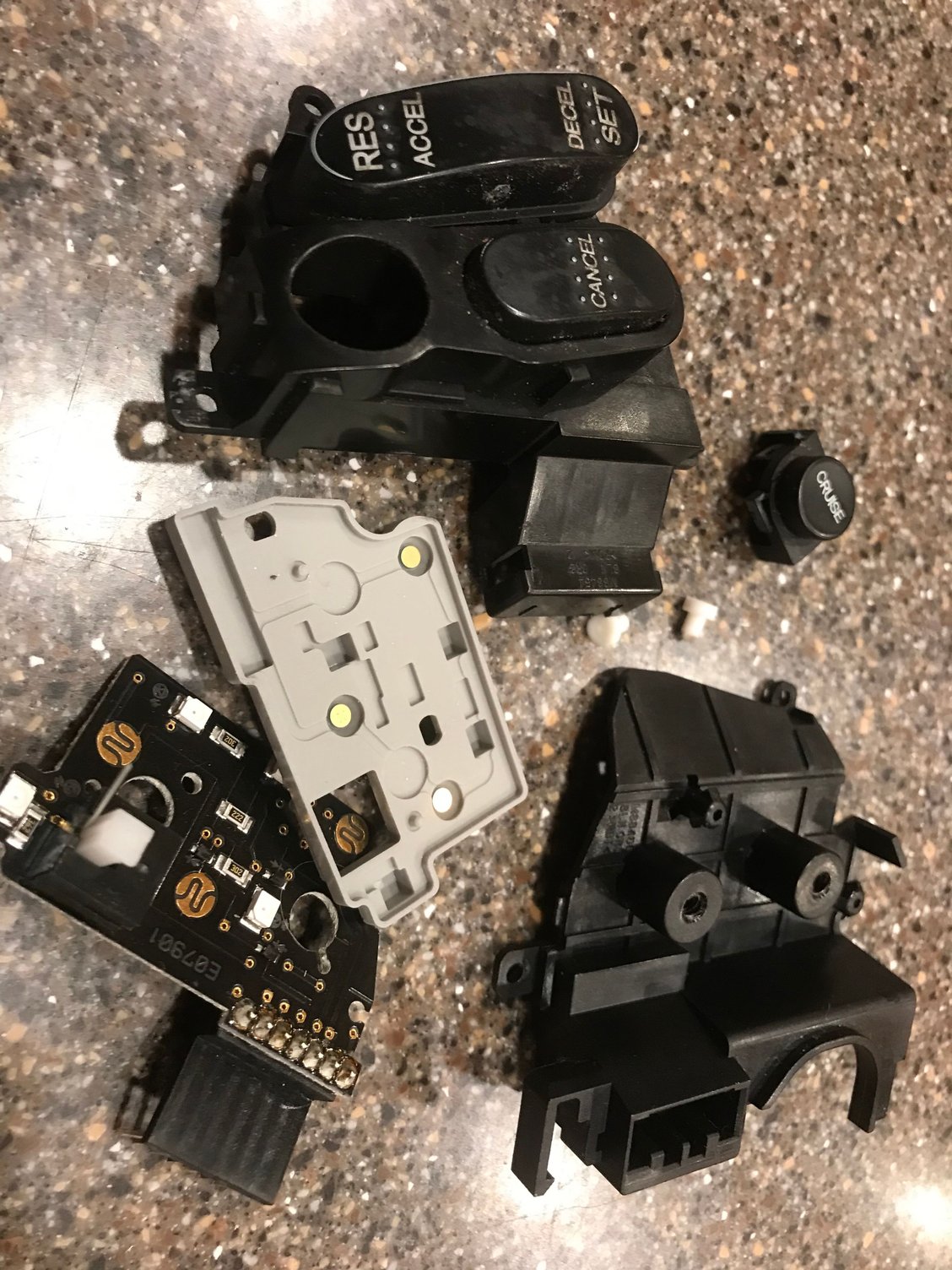

So, I took the module out, and pried it apart to see if it could be repaired. Careful, there are a lot of tiny parts in there. Don’t lose the springs.

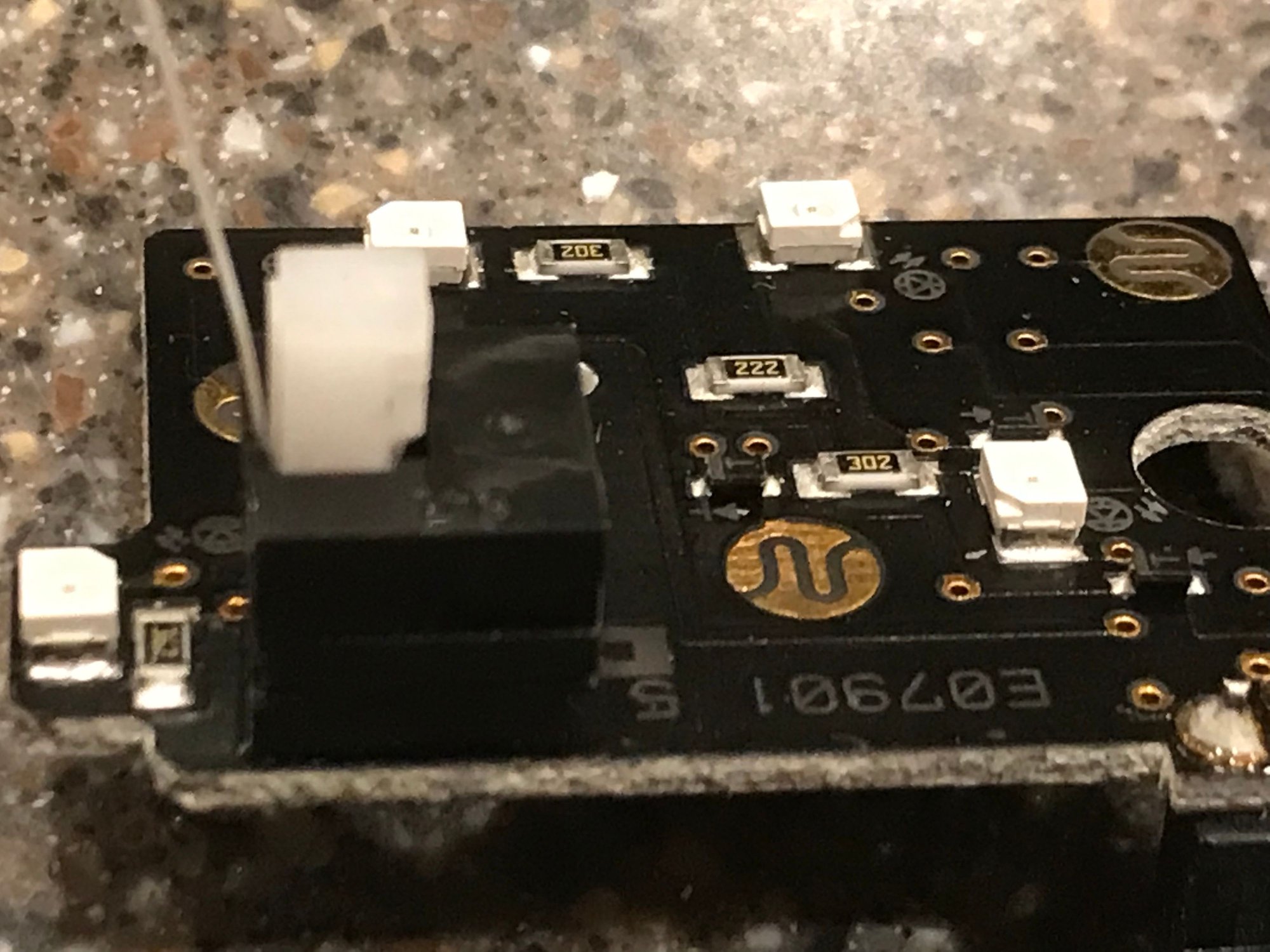

After I gently pried the housing apart, I was able to see how the mechanism was supposed to operate. After fiddling around with it for a bit, I found that I could get the switch to work if side pressure was exerted.
There is a channel that the switch slides along. I found that if I placed a piece of nylon line down that channel, the switch would work. I was going to use fishing line, but chose to just cut a bristle off the kitchen dish brush instead.
I cut the line flush with the top of the switch, Once put back together, I don’t believe the line will be able back out. So, I put it back together. The switch now works again!
