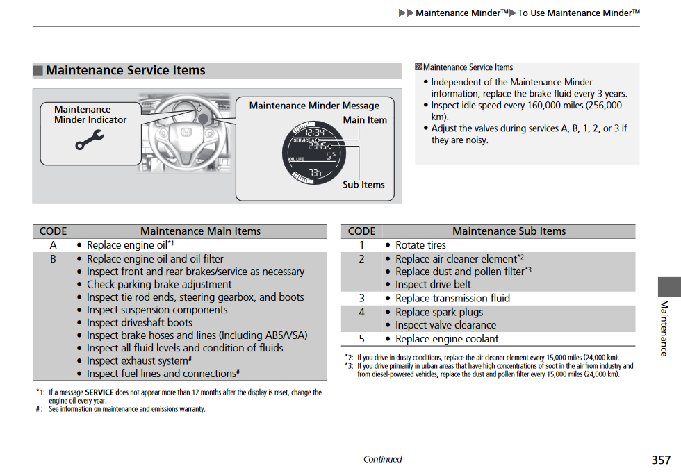

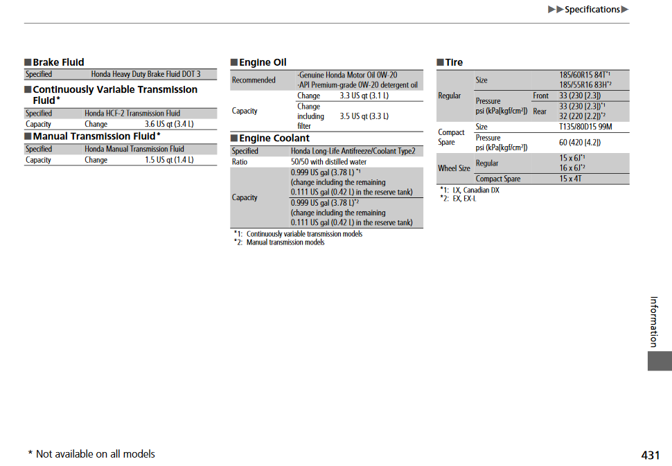

I don't have a 3rd generation Fit, but was able to download and skim the 2016 owner's manual. Here is the fluid information, followed by the quantity required.
Here is the information about the Maintenance Minder codes that should indicate scheduled maintenance, including for the transmission. As the previous commenter said, if you have no record of the service being done it would probably be wise to do it soon, regardless of what the Maintenance Minder is (or in your case, isn't) telling you.

Originally Posted by howarejew
Thanks for uploading this! But what does all the dots stand for? Don't know how to read them.
The dots align with the months or miles (this list is in km so if you need miles, convert) at the top that the maintenance should be done.
