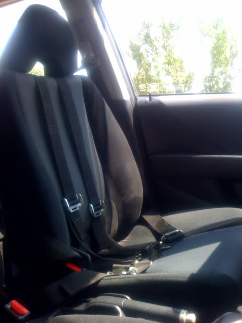

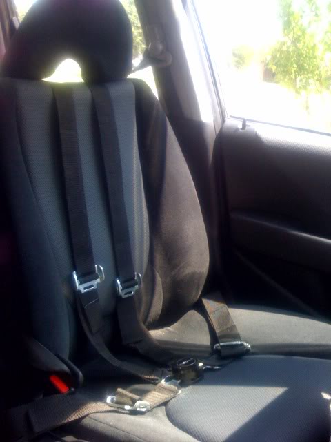

here are some pics of the install
the finished product
another one

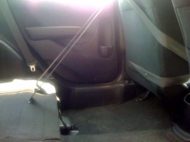

how it looks from the rear, i wrapped the stock belt around the back so the car wouldnt beep at me for not wearing it
side angle of the rear

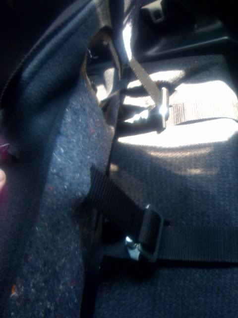

these are the slits we cut in the carpet to make it look cleaner
this is how it looks under the carpet

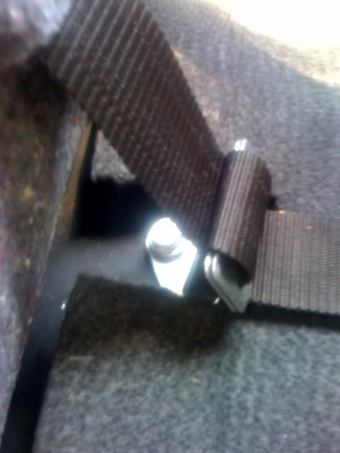

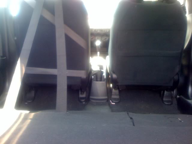

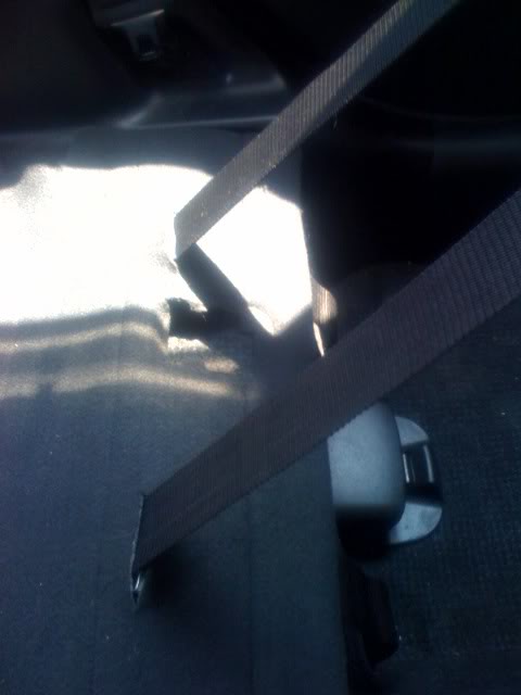

this is a close up of how the shoulder straps are mounted. i nolted them into the holes for the rear seats, the cut a 5x2.5inch rectangle out of the carpet so it wouldnt buldge over the brackets

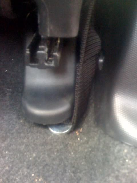

to mount the lap straps we just used the bolts for the front seat brackets. and the plastic covers still fit

there are SOO many things wrong with your setup it's really not funny
please do not use your harnesses until you get a rollbar and can properly install them... for your own safety. seriously. even a minor fender bender will cause spinal compression with that setup and paralyze you.
a simple $2 child seat safety H clip and the OEM belt is equally as effective at keeping your ass in place in turns yet INFINITELY safer.
please take my advice as a HPDE instructor

i am completely aware of the risks of using an improperly mounted harness as well as how to mount and use them safely. ive done a whole lot of research on the subject because i have wanted to run harnesses for a while but knew nothing about them at the time.
i dont plan on running this set up forever and definitely know better than to use it for daily driving, i can say that since i have installed this i have worn it for no more than twenty minutes total. i mainly installed it for the show factor and for a little more comfort on the turns until i get my harness bar which shouldnt be more than two more weeksfrom now, i also plan on getting some buckets very soon.
once i have everything i need i can promise you that they will be mounted to the right places and at the proper angles.
