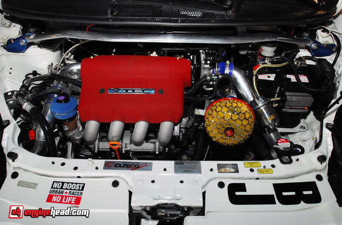

all in gonna say is .......
cnam!!!!!!!!!
