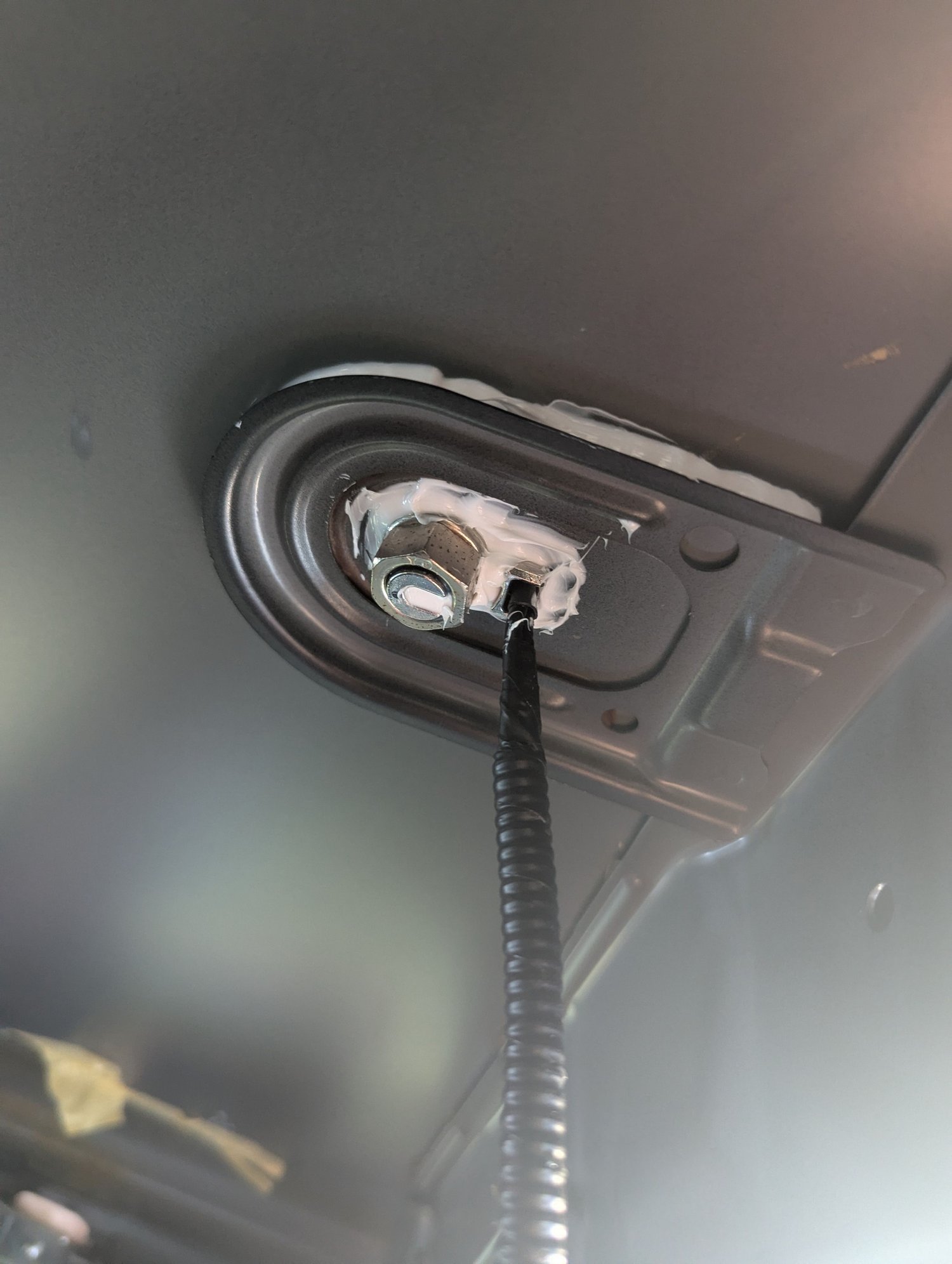

Old May 26, 2025 | 02:39 PM
tonyvillegas's Avatar
Joined: Dec 2023
Posts: 91
From: Rialto
I had the same issue with mine, but because the antenna was slightly loose. Since I was planning to add dynamat to the roof, I decided to just drop the whole headliner. I literally screwed the nut off with my fingers, so what I did is, I added seam sealer to the bottom of the gasket that sits on the roof, I added silicone to the inside of the base and I added blue loctite the bolt and tightened it up.
