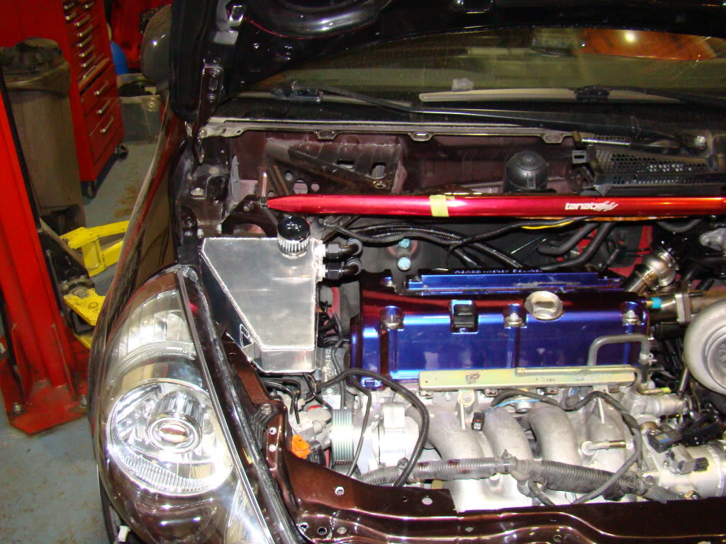

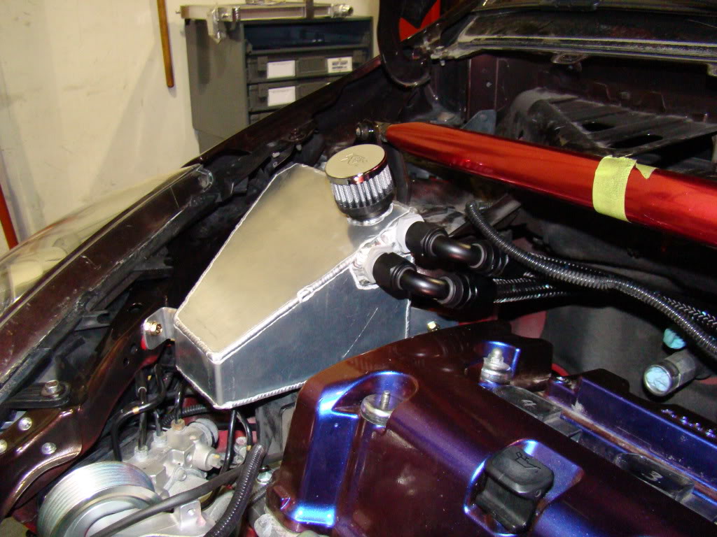

here's mine

is that a T fitting?
Old Jan 21, 2011 | 09:01 AM
  #36
DiamondStarMonsters's Avatar
Posts: 4,428
From: Chicago, Illinois
Yup looks like a barbed t-fitting!
so you're sayin it's fine to run a splitter into the catch can? where is that other line from?
