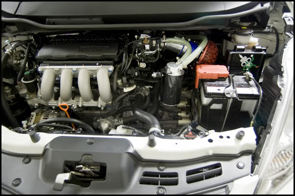

The reasons why I just installed a catch can is do to the fact that I track my fit constantly and canyon run. My fit runs constantly at high revs during long sessions. I have found about 3 table spoons of oil coming from the pcv line in my PRM instake every time I cleaned it at about 5k miles.
Here's mine =D

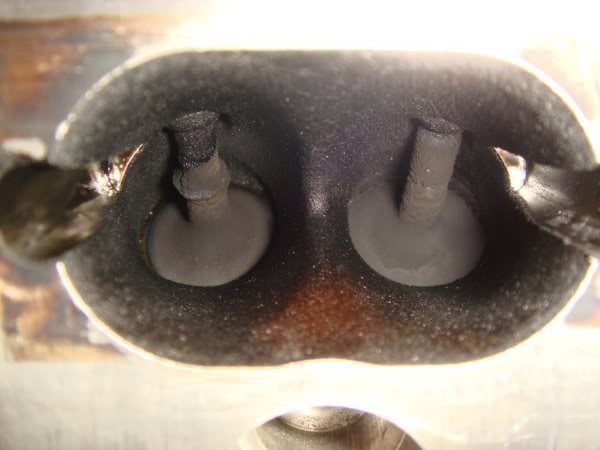

you may not notice it if you don't check your intake regularly I do because I live out in the desert constant dust and sand is a issue.
but your right about the race application =D I just figured I would extend the life of my motor by keeping my valves from looking like this at 60k miles

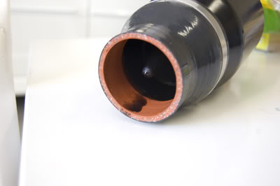

Here is what I saw when I checked my prm intake after 10k miles found about 2 table spoons of oil the rest was trailing up the maf into the manifold. Which is why I decided to get a catch can

so I guess my next question would be... which can? are these cans just the same as others?
Well you basically just need something that has a drain at the bottom some sort of filter media like 000 gauge steel wool to collect funky stuff and take oil out of suspension. Then you need to look for fittings and lines big enough to accommodate the amount of air you expect to move.
If you just want something functional? Just about anything you find in a Summit or Jegs catalogue will do!
For super blingy I would call up places like JM Fab, Shearer or DVDT and they will make you something otherworldly.
On an NA Fit? -4AN or -6AN, I would just go straight to -6AN (3/8").
On a boosted Fit -6AN at the absolute minimum, preferably -8AN. I am having -10AN (5/8") fittings put on my 1G's valve cover this spring. I currently have almost no blow by even with looser (.0040") Piston to Wall (PTW) clearances for my forged pistons because they expand with heat.
But I am doing this in the event something happens I want it to collect what comes out so if I am on a standing mile track like the Maxton or Texas Mile at the top of 4th or 5th I don't spray oil everywhere and either start a fire or lose control. That is if they would even let me pass tech without one.
Though the Land Speed guys at the Loring Timing Association in Maine are supposed to be far more strict...

Your making sense and you are exactly right, it would create a pressure differential and it would somewhat defeat the purpose of the can.
You should route them both through seperate lines to the catch can. Most of them have 3 fittings. One from each.
This way you aren't screwing with the metered air (post-MAF sensor on a GE) in the system, this would basically act like a vacuum/boost leak. Which would cause you to run excessively on a Speed Density computer like that in the GD. And on the MAF'd GE it could cause all sorts of annoying hiccups and driveability issues.
So PCV, Valve Cover and Intake all should get dedicated lines. The can is there to help alleviate the pressure in the crank case and cylinder head by using the vacuum of the intake.
