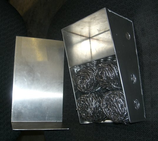

@BC: if I'm not mistaken... that type of catch can does not have any mesh on the inside. The mesh catches the oil when blown into the catch can.
Old Jan 21, 2011 | 11:48 PM
  #49
SilverBullet's Avatar
Posts: 2,304
From: Illinois
I guess you can modify it and use a screen on the enterance side so that water doesn't form, but the fumes would follow it to the bottom and gather with out it, because oil is heavier.

Not true, Oil can come in and out and only catch some of the oil or not at all. It really depends on how much pressure there is. Like my old setup, my catch can never filled at all. It stayed only a few drops full. A baffle is needed (mesh) to help catch the oil and bring it downward.
Old Jan 22, 2011 | 12:09 AM
  #51
ThEvil0nE's Avatar
Posts: 3,626
From: Illinois
I agree. The amount of pressure used to dump the oil into a rather small catch can will definitely need baffling (don't know if that's a correct word lol). Without it, most of the oil sprayed will be sucked right out into the intake.
Well we will just disagree, The mesh would just act like a wick and allow the oil to go up. It also depends on the shape of the catch can, The one in question is from a air compressor that is shaped to collect on the bottom.
