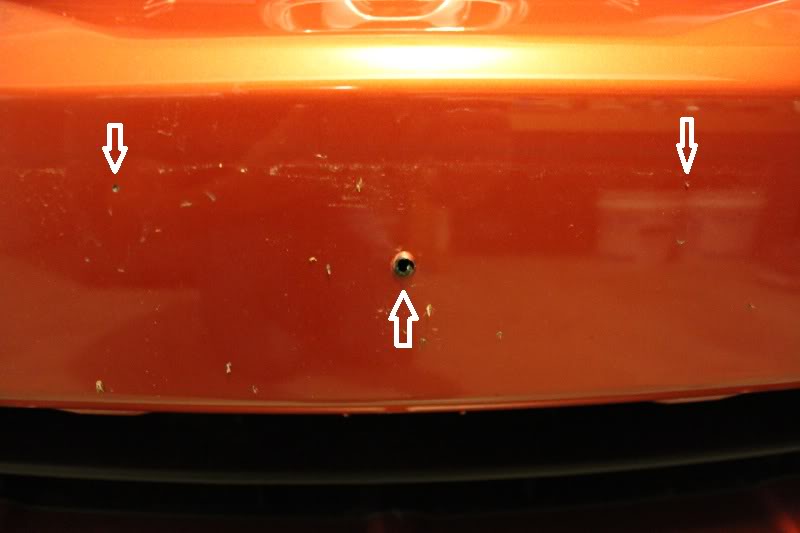

Hello, first post. I bought a 2012 Honda Fit Sport last week. I checked the tag before I purchased. Barely pulled the top and it separated a little from them bumper and I checked to see how it was mounted and noticed it was mounted from the bottom. It wasn't till a few days later I removed the tag and realized it was drilled through the bumper. Not only did they drill through the bumper the screws that held the dealer plate on had also went through and on into the bumper enough to take off the paint. So that's one large hole and 2 places missing paint on a brand new car. Where I live and where the dealer is located isn't even a state that requires a front tag. My wife swung by the dealer and showed them. They told her where she could get it fixed for "$50." Any thoughts on this? What should I do? What have you guys done to fix? Maybe at least someone will see this and be aware before they buy. My S2000 has the mounts which have bumper plugs so I didn't see this coming, I should have checked better.
How will this affect the warranty if these paint places continue to grow in size or cracks?
I LOVE the car, but this is disappointing.

I had the same middle hole in my bumper. I discovered it when I was moving the plate to a lower position. I don't know what is wrong with these dealers who have no concern over causing permanent damage like that! I was able to find a small plastic upholstery plug at the auto parts store. I cleaned up the burr in the plastic hole by hand, using a large drill bit to add somewhat of a chamfer. I then snapped in the upholstery plug and since my car is black, and the plug was also gloss black, the result was satisfactory. I suppose if you wanted to try the same method, you could first paint the plug to match your bumper. The plug looks like part of the bumper and you don't even notice it. As far as the two smaller holes, you may just have to live with those. They won't be noticeable from a distance.

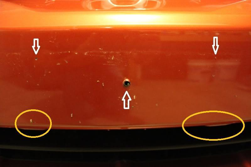

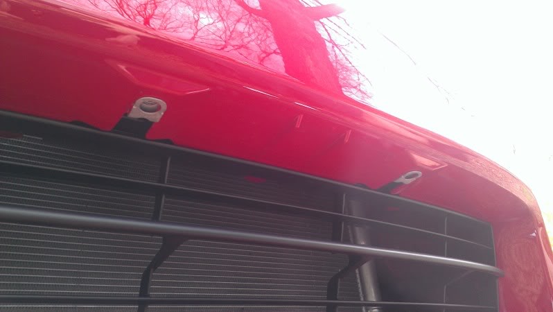

This is in no way acceptable, the areas that I circled are mounts for a front plate so that no holes need to be drilled to put a front plate on. The dealer chose to ignore these for some reason and drilled your bumper.

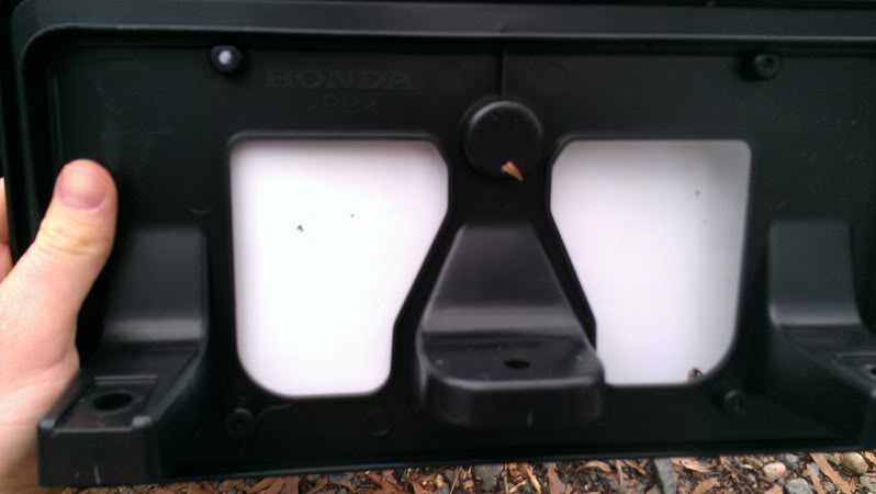

One more thing, the bracket used is a Honda branded part.

Actually, "drilling holes" is part of the install.
But the correct location is in the bottom part of the bracket, pointing upwards into the bumper. You notice that the bracket has three holes, with the outer two matching the clips on the bumper. That hole in the center is for the tapping screw... as per the PDI (pre-delivery inspection).
