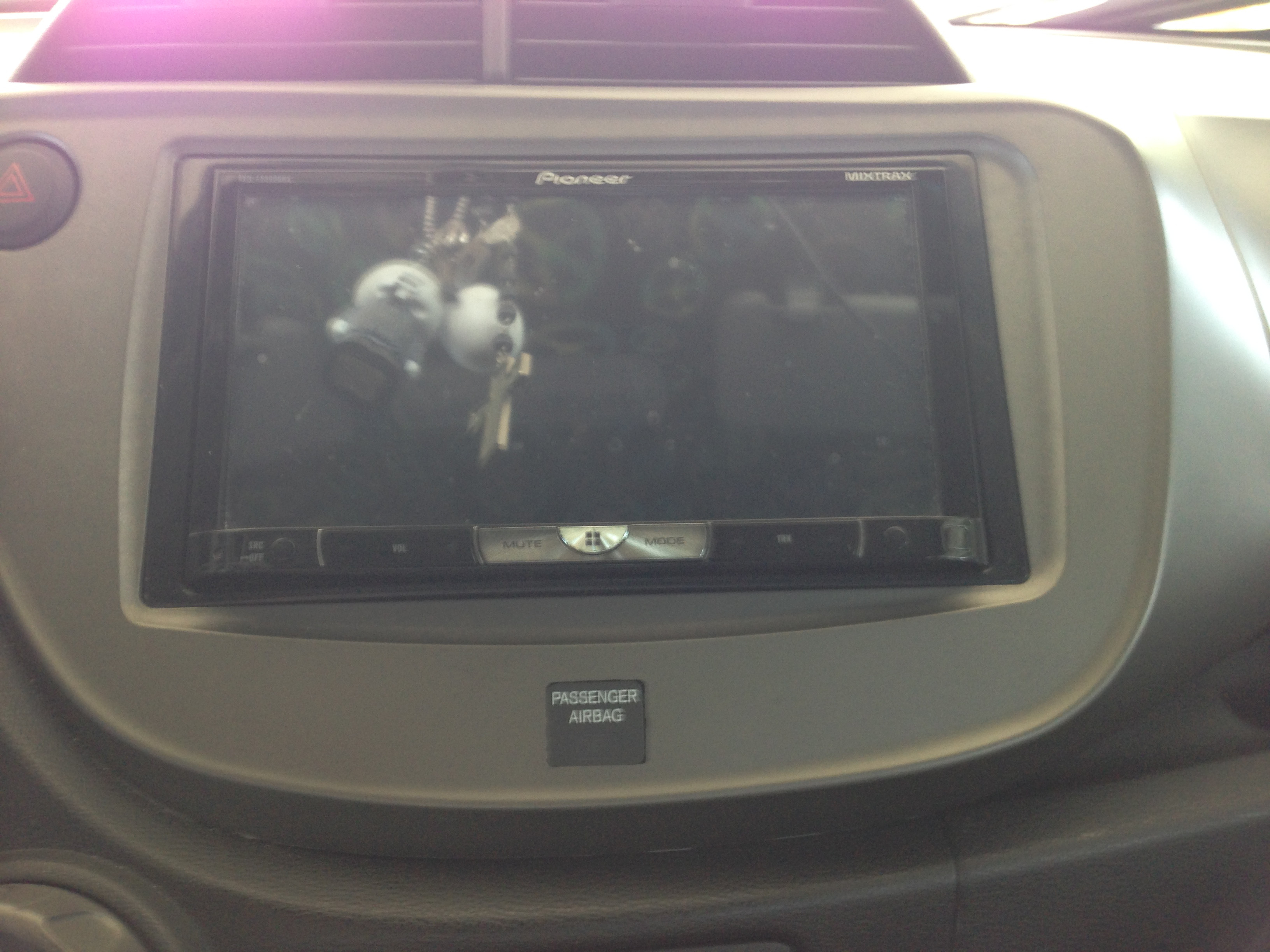

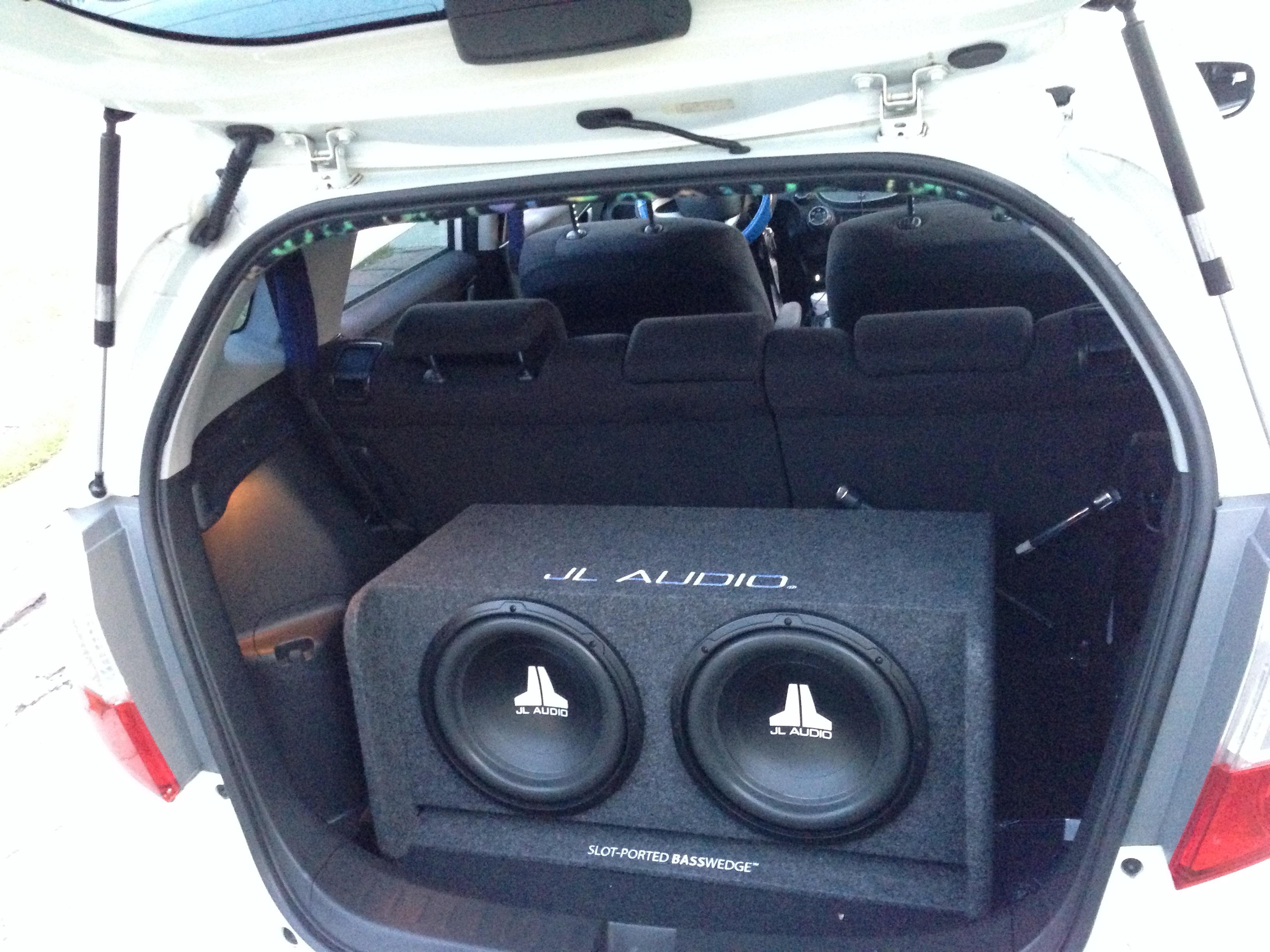

It's been a few months since my last visit here. I finished the installation few months back but I've been lazy and I hadn't uploaded any pictures of my upgrades. I went ahead and removed ceiling, floor carpet, door panels everything. I went mad, when I removed the seats and the floor carpet, I said to myself what the fuck I am doing. I created a fucking mess, I didn't think I was going to able to put everything back together but I did. I had more trouble putting back the sun visors than removing the floor carpet. I run the rca cables through the center of the car, and the power cable through the side. I even went ahed and installed a sirius-xm receiver. I didn't take any pictures of the sound deadening installation or the car stereo; I figured there are plenty of DIY here at fitfreak. I didn't have to get a better battery, or upgrade to a more powerful alternator. The lighting it's fine no flickering or signs or when I turn on the car.
This what I installed
Pioneer AVHX8500BHS
Kenwood Excelon XR900-5
JL Audio CP212-W0v3
Polk Audio db6501
Polk Audio db651

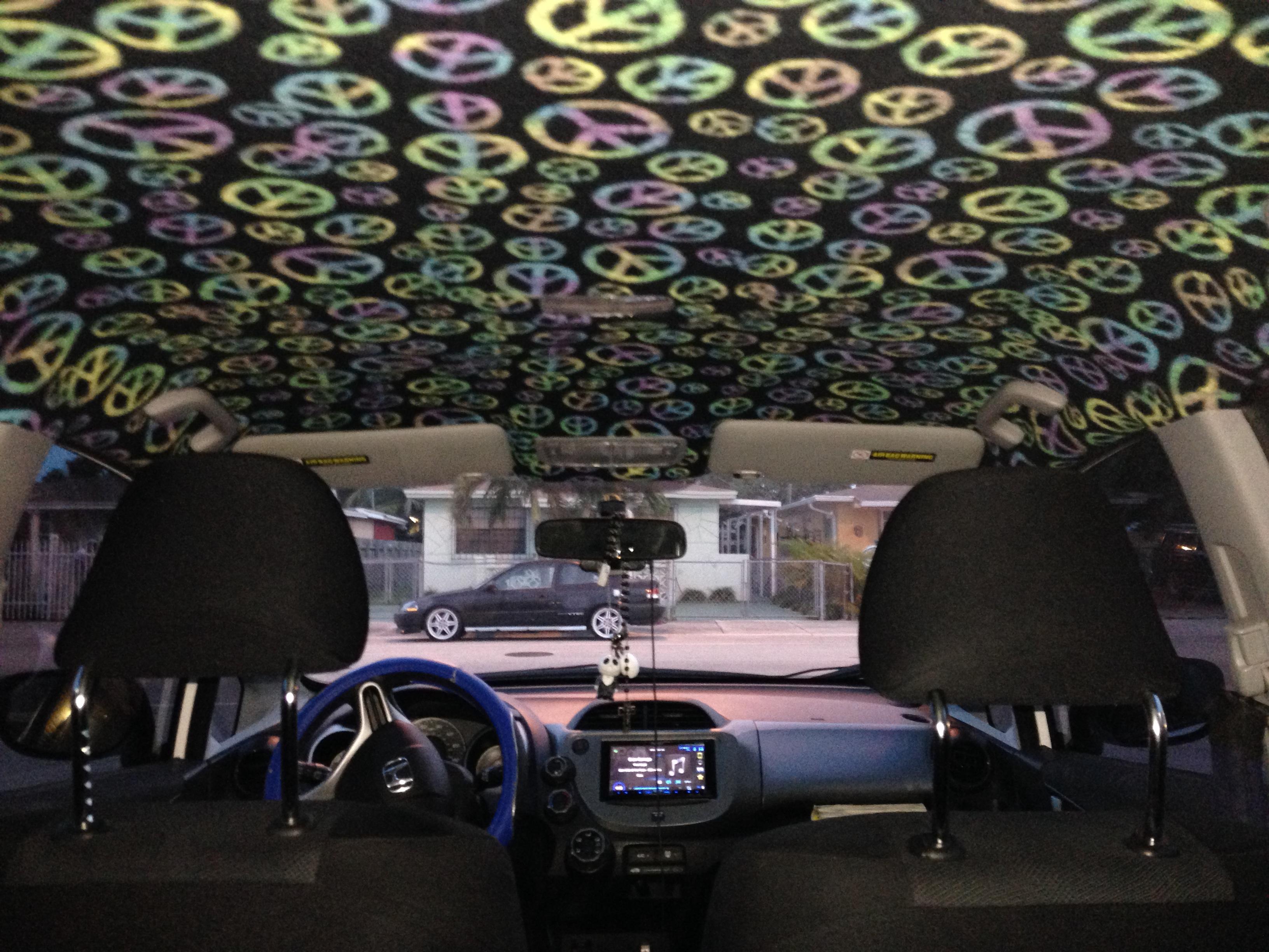

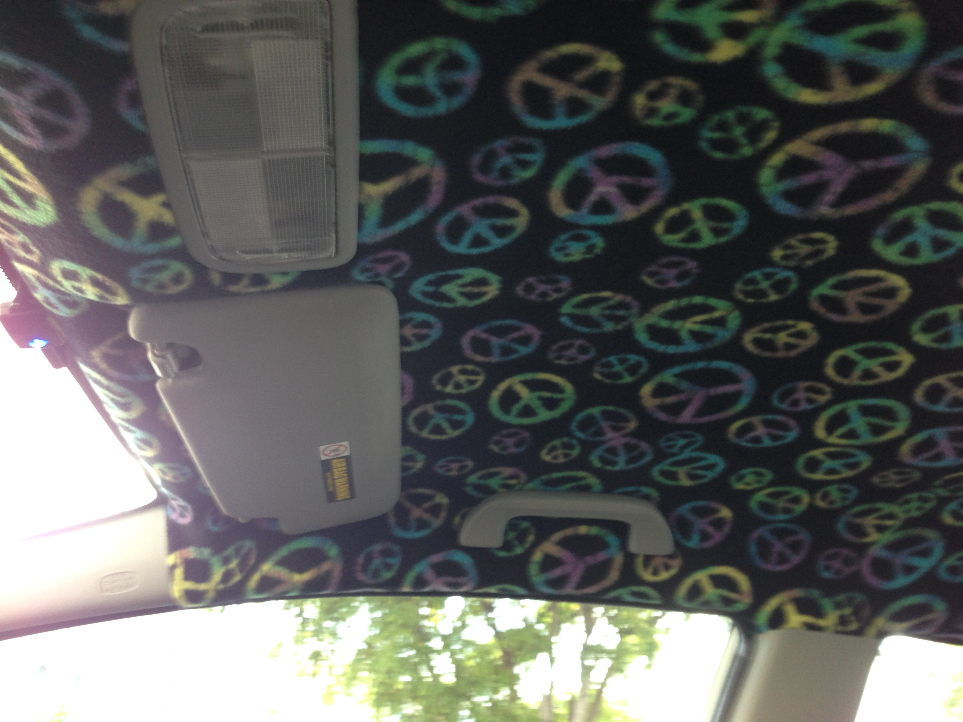

Thank you steve & caroline crussing for your help I forgot to mention that I also changed the headliner as you can see in those pictures.:thumbu ps:

holy crap. Does the hatch stay closed with the sound turned up?
Jack looks worried.
The headliner is inspired. I think I would need copious recreational drugs to fully appreciate it though.

Hahahahah yeah it gets fucking loud in there LOL. the bass is insane, and jack went fucking deaf long time ago . When i turn that shit up the windshield and the rear-view mirror start shaking LIKE CRAZY it feels like an 8.0 earthquake
