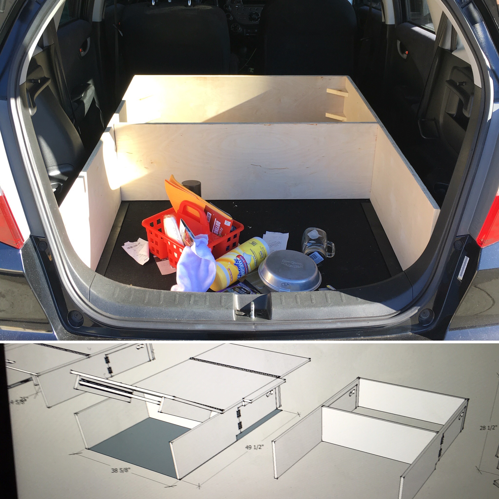

So using this design and the pictures here I created a version based on Poopsicle's design, and have all the dimensions and even a sketchup for it that I want to release.
I'm wondering if I should post it here or start a new thread...
Here are the pictures from my build.
Attached Thumbnails Turning my Fit into a mobile camper!-img_3908.jpg   Turning my Fit into a mobile camper!-img_3804.jpg

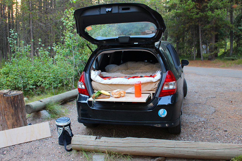

Howdy forum!
So I mentioned this in my introduction post (which I’m sure very few of you saw), but I am turning my 07’ Honda Fit into a mobile camper.
This is a project I’ve thought about for a while, and I finally got around to designing plans and executing them about a month ago. The idea was to install a removable bed in the back/trunk area so that I could drive around, explore the country, and sleep in the car.
Here was my design process:
1. First I spent a good deal of time measuring the space with the back seats folded down flat. I made notes of the dimensions, both with the driver/passenger seats up and pushed forward. I’m only 5’8” but I knew that I’d need to design the bed with the max length from trunk to seats.
2. I designed the blueprints and mapped the cuts I would need to make at Home Depot to maximize the wood scrap. I got all all the supplies and got to work.
3. I built the base. I knew I wanted to have storage underneath the bed, so I built it out of 2x12s. I forget the total length of the board, but I only used one. I used brackets and installed a piece through the middle for stability. This thing is solid:
4. Next came the bed. It is 3 pieces of plywood that sit on top of the frame. I designed it with 2 hinges in strategic spots. The one closet to the trunk allows me lift up and access storage even with the mattress, blankets, etc. It was extremely handy at the campsite. The second hinge is located near the head area. When the driver/passenger seats are pushed forward, that piece lifts forward and adds an additional 14” of space. So when the entire piece is flat, I have 69” of space from head to toe, and 39” from side to side–more than enough more me. Here is a photo:
And here is how the storage is easily accessed:
5. With my scrap wood, I knew I wanted to install a table that slides out from the trunk. It’s about 31”x17” and is a very useful bonus addition that I’m happy I installed:
6. Lastly, I designed the plywood bed portion to fold up into a convenient-to-move piece. The entire thing folds up into a roughly 35”x39” shape that locks into itself:
So I am extremely proud of how everything turned out. To test out the functionality, I drove 9 hours to Yellowstone National Park and camped out for 3 days with my girlfriend. It worked perfectly!
I purchased some special shades to block out the windows and provide some privacy, and they worked great as well.
My first successful car-camping trip was incredibly liberating. I felt free on the road and connected with my car. I purchased a National Park pass and already have more trips planned for this year. My main purpose for joining this forum is to share my design with anyone that's interested, possibly answer some questions, and research my next steps. I want to add a roof rack and a cargo carrier to multiply my storage space, and I'm not sure where to start. But I'm gonna start digging!
Thanks for your checking out my project! In you have any interest in following my car-camping adventures, I started an Instagram account: car_trek
Cheers y'all!

The feeling you get when you conceive an idea, plan it and then follow through with it...the feeling of accomplishment you get never gets old! Great "adventure" with great experiences that add positively to who you are as a person. Kudos to you!

Hey! Would you please post these or send them to me? I want to build this. What model year did you build for?
Old Nov 30, 2016 | 01:11 PM
grag's Avatar
Joined: Sep 2016
Posts: 23
From: Portland, OR
I'd be interested in checking this out, as well!

Thumbs up Care to share sketchup?
Hey, I would love to see your sketchup file for this! Going to take my first camping trip in July and would love to use your build!

This is amazing and I'd love to make this for myself. Would you please message me the full plans? Also, about how long did it take you to assemble the rig?
Please, please, please share with me! I'm out of my element on this stuff and need just a bit more to go on. Thanks!

Made my own!
My wonderful boyfriend and his dad used your post and blueprints to turn my 2013 Honda fit into a camper as well. We use the 1X12 wood has suggested in the comments to keep the weight down.
