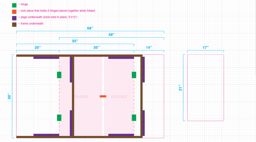

1. First I spent a good deal of time measuring the space with the back seats folded down flat. I made notes of the dimensions, both with the driver/passenger seats up and pushed forward. I’m only 5’8” but I knew that I’d need to design the bed with the max length from trunk to seats.
2. I designed the blueprints and mapped the cuts I would need to make at Home Depot to maximize the wood scrap. I got all all the supplies and got to work.

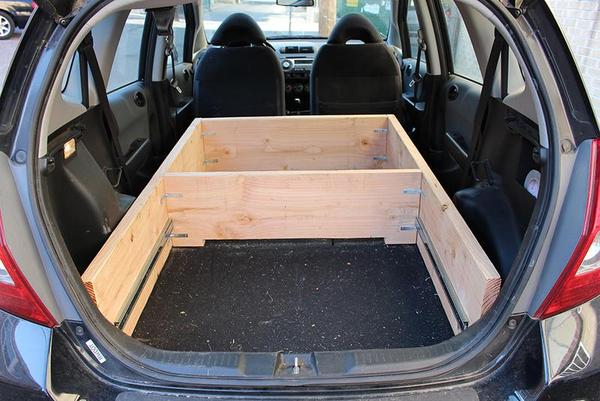

3. I built the base. I knew I wanted to have storage underneath the bed, so I built it out of 2x12s. I forget the total length of the board, but I only used one. I used brackets and installed a piece through the middle for stability. This thing is solid:

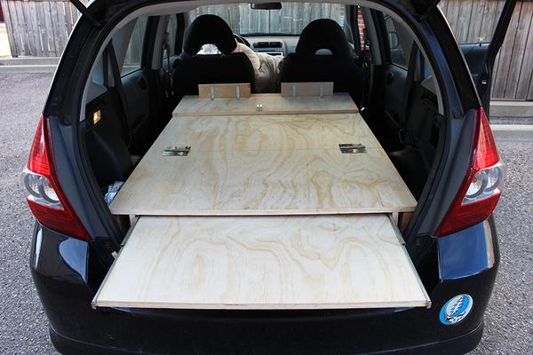

4. Next came the bed. It is 3 pieces of plywood that sit on top of the frame. I designed it with 2 hinges in strategic spots. The one closet to the trunk allows me lift up and access storage even with the mattress, blankets, etc. It was extremely handy at the campsite. The second hinge is located near the head area. When the driver/passenger seats are pushed forward, that piece lifts forward and adds an additional 14” of space. So when the entire piece is flat, I have 69” of space from head to toe, and 39” from side to side–more than enough more me. Here is a photo:

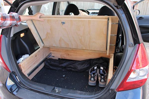

And here is how the storage is easily accessed:
5. With my scrap wood, I knew I wanted to install a table that slides out from the trunk. It’s about 31”x17” and is a very useful bonus addition that I’m happy I installed:

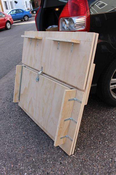

6. Lastly, I designed the plywood bed portion to fold up into a convenient-to-move piece. The entire thing folds up into a roughly 35”x39” shape that locks into itself:

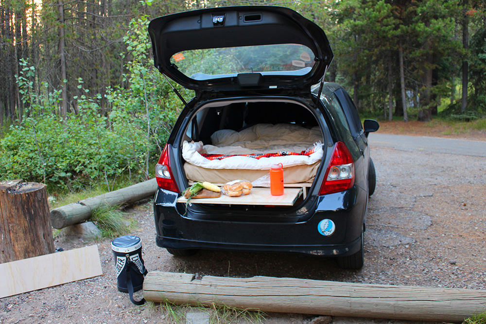

So I am extremely proud of how everything turned out. To test out the functionality, I drove 9 hours to Yellowstone National Park and camped out for 3 days with my girlfriend. It worked perfectly!
I purchased some special shades to block out the windows and provide some privacy, and they worked great as well.

I have the blueprints for the plywood part but can't find the the blueprint for the base yet. Hopefully this makes sense but let me know if you have questions. This is also based on my '07 so other models may have different measurements. The rectangle on the right is for the table, and the dotted lines represent cuts in the plywood.
