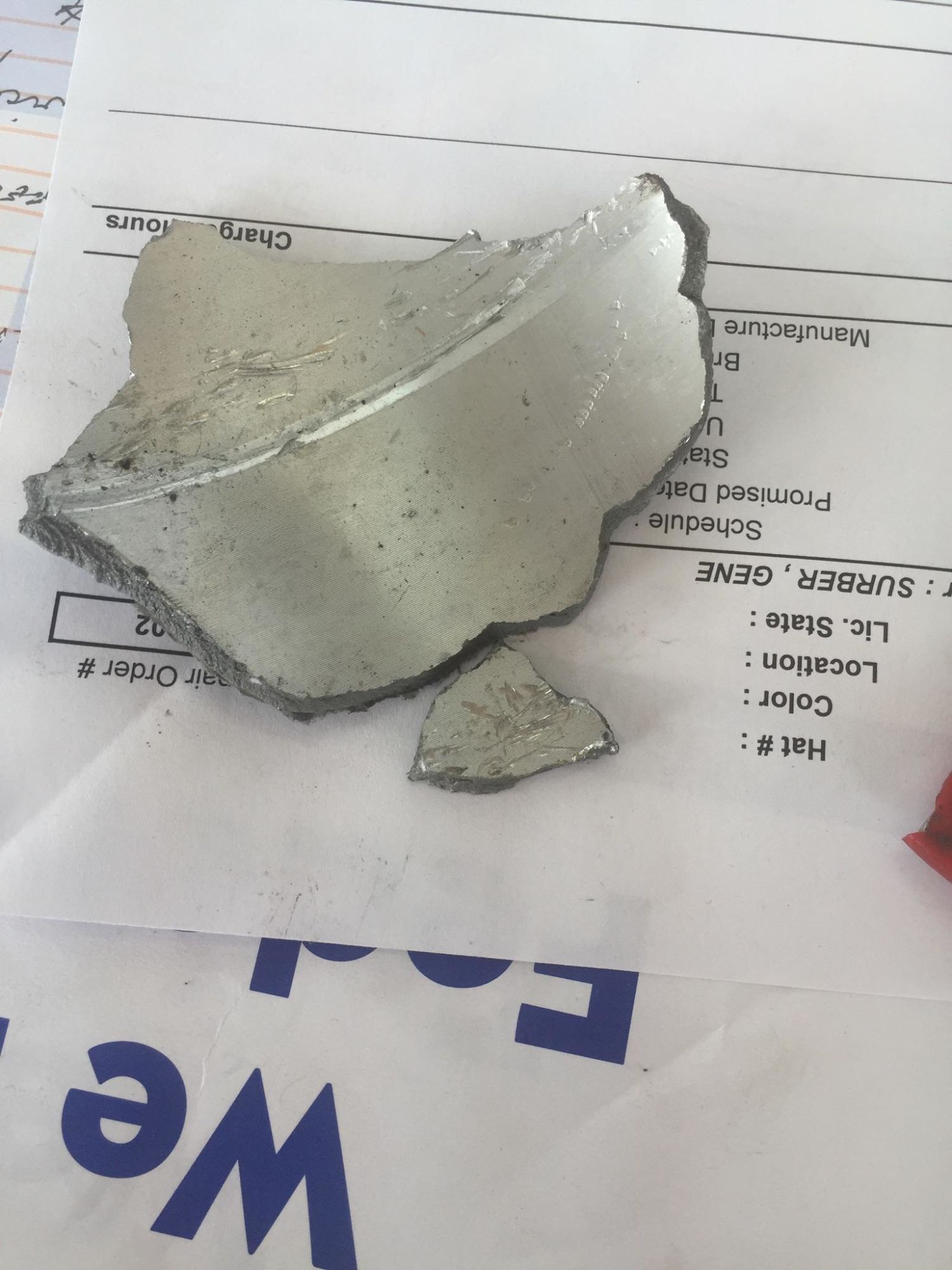

Funny you should mention the compressors exploding. When the second replacement failed, it blew the side out of the compressor the size of my hand. I had never heard of that happening but got an explanation about the oil pooling in the compressor and when it kicks on, liquid doesn't compress so it blows the compressor apart. When she decides what she's getting, I'll probably keep the CRV as a spare vehicle for when I'm working on my Fit and don't have to feel the pressure to get any repairs done so I can go to work the next day. It's been a great car except for the A/C.
