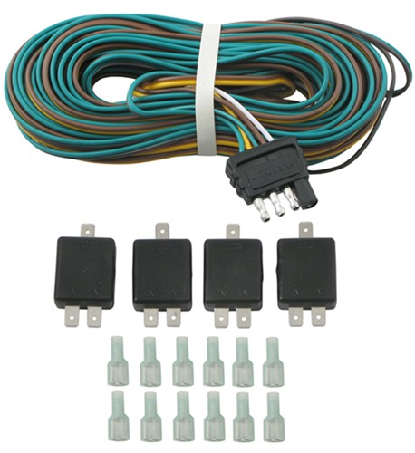

The attached picture is the wire and isolating diode packs I will use to insure that the motorhome 12 volts don't get into or damage the Fit circuit's. More later

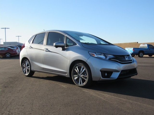

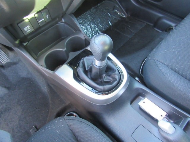

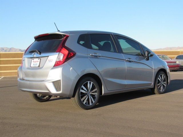

Bought a 2017 Honda Fit EX instead of the Basic LX model.
For the few extra dollars it was worth the extras.
Nicer tires and rims and like the non-key entry and startup.
Moon roof is cool. Wife was happy and that's all that matters.

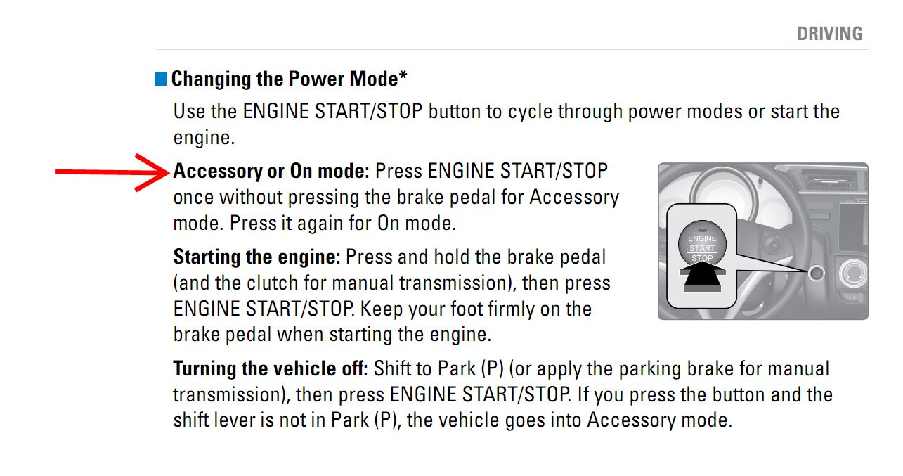

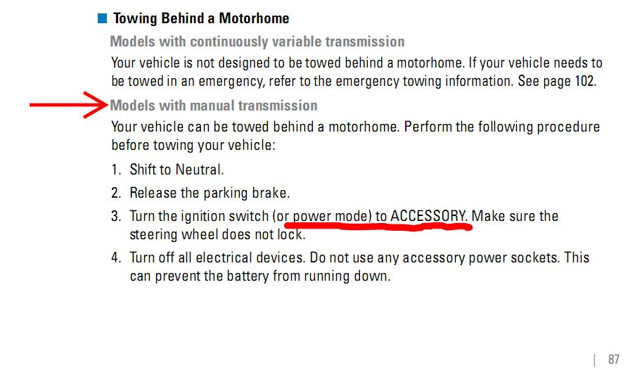

Here is some more information about what you have to do before towing.

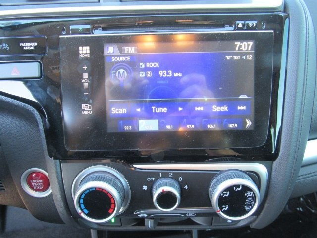

For Manual transmission ONLY you need to use your KEY (LX model) or the Power Button (EX Model) to place the car in Accessory Mode.
This I think is to unlock the steering wheel but have found it also keep the head unit screen al the time. I solved this by removing Fuse # 37 (7.5 amp) during towing. I may in the future install a fused bypass switch.
Here are a few statement from my Owners manual and Quick Reference manual.
Attached Thumbnails Buying a 2017 Fit for towning behind motorhome-capture.jpg   Buying a 2017 Fit for towning behind motorhome-capture2.jpg
