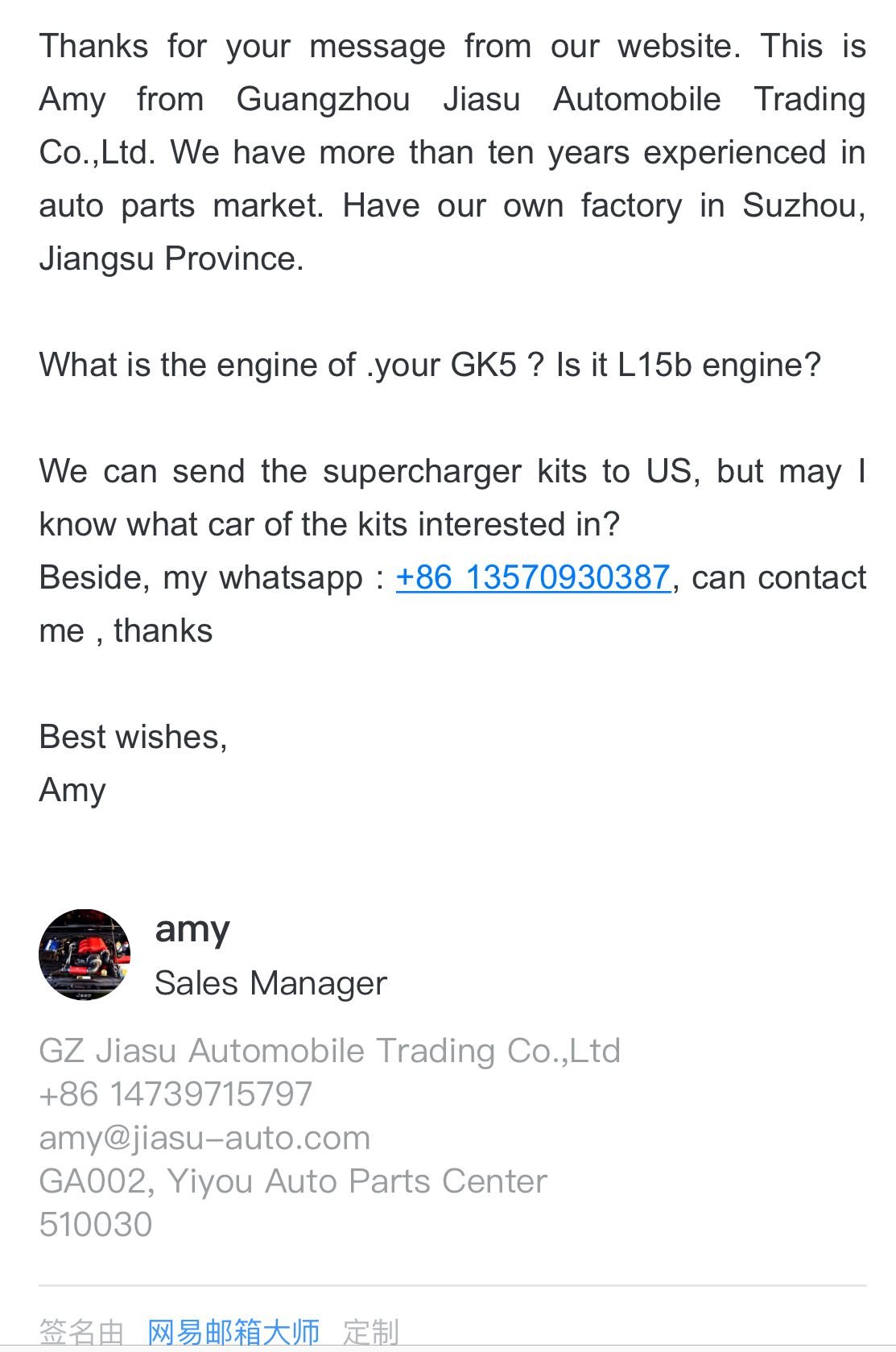

Well I just got a email from a company that makes turbocharged kit for fits the only thing that they are out of the country for me

This is the message
