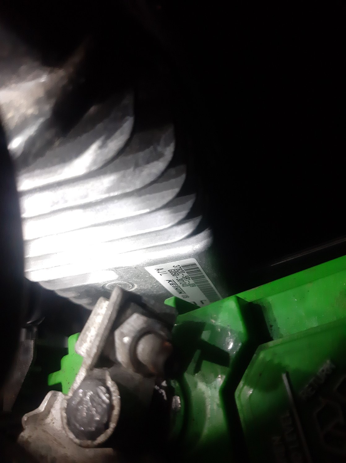

2015 Honda fit Gk5 Rs L15b1 engine
Hello, I have a Gk5 2015 rs with l15b1 engine on it. Its a 6 speed manual one, the rare honda fit😅
I want to retune the ECU but ktuner is not supported, how did you got ktuner for yours?basically its the same engine
Find a picture below for my ECU.
