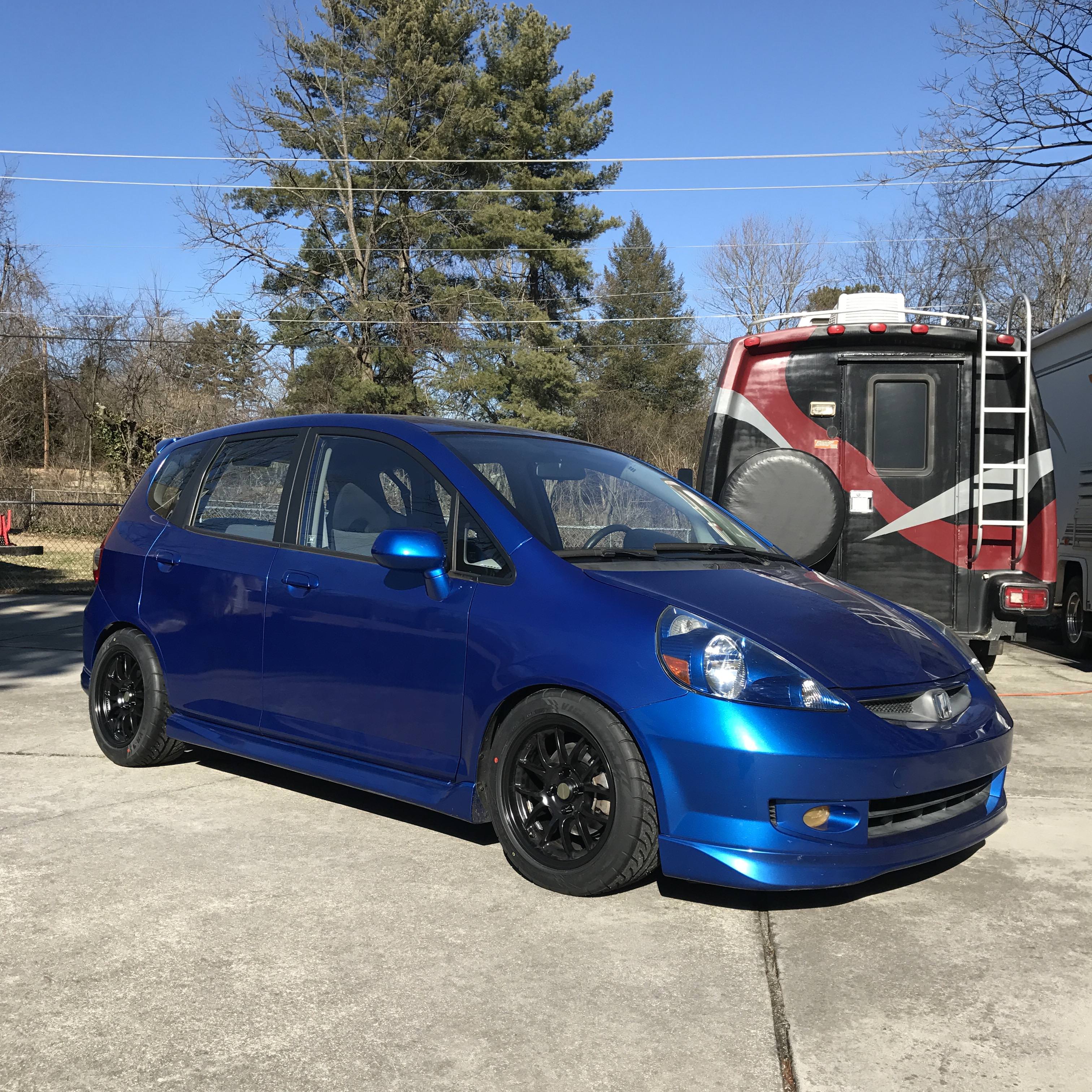

There was some rub.
But, I expected there would be.
Even though I used H&R Triple-c camber bolts and the BC's upper slotted hole maxed out, still rub. And at only -2.5 degrees camber, it wasn't enough.

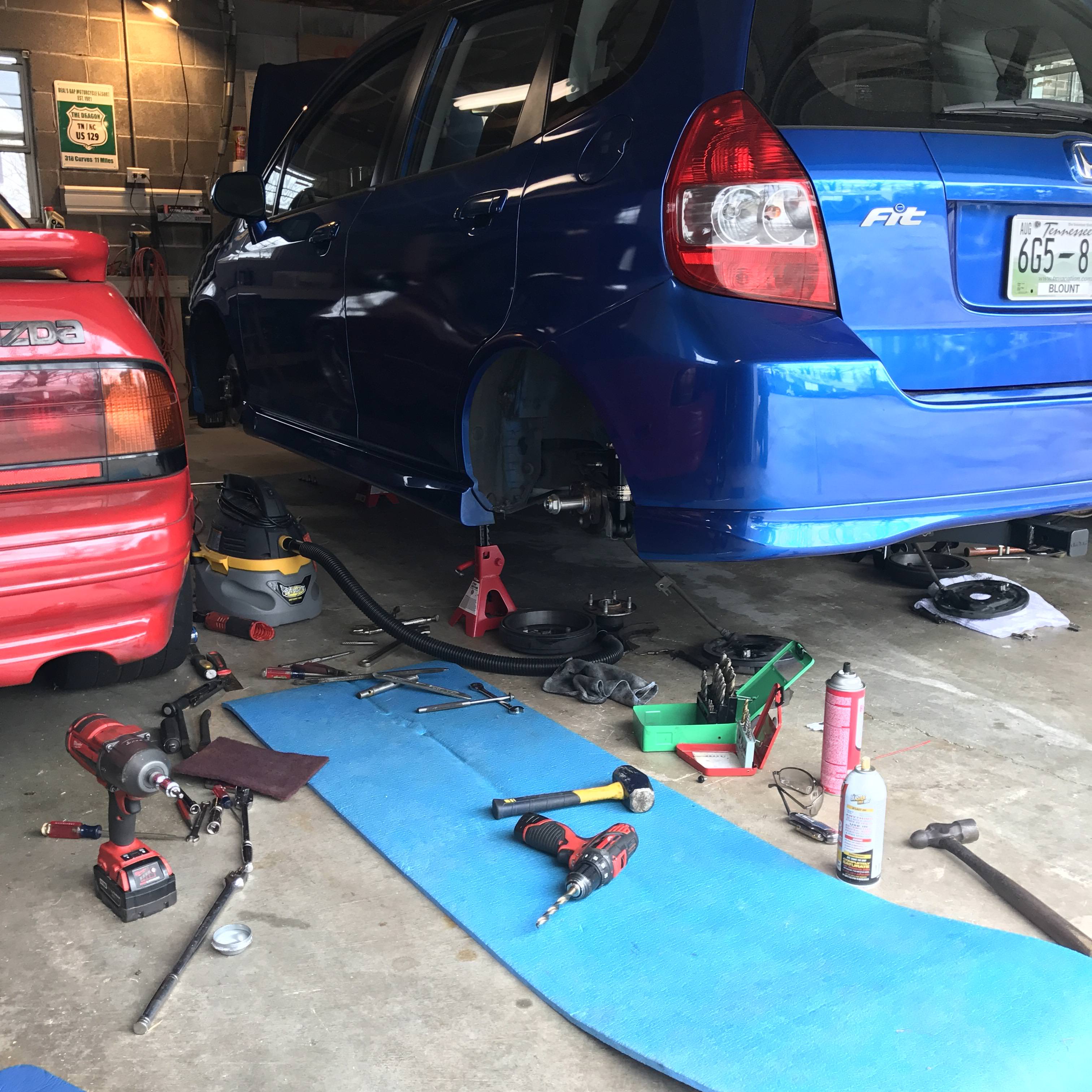

Now for the rear.... Oh lord, the rear

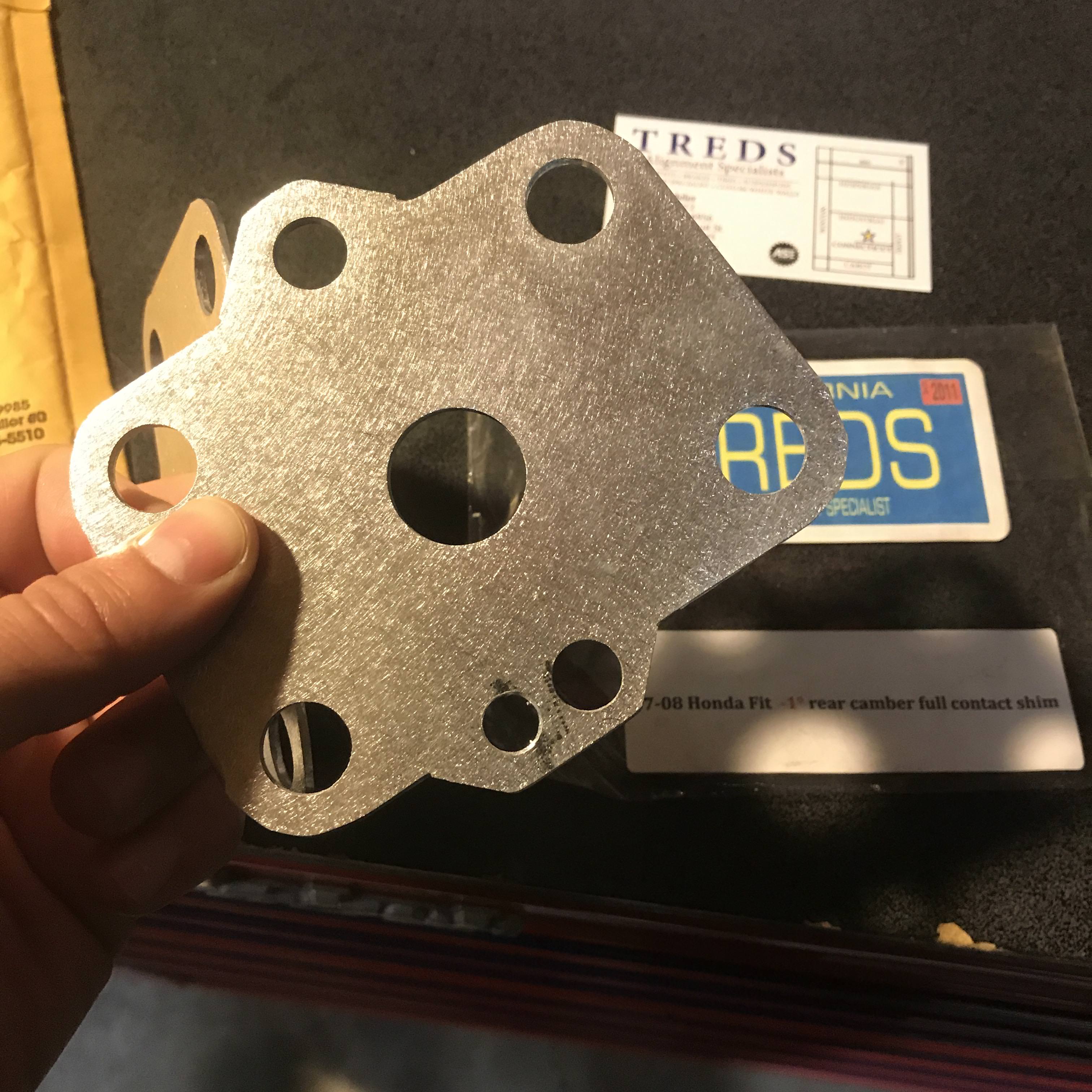

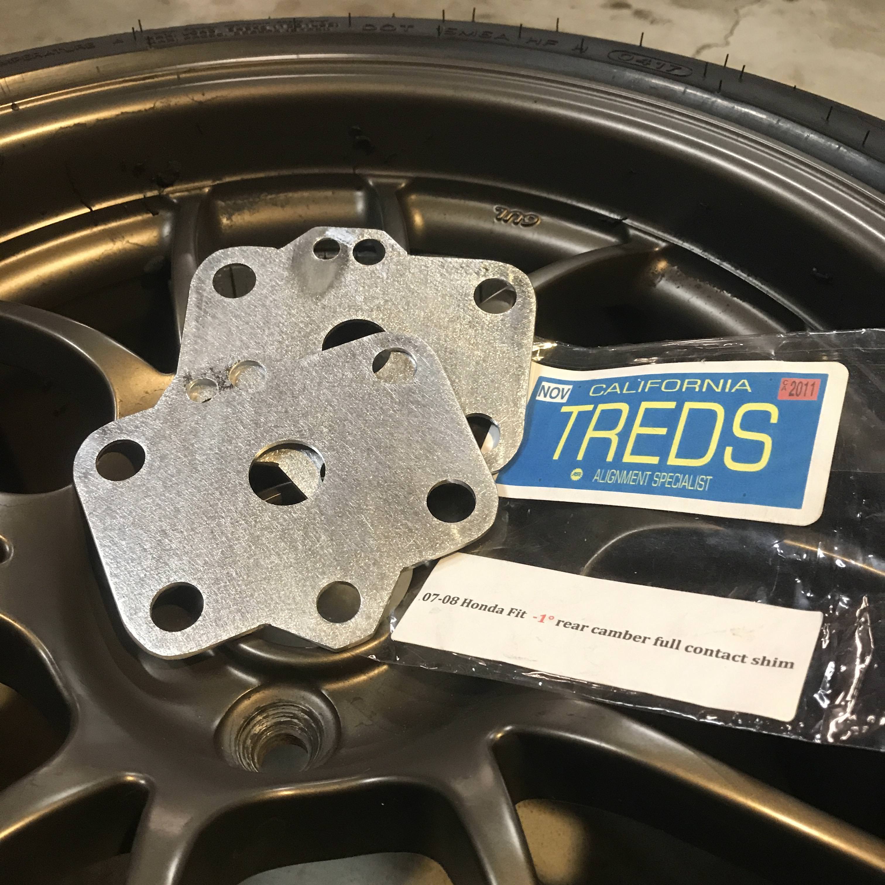

I knew the rear would require more work. Since I had some brake work to perform and really needed the camber.... It was time to install these bad boys!

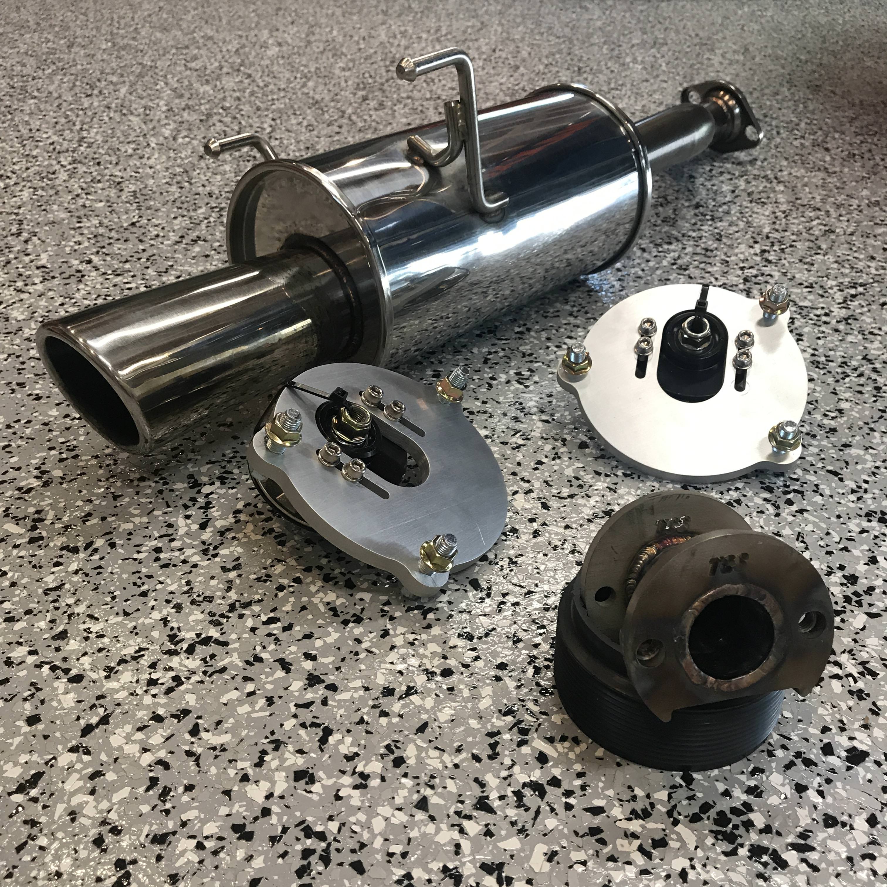

cool little bits... Thanks Tyler

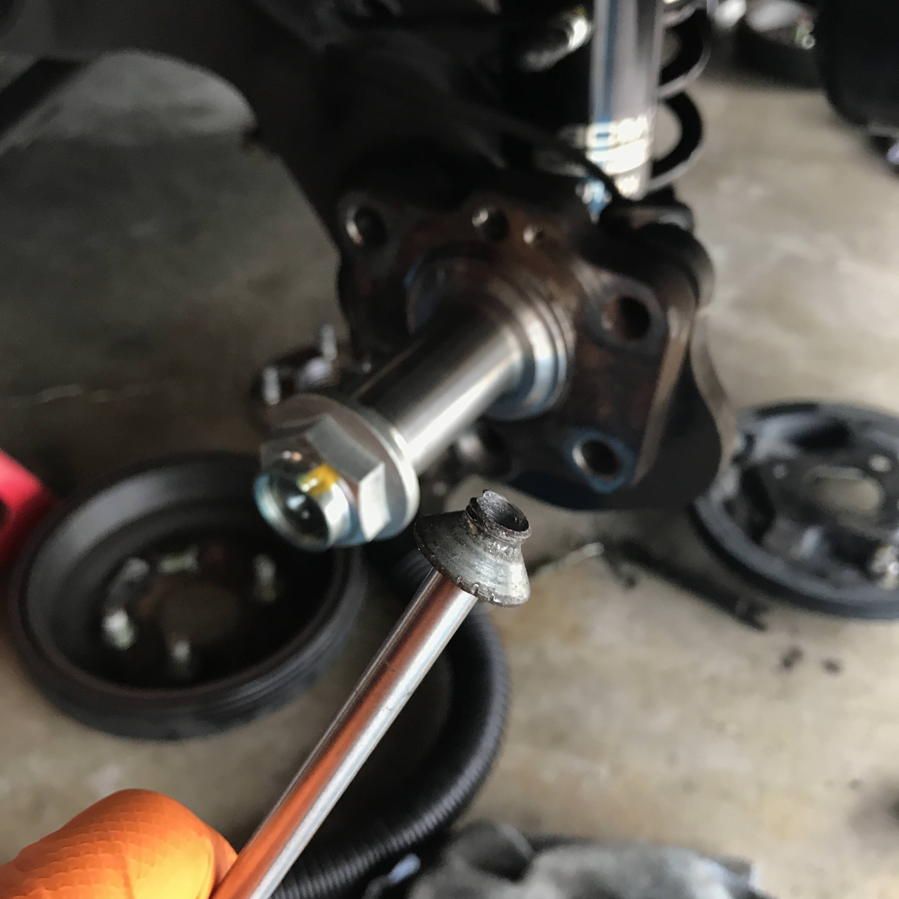

All because of this little bugger.

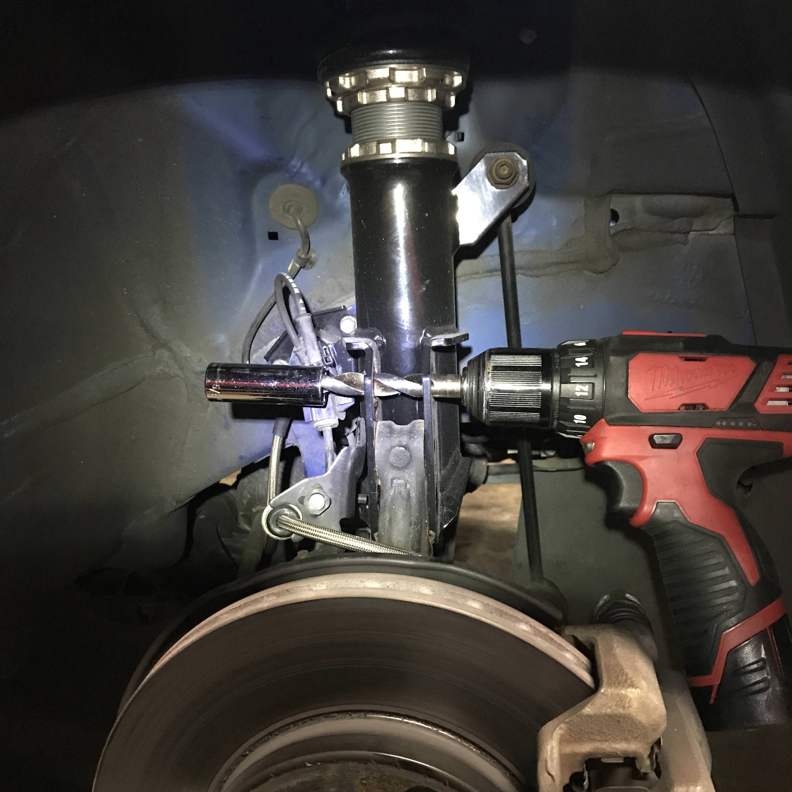

So, the way I see it these stupid screws are used only to hold the spindles onto the beam while it travels through the assembly process awaiting the drum brake baking plates to be installed. Once the 4 large bolts are installed and torqued its rendered useless. The spindles centered by a large alignment pin that interference fits into a hole in the beam. So, what I'm saying is these countersunk screw went in the trash and I am not replacing them.
Not having that screw makes it so much easier to loosen the 4 bolts and wiggle the spindle out just enough. So you can alter the rear alignment with shims or whatever trick you prefer without actually removing anything other than the wheels and drums!

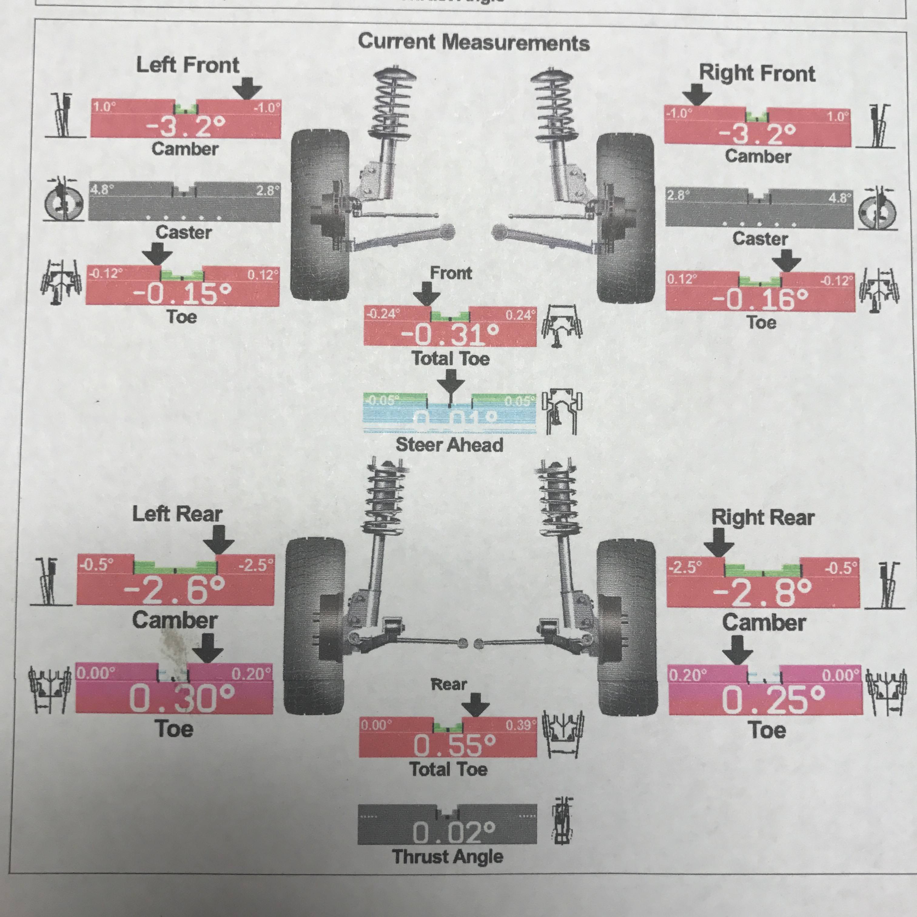

After this I removed the rear springs and moved the tires through the range of compression and rolled or removed any material that was in the way.
This was the finished product.
And current numbers are... ready for the track.

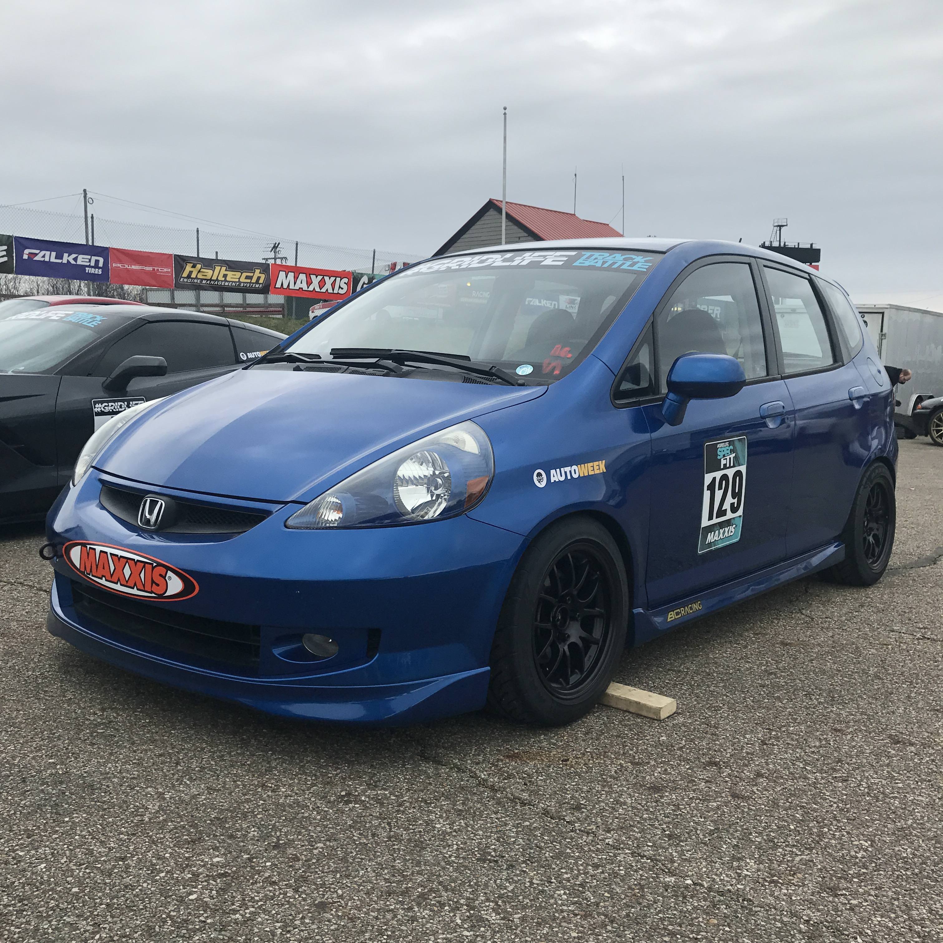

Got to the track, slapped on the provided decals, and made it through tech before night fell.

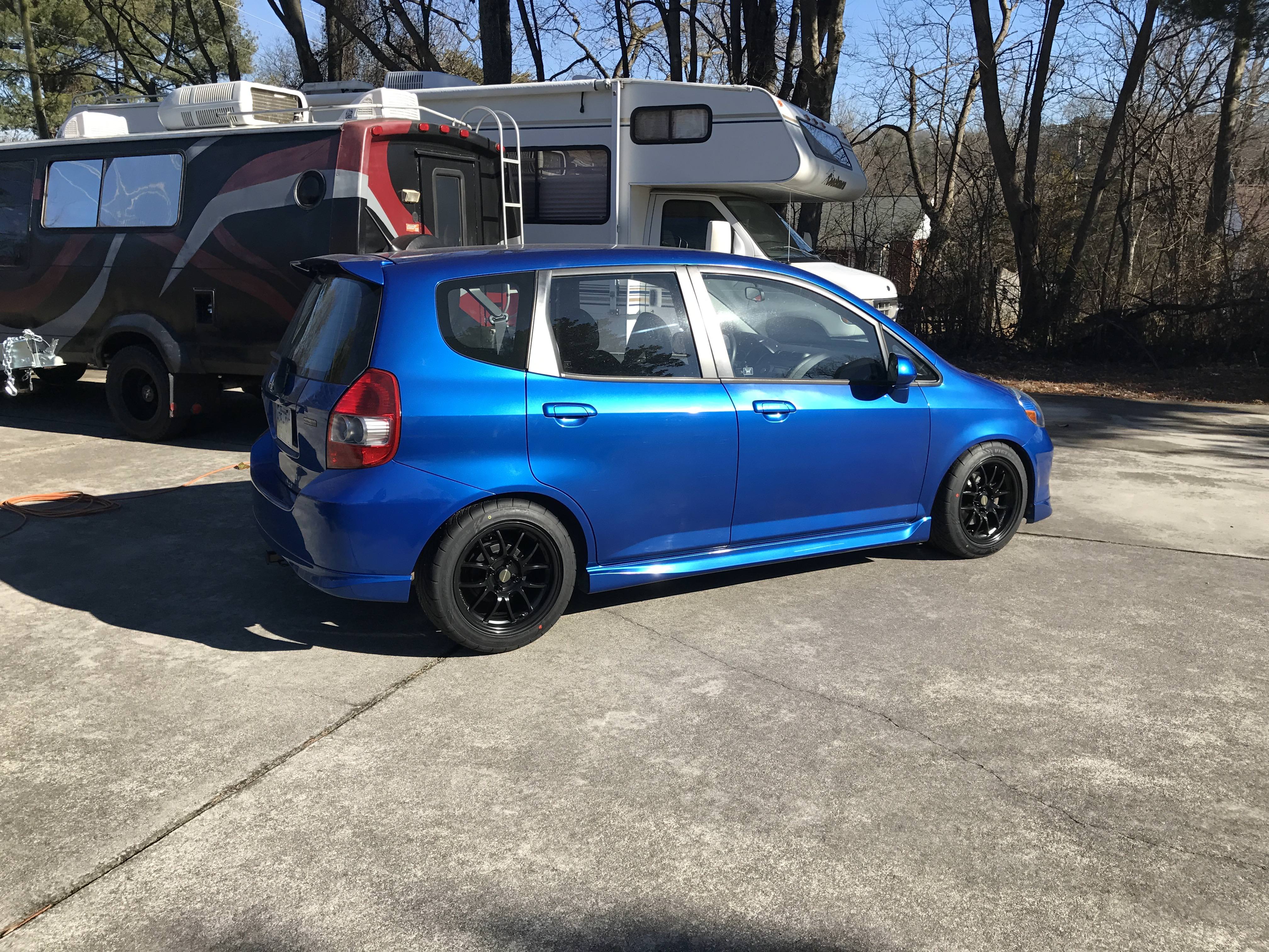

The next GridLife event is just a few weeks away.
And I have some work to do.

Question about your wheel fit struggles, 15x8 +36 isn't that wild a sizing for Fits, did you not roll the fenders?
I'm curious about this as well. I KNOW that the GD can sink in a lot of tire up front with very little modification aside from camber and a fender liner tuck. The rear needs a little more persuasion though.
Judging from picture the car is just too low but should have plenty camber to clear... I'm also curious about spring rate too.
