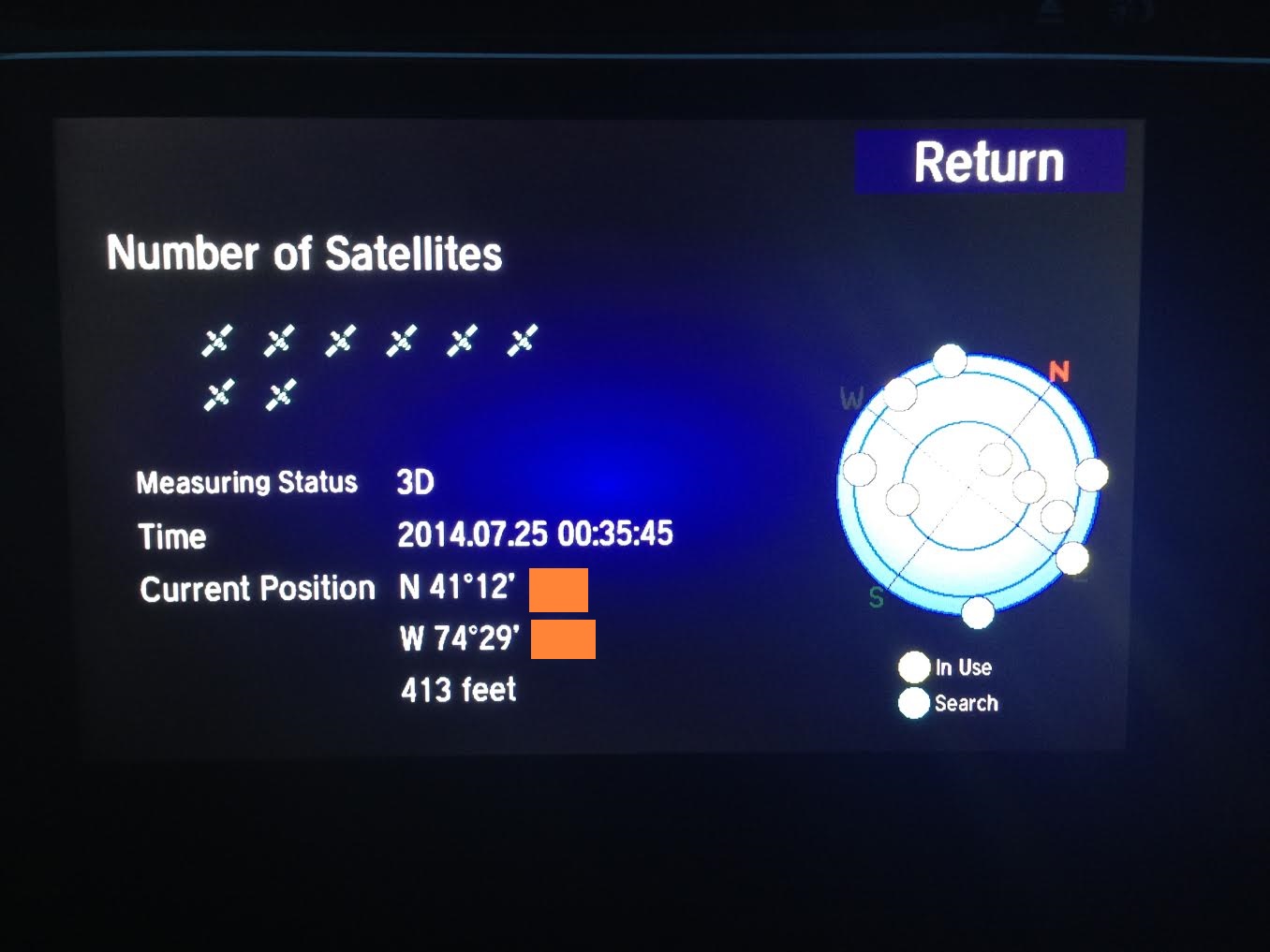

So I was poking around in diag mode on the Display Audio unit and found that my 6MT EX has a GPS receiver in it. I thought it might be taking the info from my phone so I turned my phone off but it continued updating. The component check also showed "OK" for a GPS antenna (but not for an XM receiver).
Sort of fascinating and probably not anything nefarious. What it probably means is the standard Display Audio units and the Navi units are identical other than software. This would make sense from a production standpoint as it simplifies things. Also considering GPS chipsets are plentiful and cheap now, it probably doesn't add much to the cost of the unit.
Having slight issues with the link to the photo. http://imgur.com/XljWxoK is the direct link
(exact location slightly obscured but it was accurate to within 5 feet)

To get in diag mode, turn the car on, be on any screen other than home and hold down power, eject and home at the same time until the screen comes on.
Standard disclaimers apply.
Oh and don't run the aim lanewatch function without having a proper target.
There's actually a bit more info on techinfo.honda.com (which you have to pay for). I don't want to run afoul of their TOS so I'm prohibited from sharing screenshots/diagrams from the site, but I don't think I can't answer questions.
It's a little more detailed than just swapping in an SD card from a Navi unit. The SD cards are married to a VIN and I think they require the HDS tool to perform the actual "marriage" even if you just got the card. It's possible that you could copy the software from a Navi SD card to your "normal" card although that could get dangerous.
From everything else I discovered either in diag or the docs on techinfo (the unit supports Mirrorlink, there's a WiFi direct antenna, there's VNC support), there's no doubt that Carplay and Android Auto should be available as soon as they release the software.
