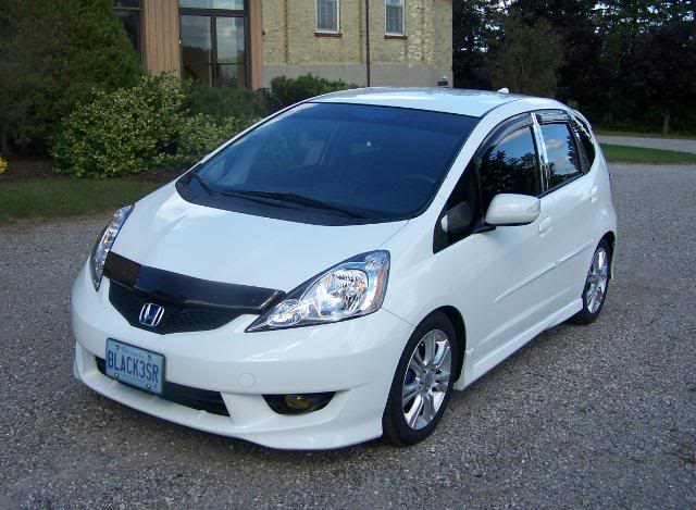

is there anyway to get one without the Form Fit logo on it?
i'd rather not have it on....

Mine is clean
