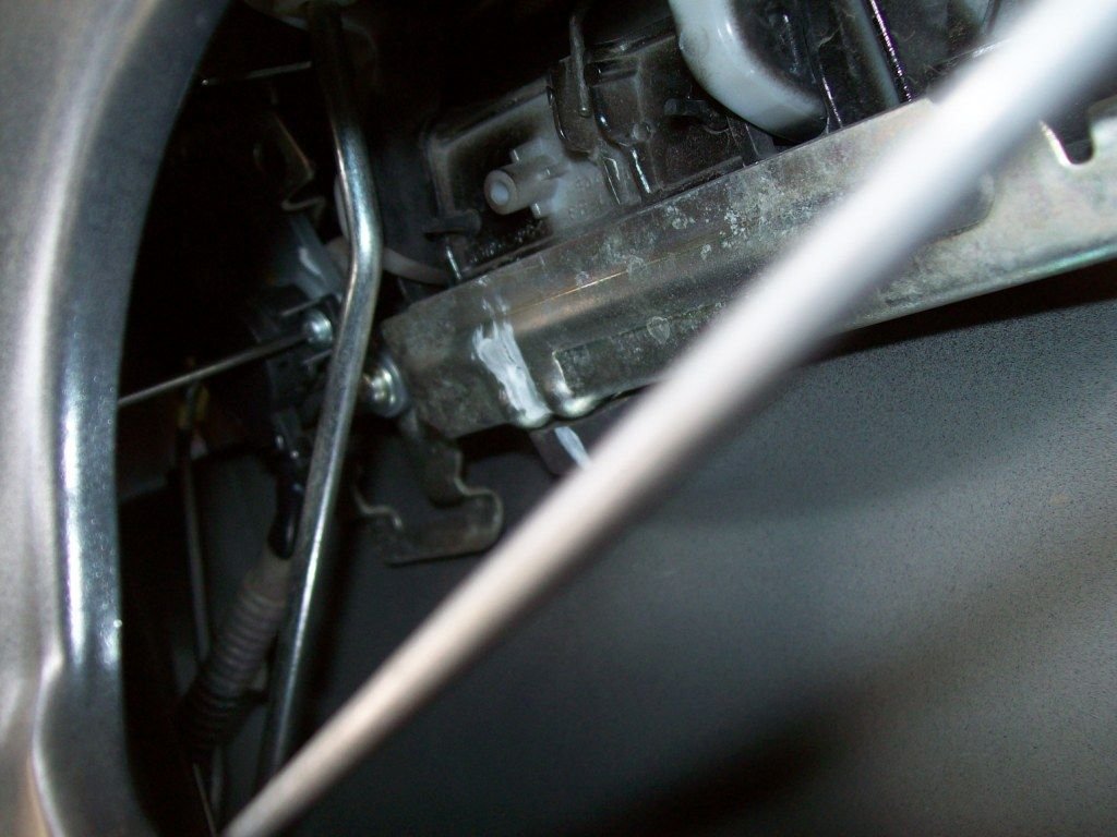

After removing pushpin, reach inside and pull the lock rod protector toward hinged side of the door
Inside of the door: glass run channel and door latch

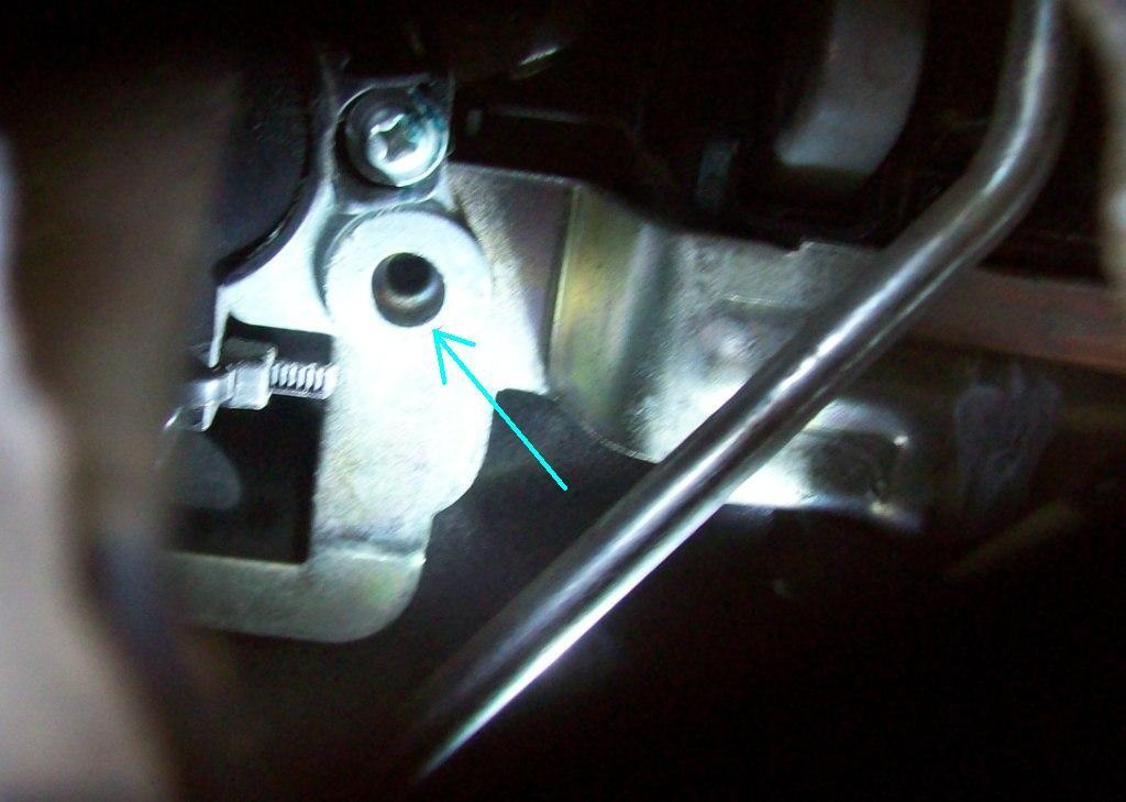

Missing screw? No!

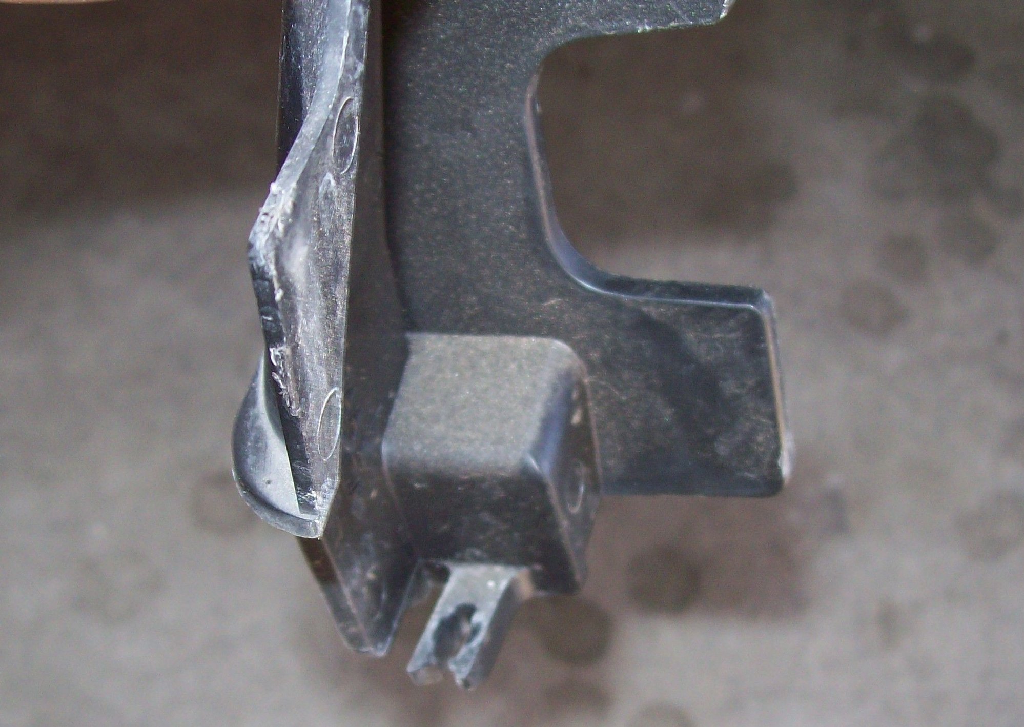

Removing key switch from the lock cylinder; sharp flat screwdriver with thin blade works better than Phillips one
