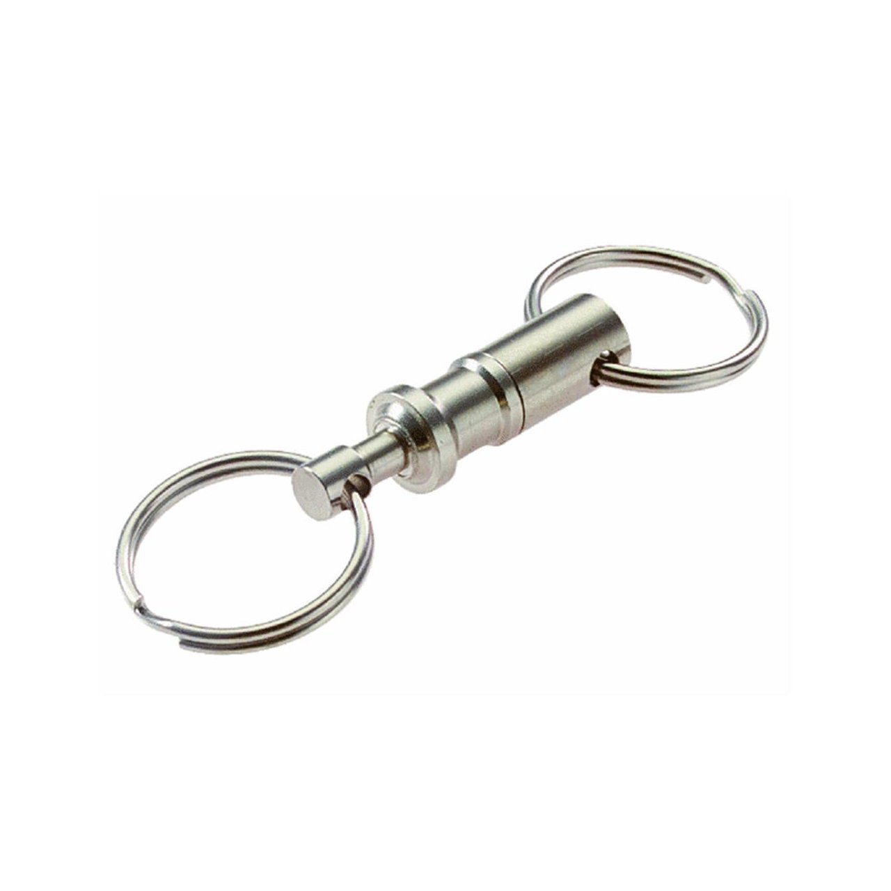

Also, prevent your keys and lock cylinders (especially ignition) from wearing out by reducing any other things that weigh the key ring down. (Other keys, flashlights, store card readers, etc) Use a key fob with a detachable section.
