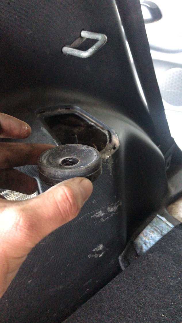

Did not pay much attention when removing my struts today also they were loose so not sure if they were installed properly in the first place. But if you look at my photos here which way is the bushing supposed to go. Skinnier part facing up or facing down? I had skinnier side down for top and bottom bushing is this correct?
Skinnier part up?
Skinnier part down?

If you hadnt figured it out by now...that kinda sucks no one gave you answer - the wide part goes down or faces the sheet metal of the car - so on the bottom bushing, the wide part would face up.

Dish is facing down on the shock; cone is facing up

Conflicting theories here...

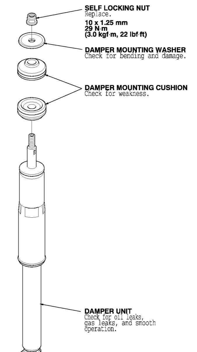

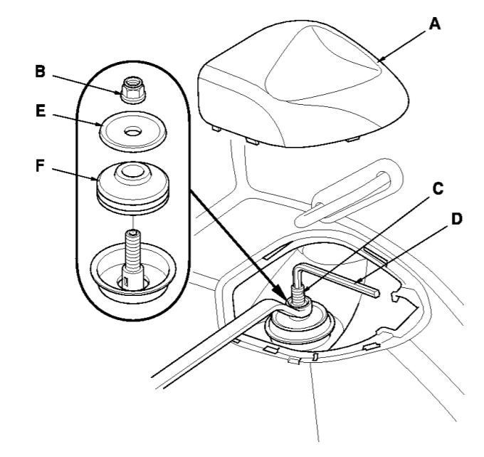

Old Aug 26, 2019 | 09:02 AM
evilchargerfan's Avatar
Joined: Apr 2018
Posts: 2,615
From: san diego
Old Aug 26, 2019 | 09:21 AM
driftskeetka24e's Avatar
Joined: Jul 2019
Posts: 9
From: Peebinga, South Australia

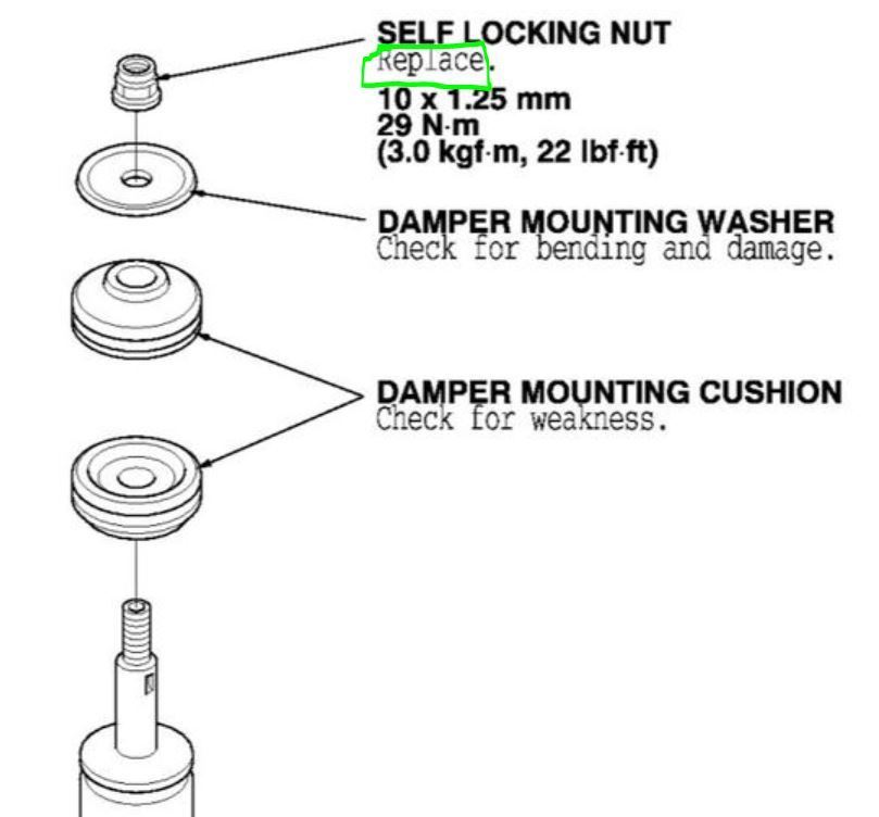

This is what logically I thought it would go but it came off differently so had my 2nd guessing. Thank you very much for that! Next question will it be okay to re-use the self locking nut?
Last edited by driftskeetka24e; Aug 26, 2019 at 09:22 AM. Reason: added a question
Old Aug 26, 2019 | 12:00 PM
Joined: Apr 2018
Posts: 2,615
From: san diego
u can re use, it is recommended to replace
