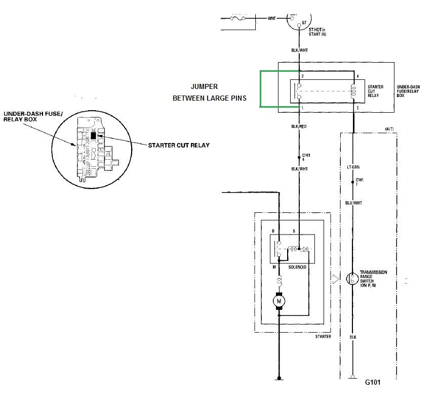

Are you majoring in philosophy ?
All you need to do to rule the NSW out is to bypass a starter relay with a suitable jumper
If starter works consistently after this, try different relay and/or troubleshoot the neutral starting switch circuit (easier to say than done).
