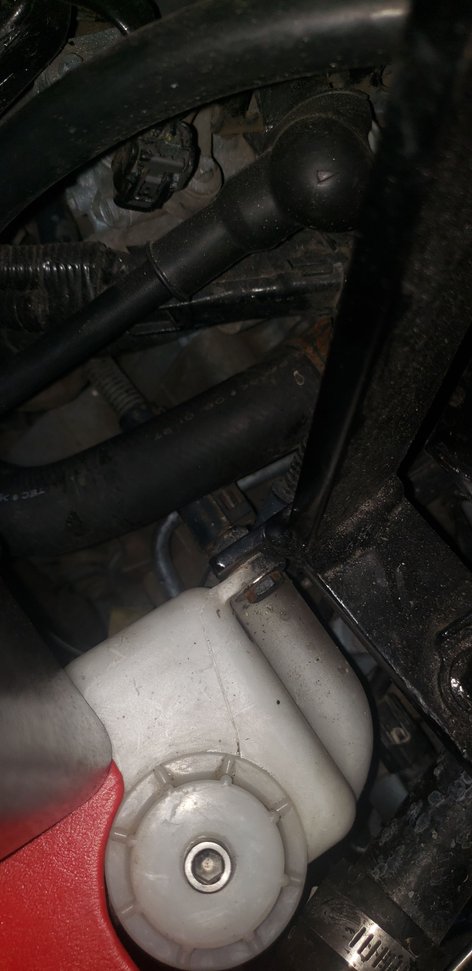

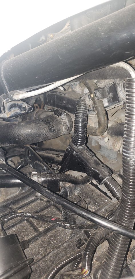

1st pic
2nd pic
Doctor J here's 2 pics. 1st one shows the hose coming from top of radiator to engine.
2nd pic shows hose from engine to the bottom of radiator

1.1 bar is the correct pressure.
Please check your hose hookup using thread below
https://www.fitfreak.net/forums/1st-...ation-gd3.html

Doctor J, thank you for your help. That diagram helped me understand the flow of coolant and I took the thermostat out and tested it. I bought a new one also and this time from Napa. Both were same brand but looked different. The old one from Autozone still worked in boiling water but I think the design didn't open as quickly as the one from Napa. I changed it out and now the coolant flows with no issues. Now it takes alot longer to warm up during idle. Once I get my exhaust done this week I will be able to test drive better and get the coolant to circulate and heat up better thru flow.
