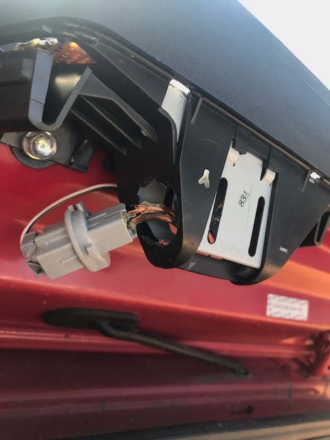

My 2008 Honda Fit 'failed' inspection last week because of my 3rd brake light. (I know the mechanic and I promised to fix it right away so he let it pass)
Looking online, it seems like it should be a simple bulb change, but my car is different, it has 6 little bulbs? (one is out)
Is this some sort of stupid aftermarket light? Has anyone seen this before? Any easy way to fix one bulb or do I need to buy a whole new mount?

That definitely is not stock, and that single led likely isn't easily replaceable. Best bet would be to revert to stock.

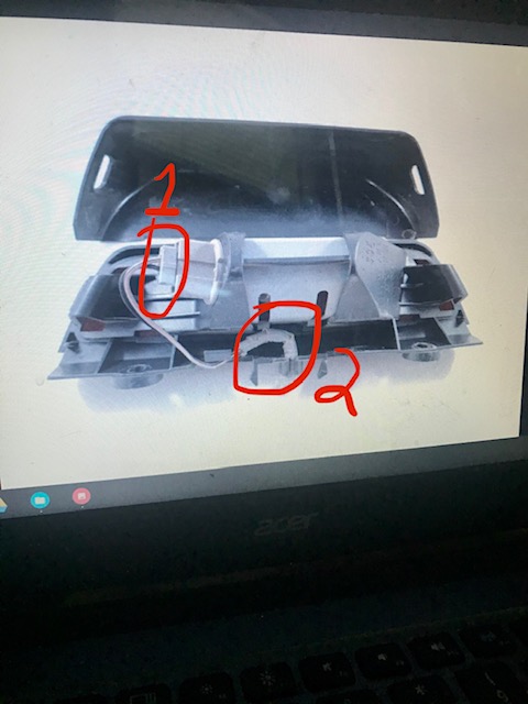

This what I need right?:
https://www.ebay.com/itm/Honda-Fit-H...8AAOSwqUdcv5Kb
See pic:
https://i.ibb.co/2dcRrZT/IMG-4196.jpg
Does the part I labeled "1" fit right into the new mount/holder that holds the bulb?
If not, how hard is the part I labeled "2" to wire in?
(Im horrible at electrical stuff/soldering/etc.)
Thanks again!

Sorry, meant to reply sooner. That should be what you need but you might try finding one with the harness still attached or at least a bit more wire to work with,

I think that linked ebay item is what you need. The connector I labeled 1 below looks to be the same one that you labeled 1. I think you can just unplug your existing brake light at 1, and plug that into the oem part.
Oh i hope, that would be awesome. Thanks you two!!!!
