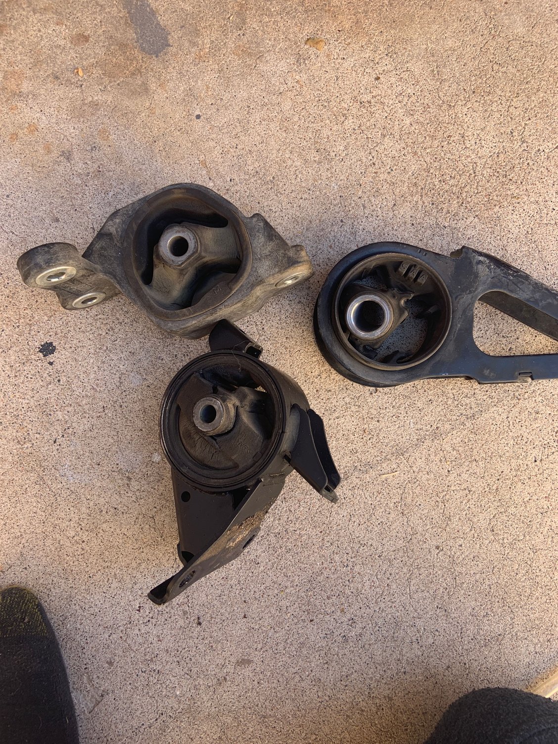

But these motor mounts are no joke. There are four motor mounts, One on the engine side, two on the trans side, and one connecting the subframe to the trans. I've had to replace three of the four, and this is what they looked like. The two that hold the transmission right under the battery were no issue at all to change.
HOWEVER! The one that connects to the subframe was an absolute pain that I do not wish on my worst enemy. I do not have a lift, so I had to lay on my back for a good long while figuring this one out. To get the metal plate onto the mount, I had to loosen all the subframe bolts, which lowered the subframe enough to allow me to push the motor away and fit the little bugger in. From there, you raise the subframe back up and use a jack to hold the motor and trans in place (not at the natural resting position) while you gain new scratches and all that twisting your arm between the subframe, exhaust, trans, and new mount. Pray you line it up fast, but expect to line it up in a few hours. One bolt is all you need, but I encourage you to put all three back.
Here are the photos of my dead mounts. The two side mounts were absolutely dead, just basically placeholders. The rear subframe mount wasn't actually bad, but, as I said, I was doing the clutch, so I figured I mine as well.
That black piece will be the bane of my existence. That is the part that connects to the subframe and the transmission itself.
Top one is the subframe to trans. Right is the one in the drivers fender well. and the bottom one is the one right under the battery tray.
