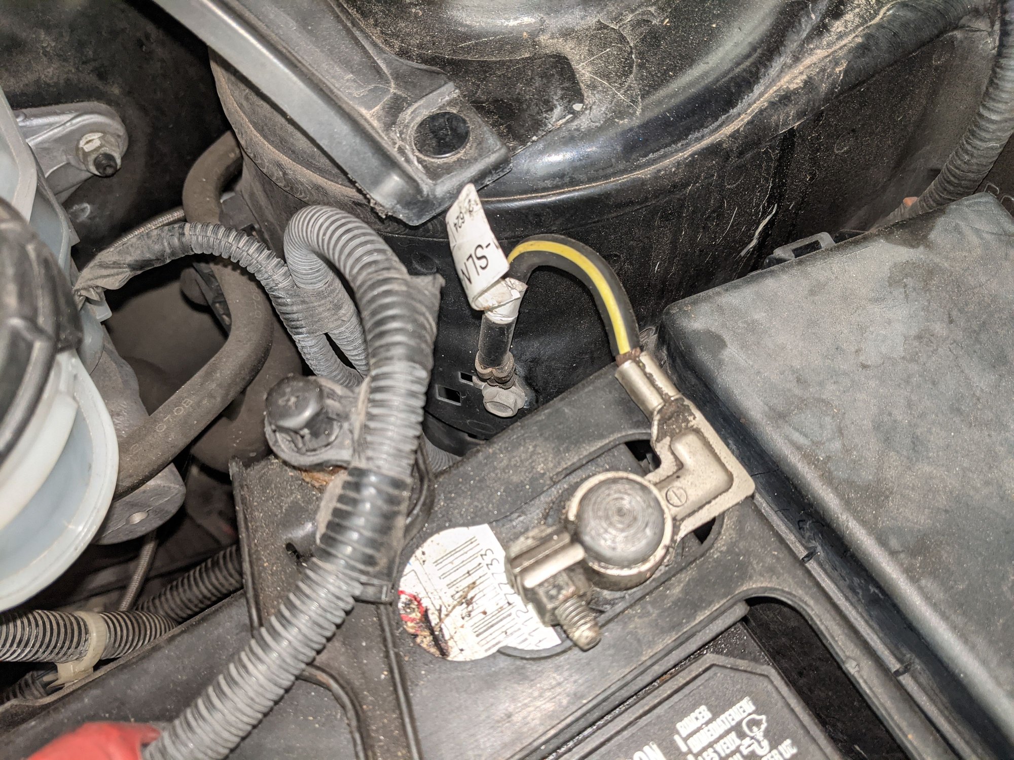

I checked both the under-the-hood and interior fuse boxes and all of the listed fuses for these features are intact but that is the limit of my diagnostic attempts. The one item that I have found that raises a question is a metal ring /ground on the negative cable for the battery (see images). Other than that, I can find nothing physically out of order. Let me also state that this vehicle had NO previous issues with ANY of these systems until all of this happened at once.

Pretty suspicious looking ground - someone's been there before. Here's what it's supposed to look like. I'd take that apart and make sure everything is clean and free of corrosion.

That doesn't look like the original OEM ground cable, to be sure...I've got an OEM replacement ordered. Meanwhile, the grounding effect seems to be working for ignition and basic performance...but the problem persists. Thx, BTW for the comparison pic...running the VIN shows this to be a salvage title, so I'm betting that someone cobbled together the ground cable from another vehicle, perhaps.

UPDATE: Replaced the 2-gauge OEM cable with a 4-gauge Duralast battery cable (complete with a new top-post mount, added two flat washers at the ground point to guarantee connectivity, and replaced a 10A blade fuse that had burned out in the engine fuse compartment (number "8" position in the diagrams, BTW) and not only have all systems been restored, but startup is great and multimeter shows me steady at 13.70, whether running or at rest. THANK YOU for your help, everyone...I am glad that I found this forum as I normally own domestics (Buicks, GMC, etc) so it's really helpful to know that we have a community here. Thanks again, and good luck to all!
