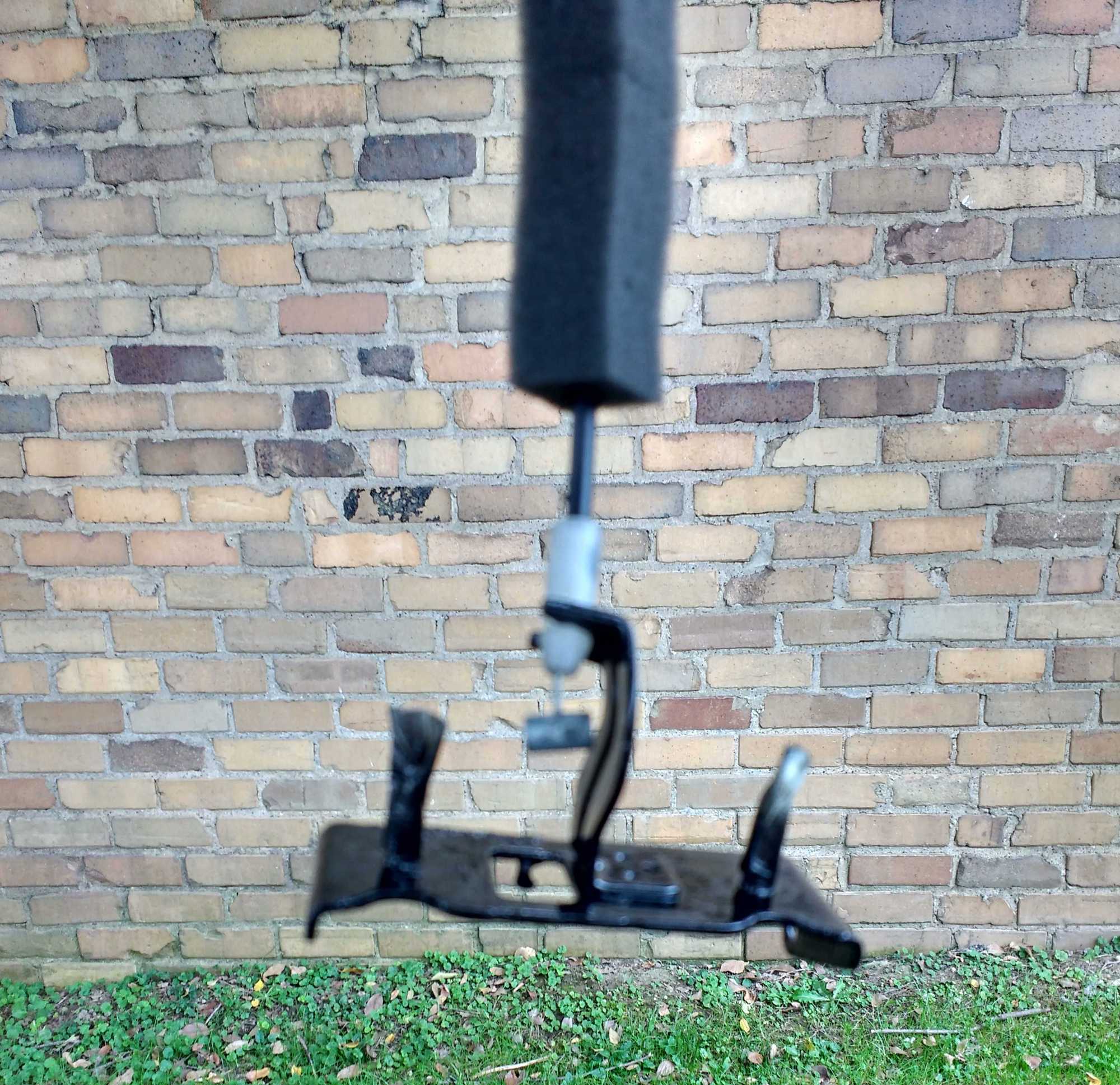

I've been busy the past two weeks. Last week I replaced the passenger side CV axle and passenger side inner + outer tie rod. Did the oil seal while I was doing the axle and no longer leaking gear oil.
9 more pounds removed from the rear end.
Freshly painted hatch release (please excuse the focus).
