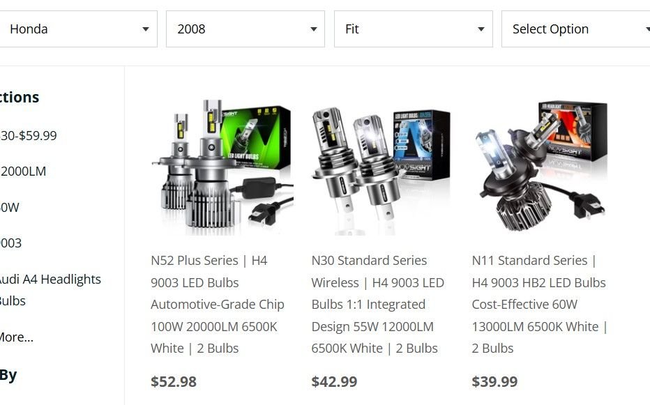

I've spent countless hours researching and trying out various LED headlights on my wife's 2008 Honda Fit. I've tried a couple of 9003/H4 LED headlights, including the Philips Ultanon and Sealight, and while both were great in low beam and high beam function, neither was compatible to have the DRL continue to work (which uses the high beam at a lower voltage). Most LEDs aren't capable of functioning with a lower voltage. However, I just came across a great product that has solved this problem! So I want to share this with others who have run into this similar problem. Here are the two products you'll need:
https://www.hidvisioncanada.ca/led-k...light-kit-new/
https://www.hidvisioncanada.ca/led-k...gler-2pcs-new/
Customer service was outstanding and so far I'm really impressed with the product.

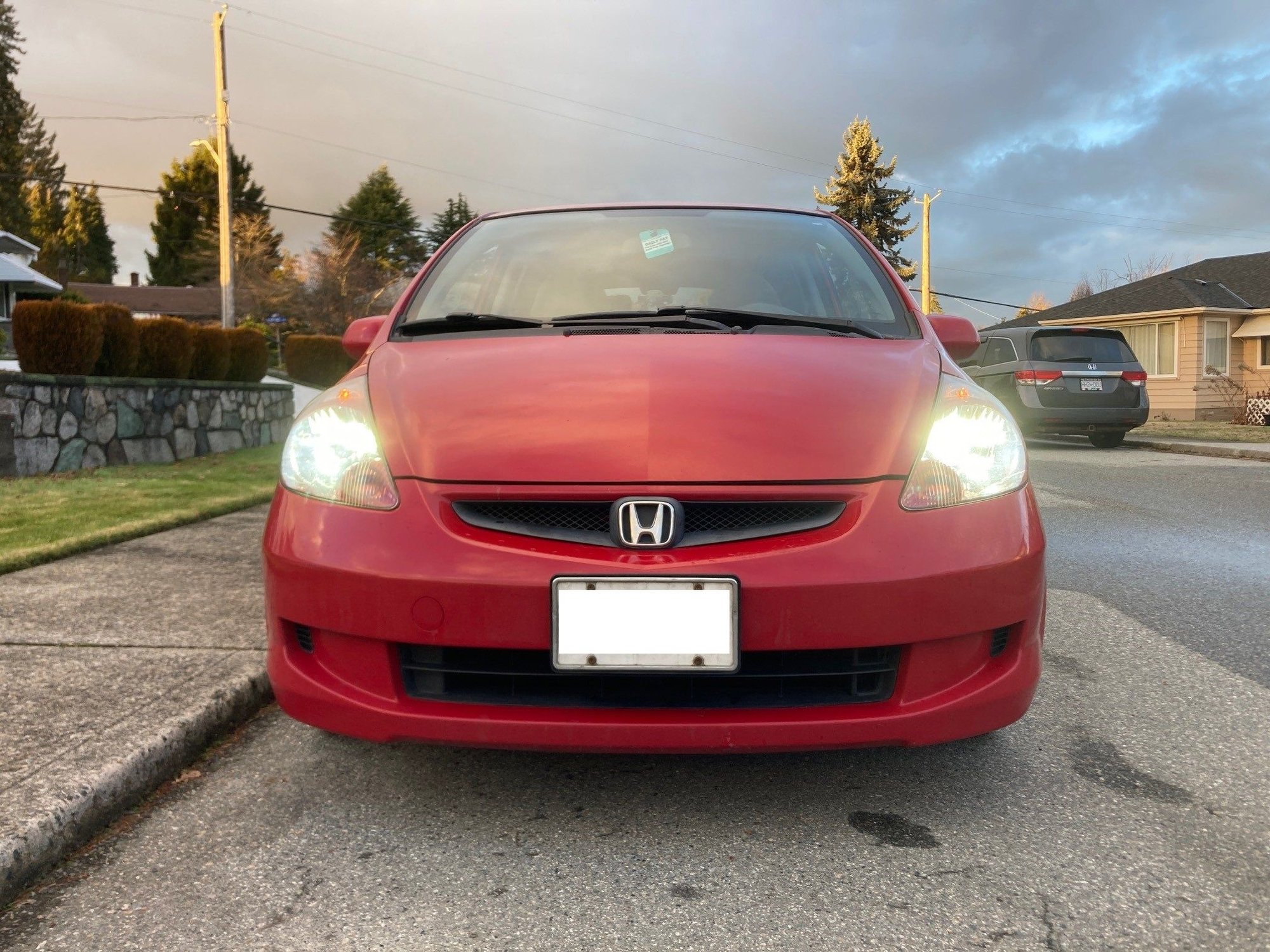

And here are some pictures for your reference, including high beam, low beam, and DRL...

Hey 03CRV-YYC,
When posted this right after installation and they worked great. However, within a week of use, they started to flicker pretty badly. They flickered a little fairly constantly, and then whenever the fan kicked on and off the headlights would flash very intensely. I was really optimistic after all of my searching, and initially, they seemed perfect. However, even with the decoders they continued to flash. I returned them and went back to halogens. I would no longer recommend this option.

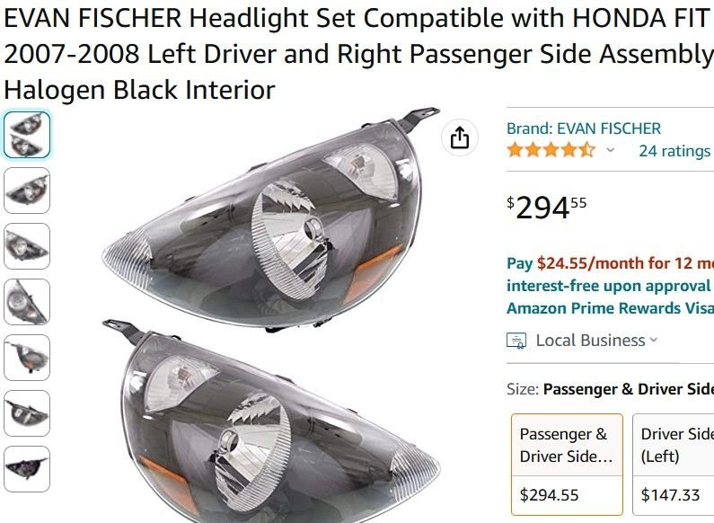

Headlight upgrades 2008 Fit
I have again severely fogged lamps and really need better lighting. Had them sanded, polished 2 1/2 years ago for $55 and no surprise, car is out in California sun all the time, they need a solution again.
Are you saying that these LEDs have a built in DRL function? My 2008 (American) has no automatic DRL.
1. I am considering refinishing lenses again and replacing the bulbs with Halogens. Which do you recommend?
or
2. Purchasing replacement housings with halogens such as the Evan Fischer
Another thread mentioned LDE Novasight. Given the puny battery, and the additional heat from the LED bulbs, will this cause a problem?
