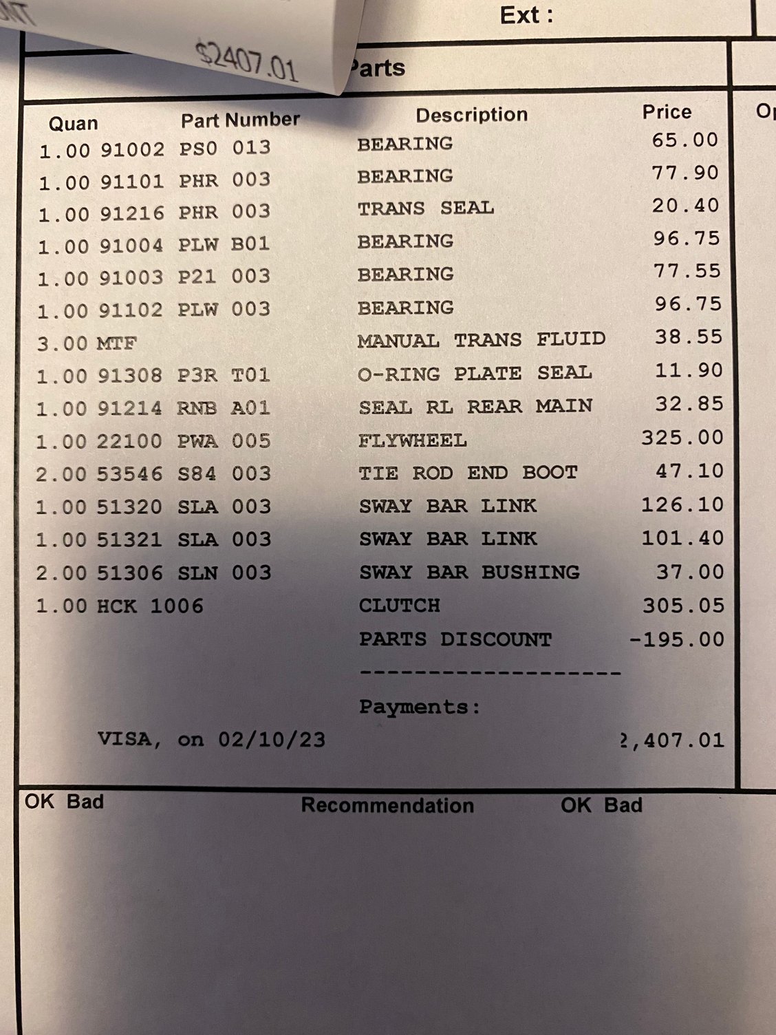

I would of definitely took the car apart myself if I had the time and space to work on it, but unfortunately I work all day everyday.
So I got my car back. Not sure if I was ever asked to do the rear main seal nor the sway bar links. The car handled perfectly before I even brought it in.
All in all pretty disappointed as this shop had great reviews being a Honda specialist. I had plans on bringing my other Hondas in before all this.
The noise is gone, so I guess problem solved. I’m hoping the rebuild will hold up for a long time.

Yikes those bearing prices
But at least it's fixed. Did they tell/show you what it was? We need to know!
It'll probably last long enough not to matter, but I'm curious what the root cause is. As @mifesto said, it's a pretty common issue so it has to be either defective bearings or poor lubrication design or something like that.
The rear seal makes sense to do during a clutch job, but they should've asked you if you wanted the the sway bar links. Maybe they damaged them somehow, though there's no need to touch them.

So the front office just told me it was the input shaft bearing and it’s “fixed”.
I didn’t even think they’d do some extra work without telling me.
Main seal I can understand. But the links I could of done it myself.
They only told me all the bearings, clutch, and flywheel for the fixed price of 2.4k a week before I green lit the work. So I’m sure they already had plans to do the links. Come to think of it, the $400 discount they gave me probably were other unnecessary work they just took off the list.
Man when I finally saw that paperwork after I paid for everything I was too disappointed to even argue. I’m guessing all the clients with the 5 star reviews are just oblivious customers who has no clue what they fixed and are happy it’s a little cheaper than the dealer.
Definitely not going back there.
Anyways the car seems to be running fine, maybe a slight whining noise in gear, and a little rattle at 5k rpm which I think is nominal.
