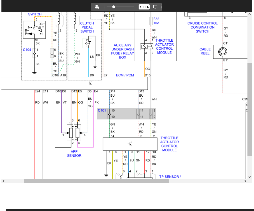

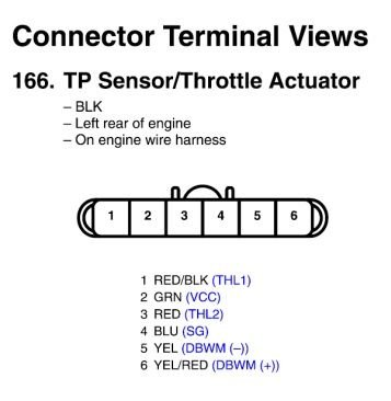

So I was a dumbass and when I was changing our my heater core I pulled the wiring out of the connector. Was hoping someone might have an image or a diagram I could steal so that I can actually drive the car I spent the past two days fixing. Any help would be greatly appreciated. this is not the order or if it is the connector is bunked. but also they use these weird colors that don't seem to even match up with other Hondas. this generation has some weird wiring in my experiences. hopefully someone out there is feeling like a chad and can snap my a pic. its literally jsut the throttle connector cable. and if i borked the connector i can order a new on and borrow a car of a friend. again any help is greatly appreciated.also a look at the way the stock connector fits will help with wiring a new one.

i found this and the colours match including the still connected orange wire. thank you for your attempt tho but ultimatley i had to pull my wallet
