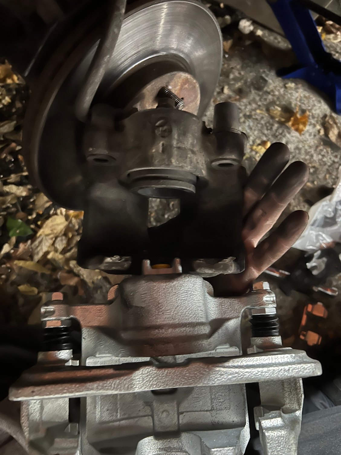

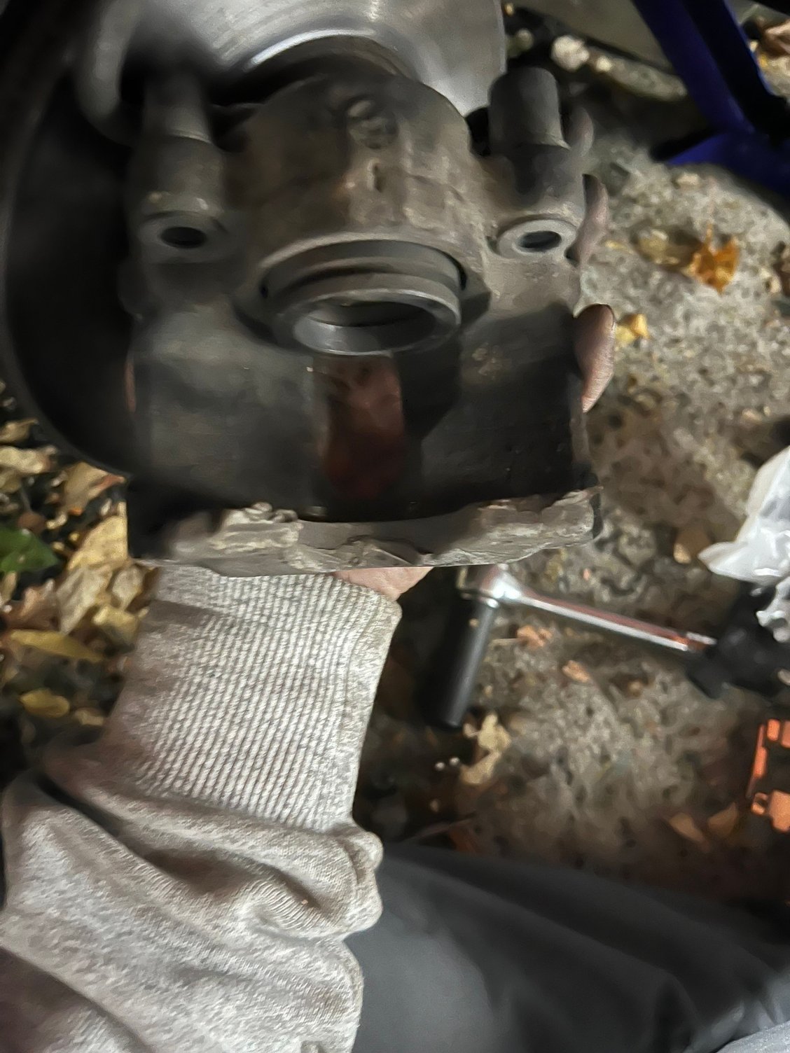

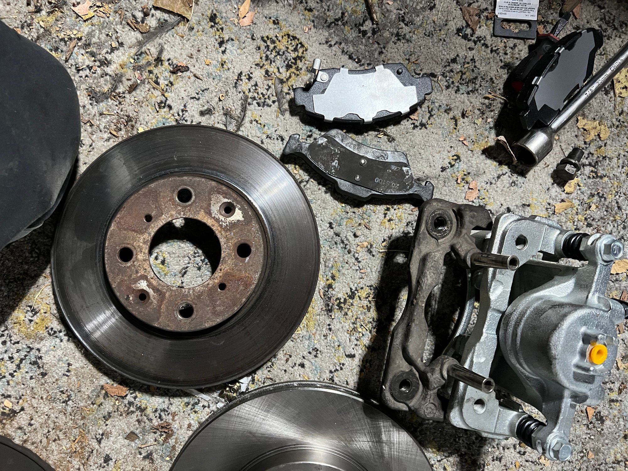

ok three attempts to do the brake job later and coming up with wrong caliper hardware every single time.. the holes line up but the caliper mounting brackets are too thick to slide between the rotor and the bolt holes… I cannot find the caliper for this car unless I go on Mercado libre and they won’t ship to the USA.

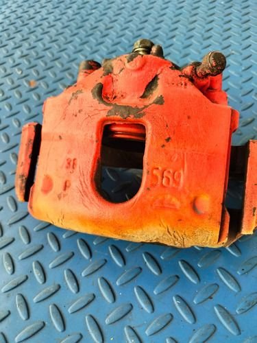

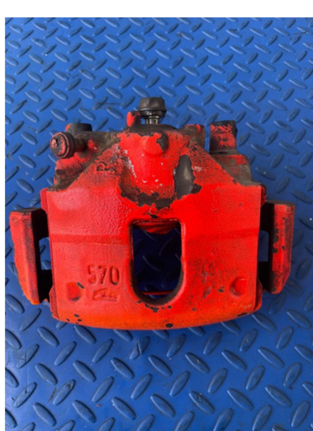

Can anyone please help me ID the Honda part number for this or a caliper that may bolt on in lieu of it? They are not NISSIM parts they’re only stamped I/S 569 and I/S 570.
the bolt holes are spaced and threaded correctly on all options I tried.
the bracket is too thick on all options I tried which are:

read several guides on using a civic or integra caliper and caliper bracket but those mounting brackets are all also too thick to slide between the rotor and mounting holes.
i have the teeeeeny tiny rotor 231mm or something like that. Everything sold for the 2007 fit in the United States or Mexico “would” bolt directly on, including the larger rotor etc - but none of the caliper mounts will fit behind the bolt holes to where I can actually mount them.
I would gladly replace the whole front brake assembly - pads , rotors, calipers etc if anyone knows of a type that’s thin enough to slide in there and bolt on.

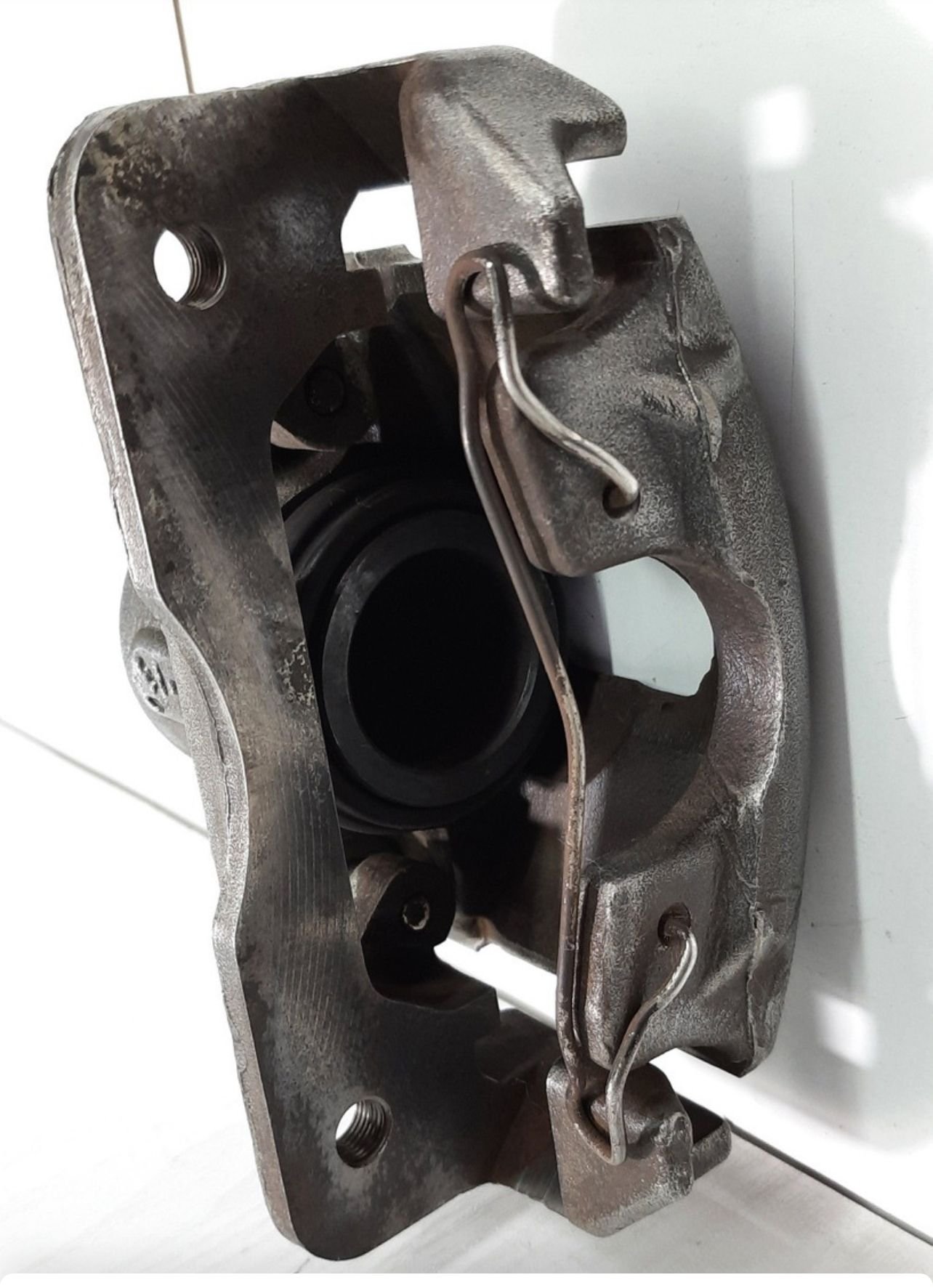

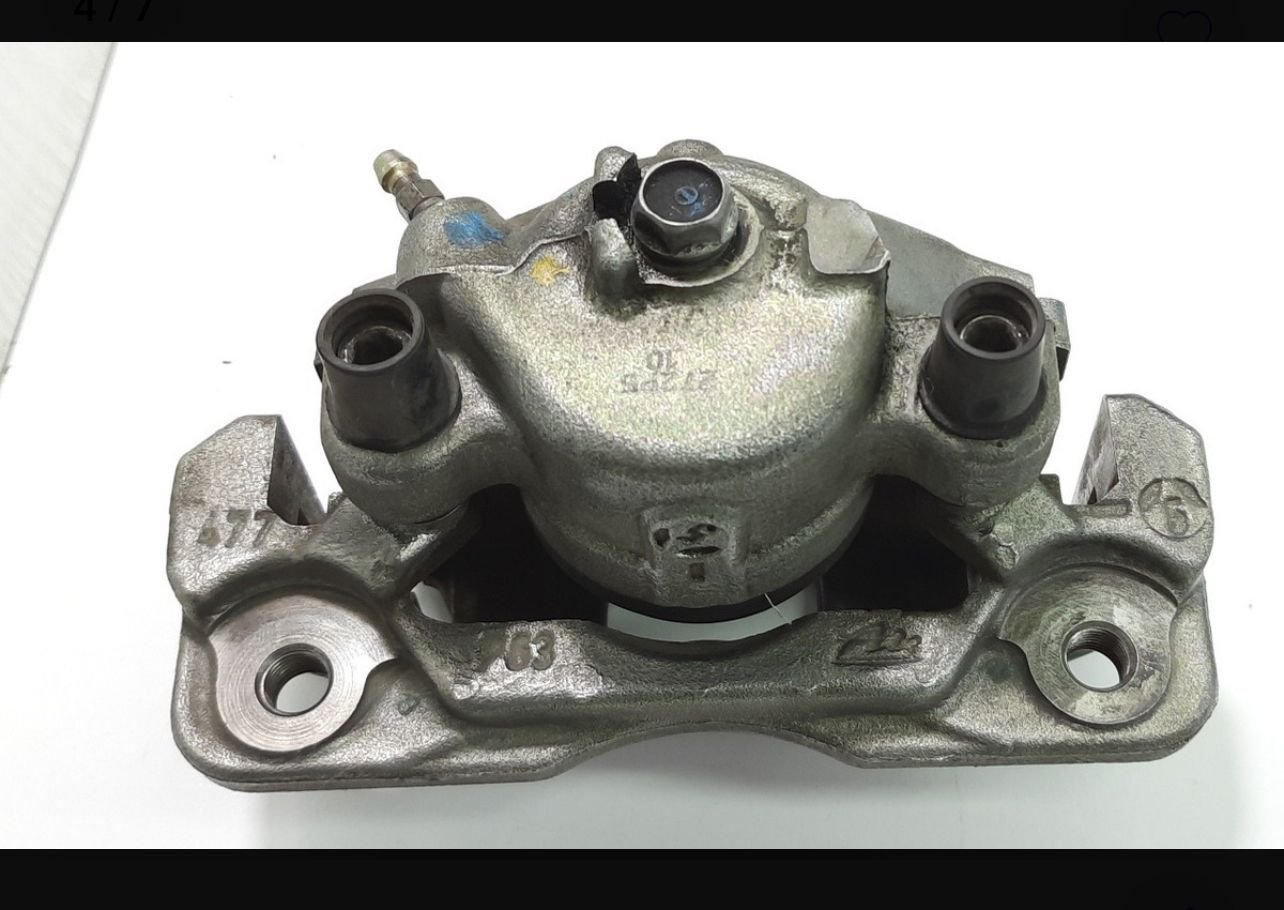

Correct caliper , only labeled/stamped 570
Correct caliper only labeled/stanped 570

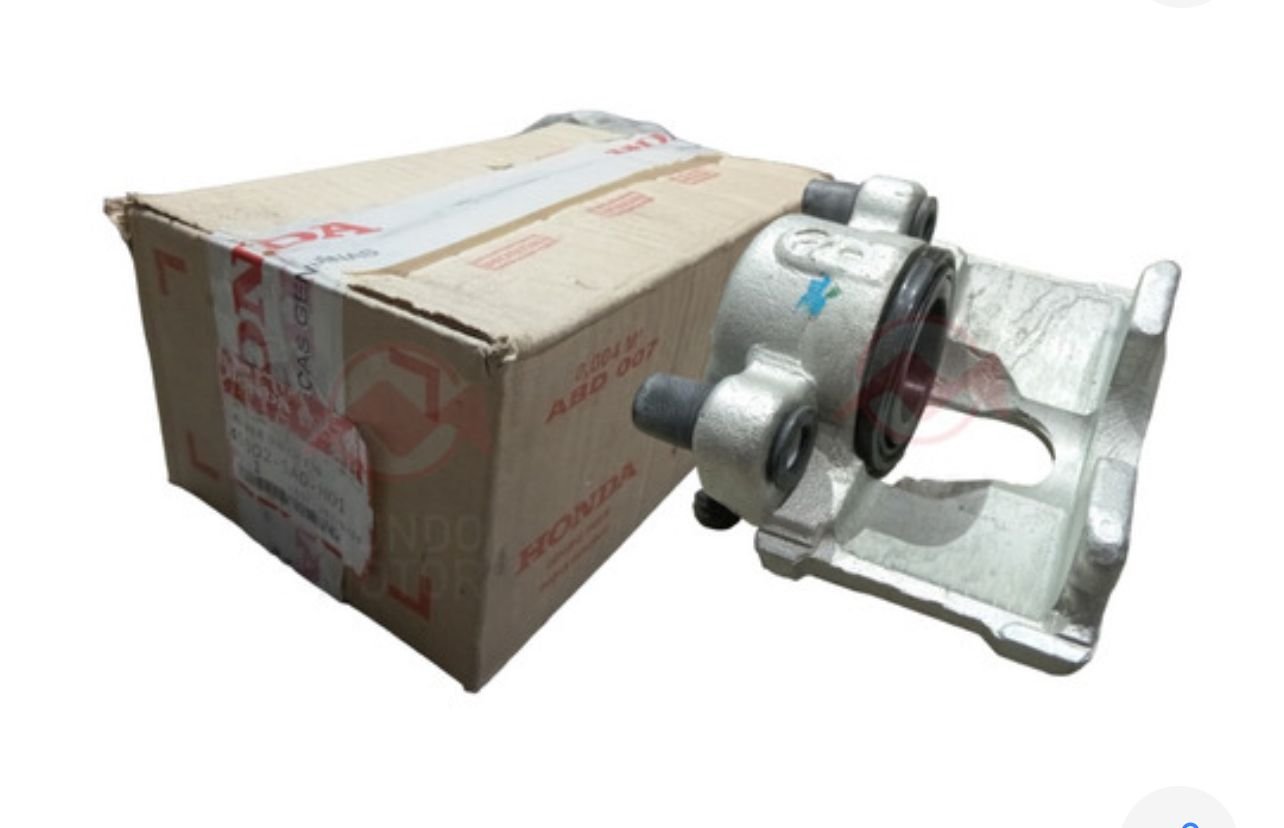

Example of correct caliper

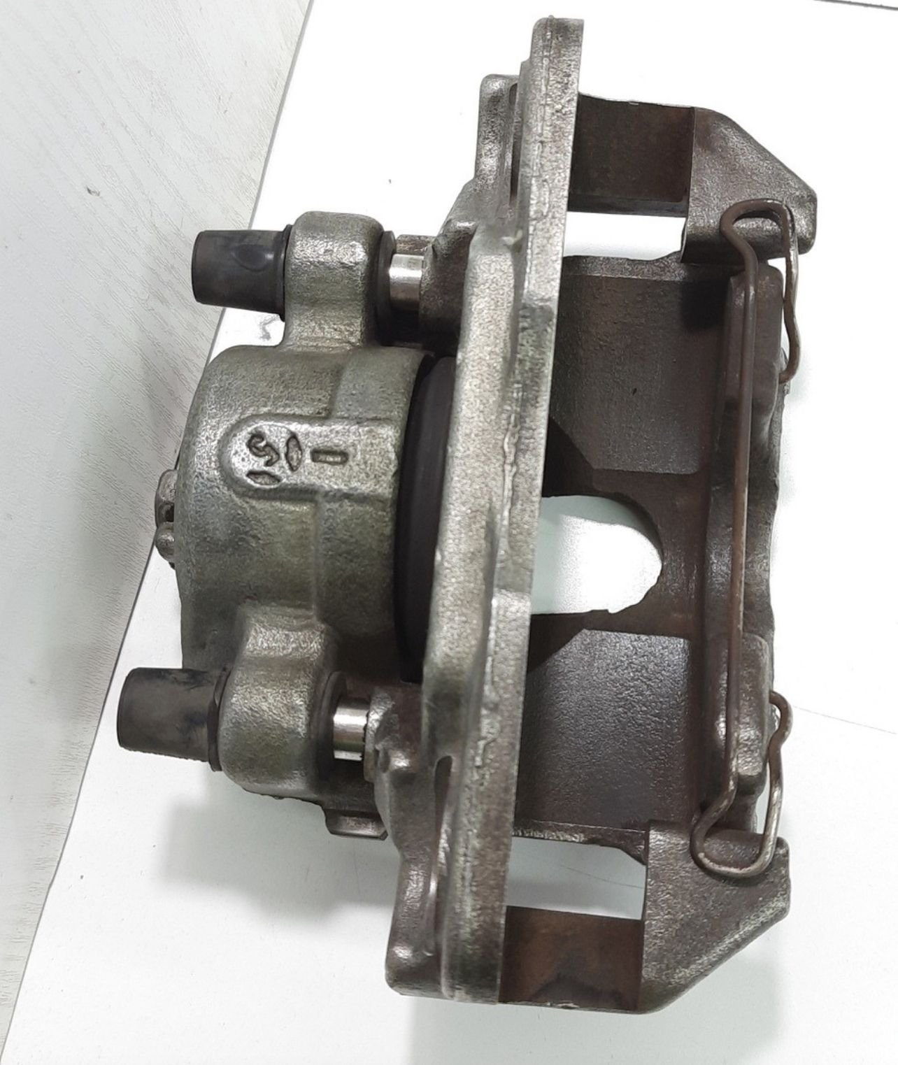

Comparing my fit’s caliper to the rest of the world
My caliper , drivers side

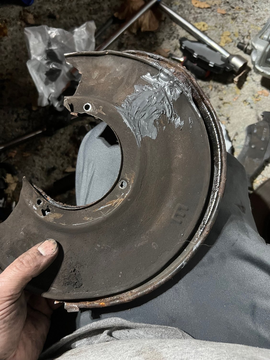

Brazil backing plate vs USA backing plate
Brazil rotor and caliper versus USA rotor and caliper

I got a little closer and identified the oem caliper and pads:
Driver side caliper Honda oem PN: 45002-SAD-M01
it says this is compatible with a 2003-2008 Honda fit 1.4L , (although that’s not my engine.)
cannot find it anywhere but Brazil.
Bosch pads BB501

the Brazilian/mexican/LATAM FIT with a vin beginning in “9” probably has
- 240mm rotors
- “ATE” calipers stamped with “569” (left) and “570” (right).
- Bosch brake pads type BB03 for 2003-2008 1.4 fit (even if that’s not your car or you have an L15A).
the calipers and pads for a 2000 Honda civic CX are a direct bolt on
the caliper is the same for CX/DX/EX. However you will want the “CX” pads if you have a 240mm rotor so that the pads match the edge of the rotor perfectly.
