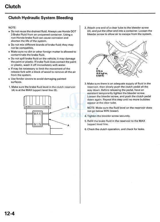

This is from the GE8 service manual, but should be very similar for your 2008. It's exactly the procedure I used to use on my Yaris.
I have no idea why your clutch pedal isn't returning. Does it stay up once your pull it back into position? Did you lose all the fluid when you removed/broke the bleeder screw?
Pedal stays up and very little fluid came out when swapping screws
