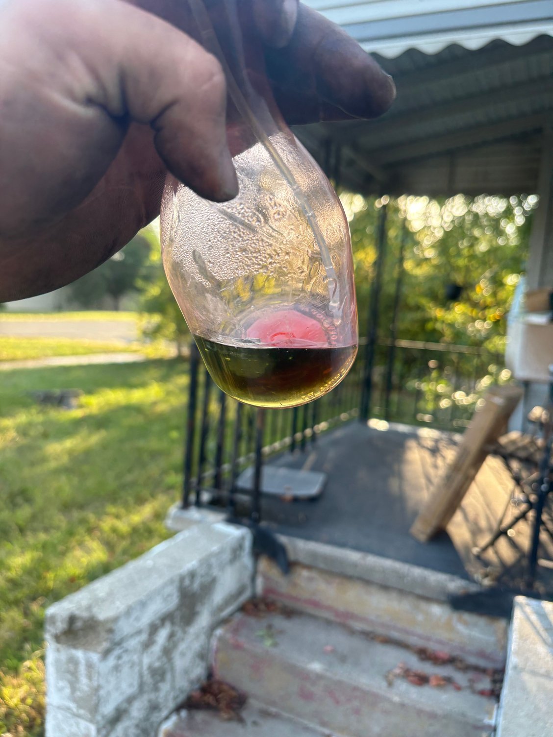

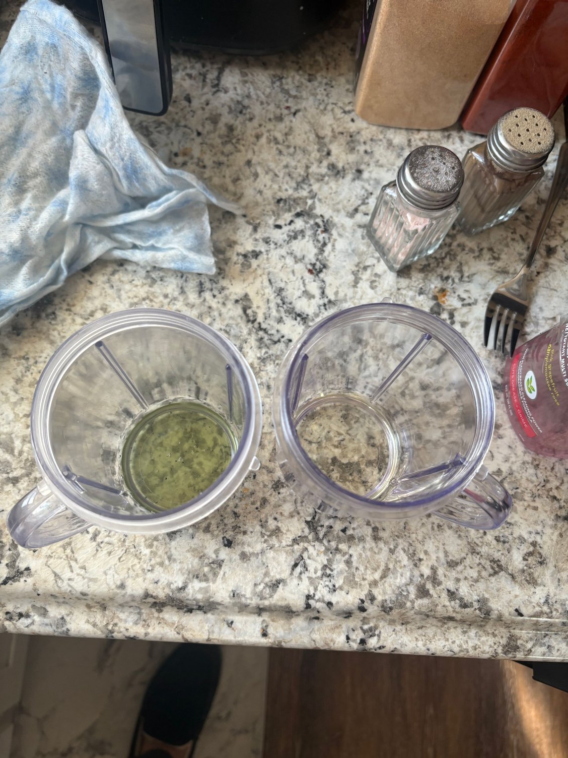

I have a fit I’m trying to fix squishy brakes on a 2008 fit. I replaced the front calipers and all brake pads and shoes, and machined the rotors. I checked the fluid and it was this dark green so I did a fluid flush. But then a couple weeks later the fluid was green again so I flushed it again. 3-4 flushes later it keeps getting contaminated and turning green. Any ideas on how this can happen? My thought would be a corroded brake line somewhere? But I don’t seem to be loosing fluid

I was going to suggest the front calipers (I have seen horrible pitting and internal corrosion behind the piston when the fluid isn't changed), but you removed that possibility by changing them.
I'm doubtful that you could have brake lines so badly corroded that they continue to discolor the fluid but don't leak.
Do the brakes work correctly (not squishy) now? Does the fluid level stay consistent in the reservoir after you fill? I have also seen some very dirty brake fluid reservoirs. How does yours look?
