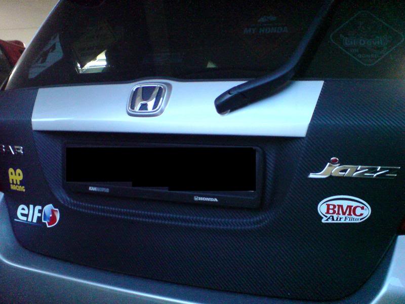

now you see the bolt,
remove it with 10mm shock
then just remove your wiper n
you should see like this
now we remove the parts that are
attached the black plastic cover
then remove this 2 pins
then after you pull of the black cover
you should see your wiper motor,
remove the three bolt n
the wire cable holding the wiper
motor on your car
now we already remove the motor
there's 4 bolt holding this cover
now this is what you should see,
there should be a plastic pin on the red arrow,
mine don't have because mine is
already being break off...
See the white gear, got 2 holes,
1 is which the arm rest in,
the other got a plastic knob,
break it off & take it out
then put e metal arm
below where u break e plastic knob ...
then remove the metal bar
and move the small metal
which i pointed with arrow
from left to right
you should get this result
& now we put back the metal bar
after that install back everything
you nozzle spray
that is n hose inside just pull out e hose then u can c n nut
( e nut is inside hose ) but u must add n rubber spacer
bcos u need e high so e sprinkler can work well ^_^
:: hv fun ::

Old Apr 12, 2009 | 11:50 AM
Ciggy's Avatar
Posts: 1,867
From: New Jersey
What does this accomplish?
Old Apr 12, 2009 | 11:55 AM
grtpumpkin's Avatar
Posts: 1,616
From: inwood WV
Your rear wiper will nest/start from the vertical position rather than horizontal. Its JDM Yo! LOL
Old Apr 13, 2009 | 12:49 PM
kenchan's Avatar
Posts: 20,288
From: OG Club
that would suck in snow belt states as that blade will aways get
into the way when you want to remove the snow/ice.
but in warmer climates could be pretty cool.

I did the vertical wiper delete and I LOVED it cause it help from dirt accumulating on it. I just did the delete though cause I have a spoon spoiler and it hits.

I wanna see the pattern on the back window after it's used.
Old Jun 7, 2009 | 01:18 PM
setter11's Avatar
Posts: 244
From: Los Angeles/Highland Park
Video: (In Action)
Imageshack - dscn2643.mp4
Pros:
No dust collection
Cons:
When you spray the nozzle, water shoots down to far and gets
a lot of the car wet, since the wiper is out of the original position,
it does not collect the water as it used to.

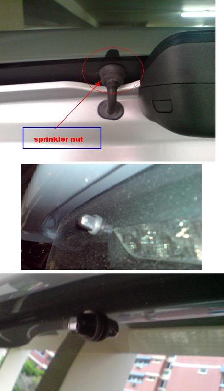

Originally Posted by setter11
Video: (In Action)
Pros:
No dust collection
Cons:
it can spray on ur wiper
