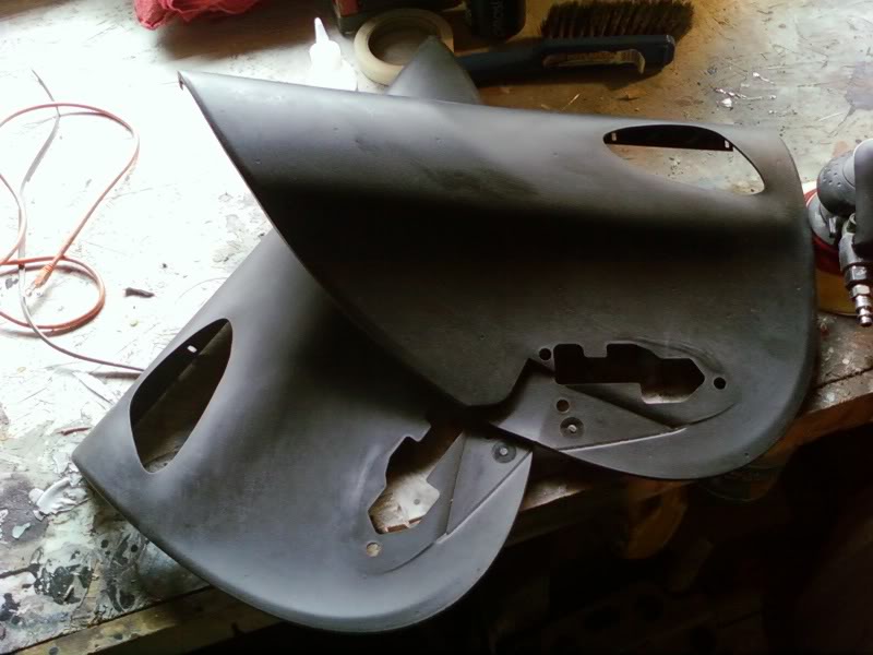

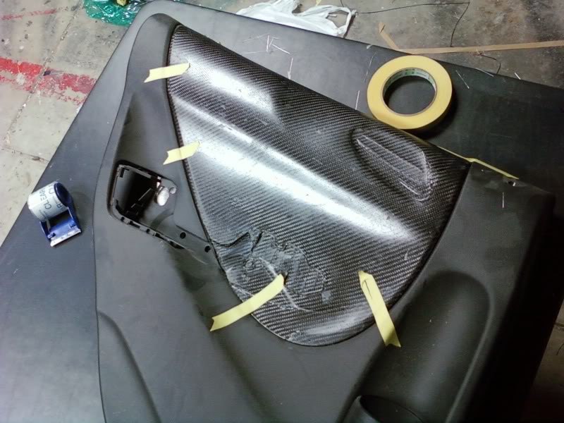

This is something Ive been working on for a member of the forums. He sent me his door panels so I can replicate the inserts in carbon fiber. This one looks choppy but it was straight out of the mold so it wasn't cleaned wet sanded and clear coated yet. So keep in mind its an unfinished piece but its a mock up.
I thought Id post pictures of the progress so far.

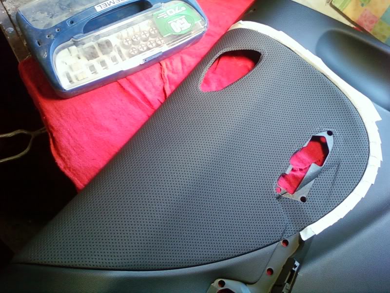

I started by masking the front but then thought it was unnecessary since theres no way I can damage the front by cutting the back. The back of the panel had to be cut since the factory made the door panel as a one piece mold.

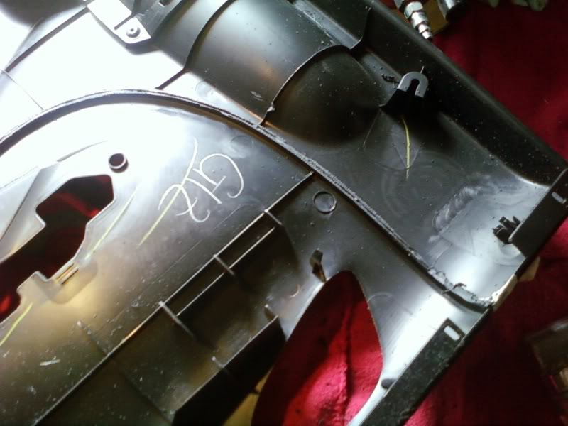

You can see I just cut in the center of that line and then grinded it down a little until I got far enough that the space opened.

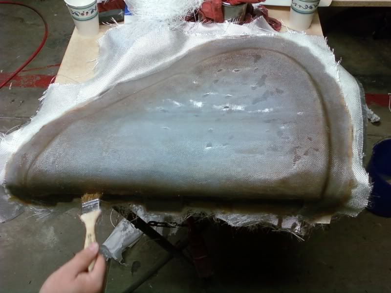

The mold was created - That was a very tricky and complicated task.

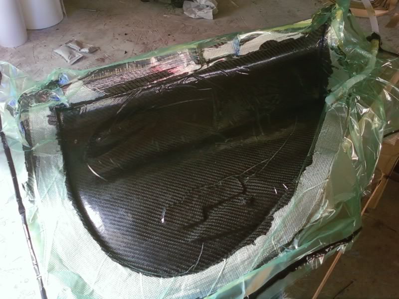

The carbon fiber was put up in the mold and then vacuum pressed so all the corners are tight and pushed in.

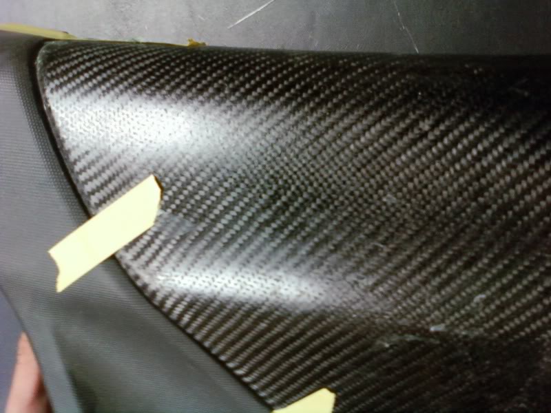

And the semi finished product

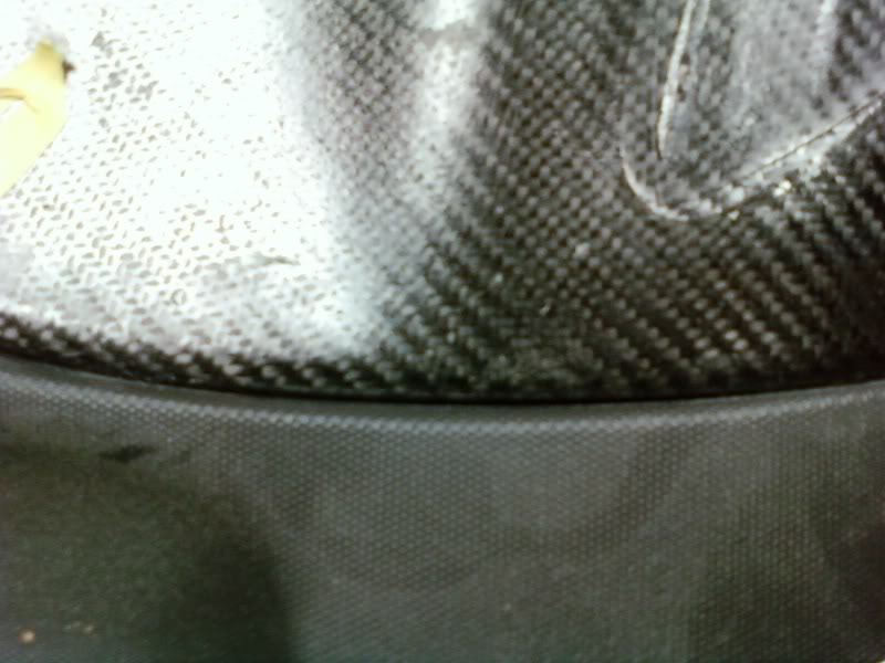

All the edges are perfect!
Tadaaa! This was just to show some of our work. Ill post finished pictures soon. Im also doing the front and then will be creating carbon fiber left and right speaker boxes for the trunk. This will all be done in the coming weeks.
