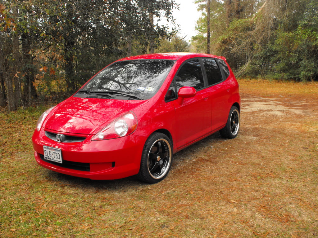

I have serious vibration out front and I have ruined a set of tires. I was told the struts need replacing before I got new tires. I was wondering where to get a cheap price for set and if I can do it myself or will it need an alignment.
Alignment is $80 at Honda Service, and I can handle that, just not the $600 to buy them there with labor cost.
I tried looking for the DIY Airshock thread but didn't find anything.
I have 17's
