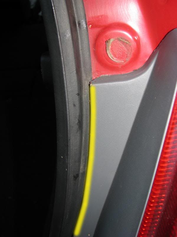

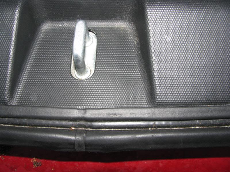

OK, if you need to seal the hatch gasket (if the roof rail procedure doesn't catch it all) here's what I did. Again, you can't see where the water comes in--it's behind the interior panels which you don't have to remove but I did to eventually see this little trickle that soon makes a small puddle around the jack in the spare tire well.
My Fit is not usually this filthy but it's been a long winter and I'm busy. Anyway here's the area I'm talking about on the driver's side:

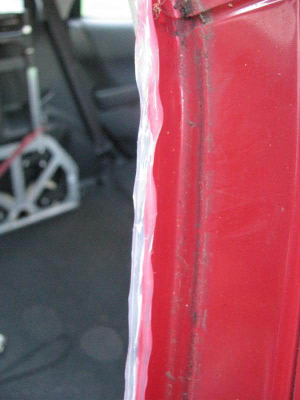

On the passenger side, I've pulled the gasket off (you can do about 2 ft sections so it stays in place while you seal it):

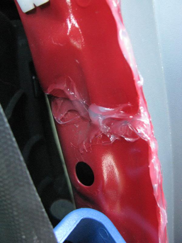

If you want to remove one screw and one plastic pin down on the floor and carefully pry back the interior panel you can seal this spot which is exactly where the water enters the interior:

I didn't make a work of art out of it because the panel covers it up again anyway. If you get the gasket itself sealed the water should never get to this point but I did it anyway.:

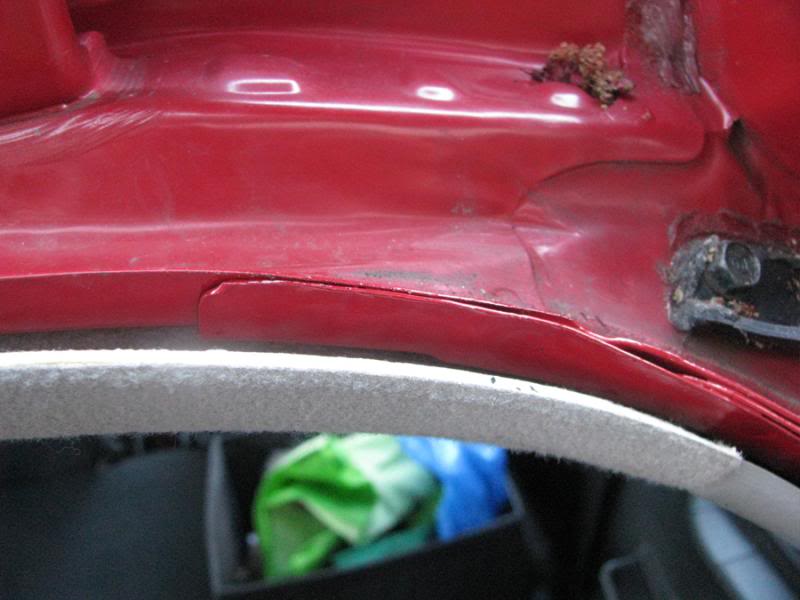

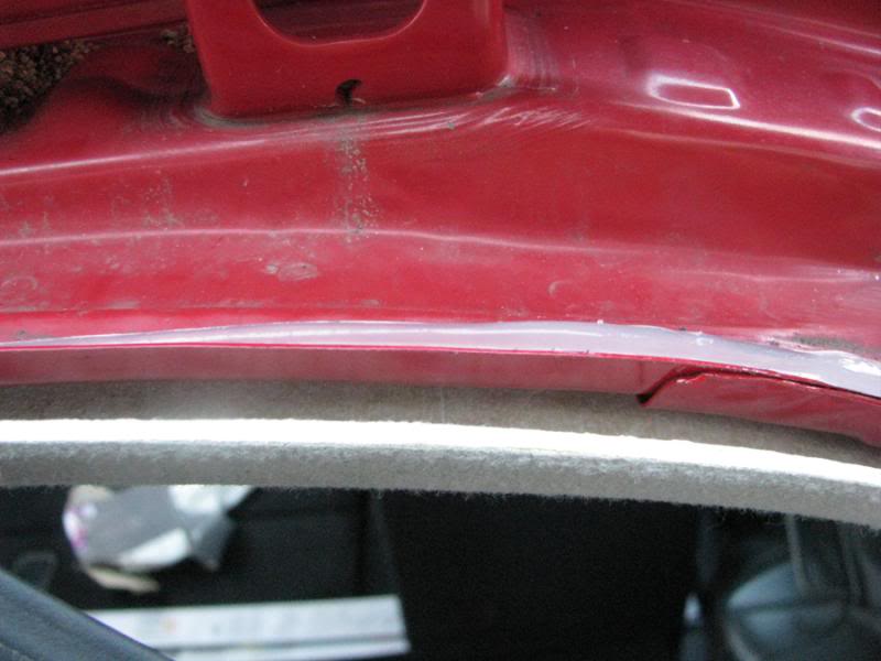

But back to the top you see this flange made of the overlapping sheet metal:

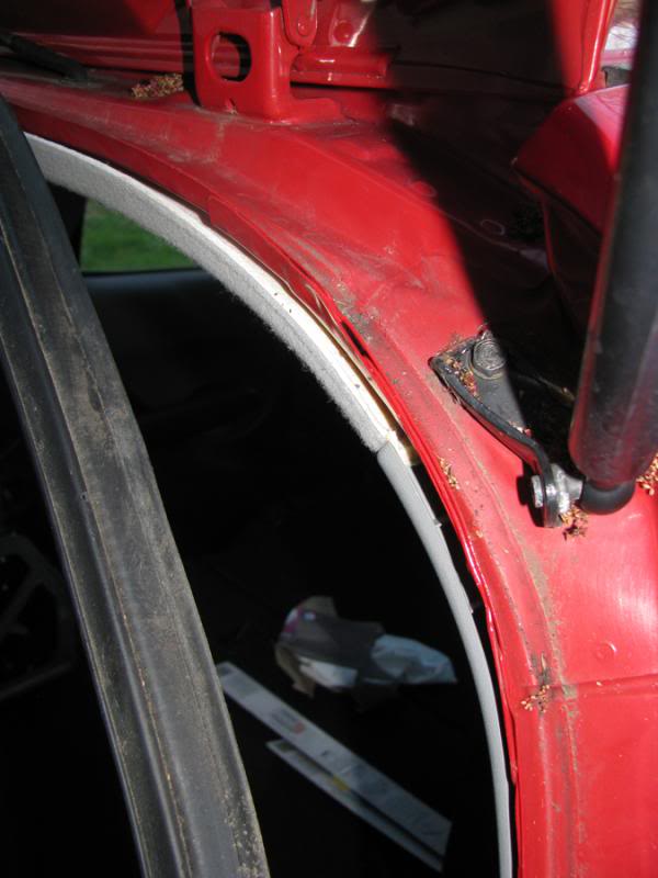

You want to get silicone sealer all along the outer edge especially:
It doesn't hurt to fill all the little seams where this metal edge overlaps itself. I went down well below where the tailight housing is:

When you push the gasket back on, some of the sealer might squeeze out. You let it set and trim it off neatly if you want but you need to get it UNDER the gray edge of the taillight housing highlighted here: A small plastic putty knife helps or use a large screwdriver very gently:
