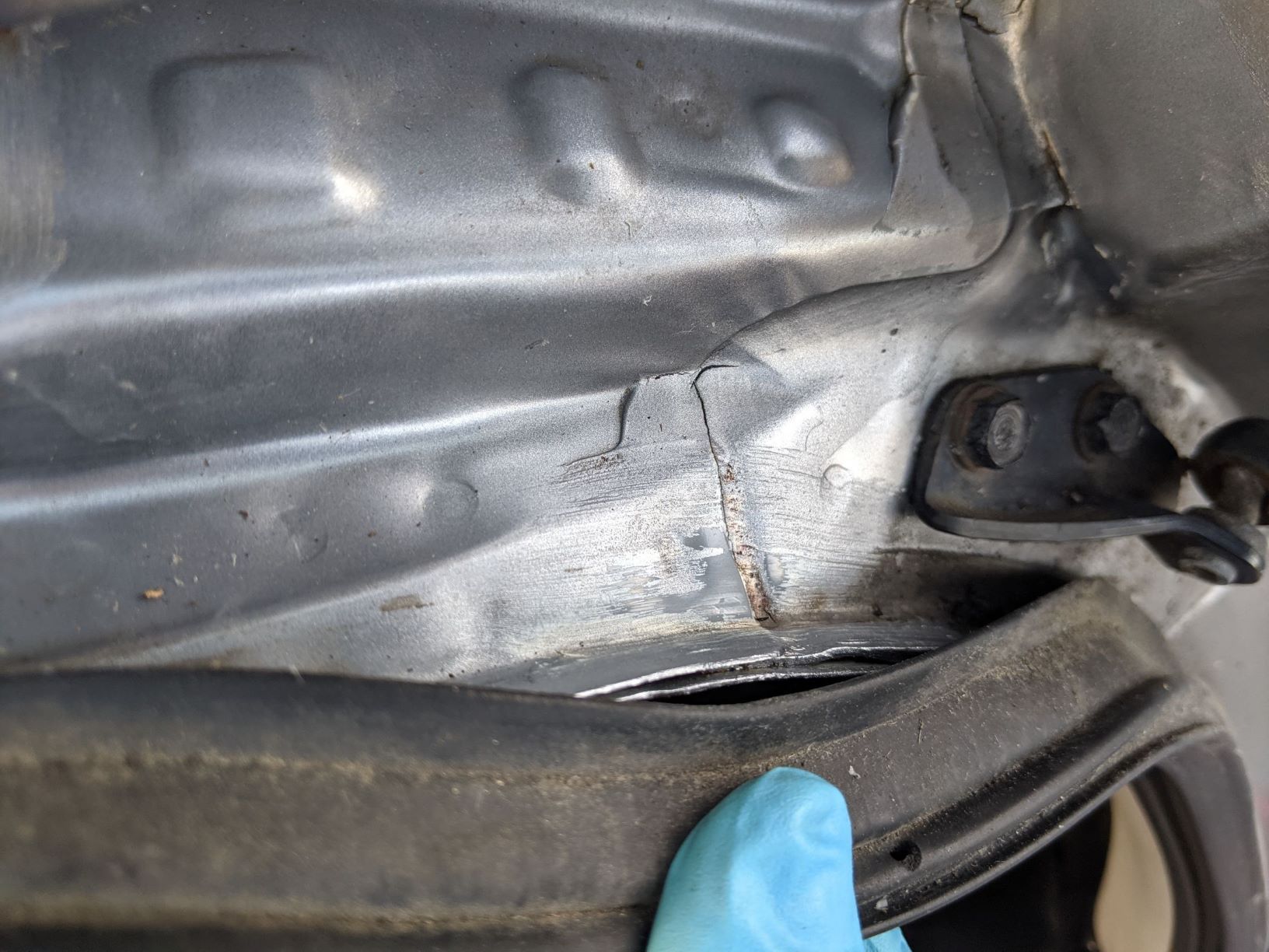

I found this forum a couple weeks ago
Today we had nice enough weather for me to try
Bingo. Do you see the crack?!
I cleaned up and hope this stuff will do the job.

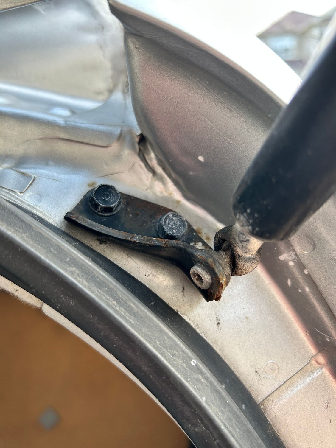

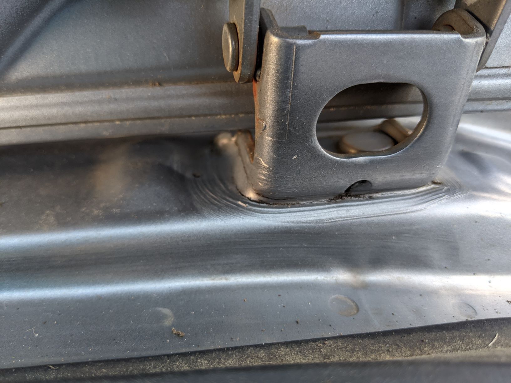

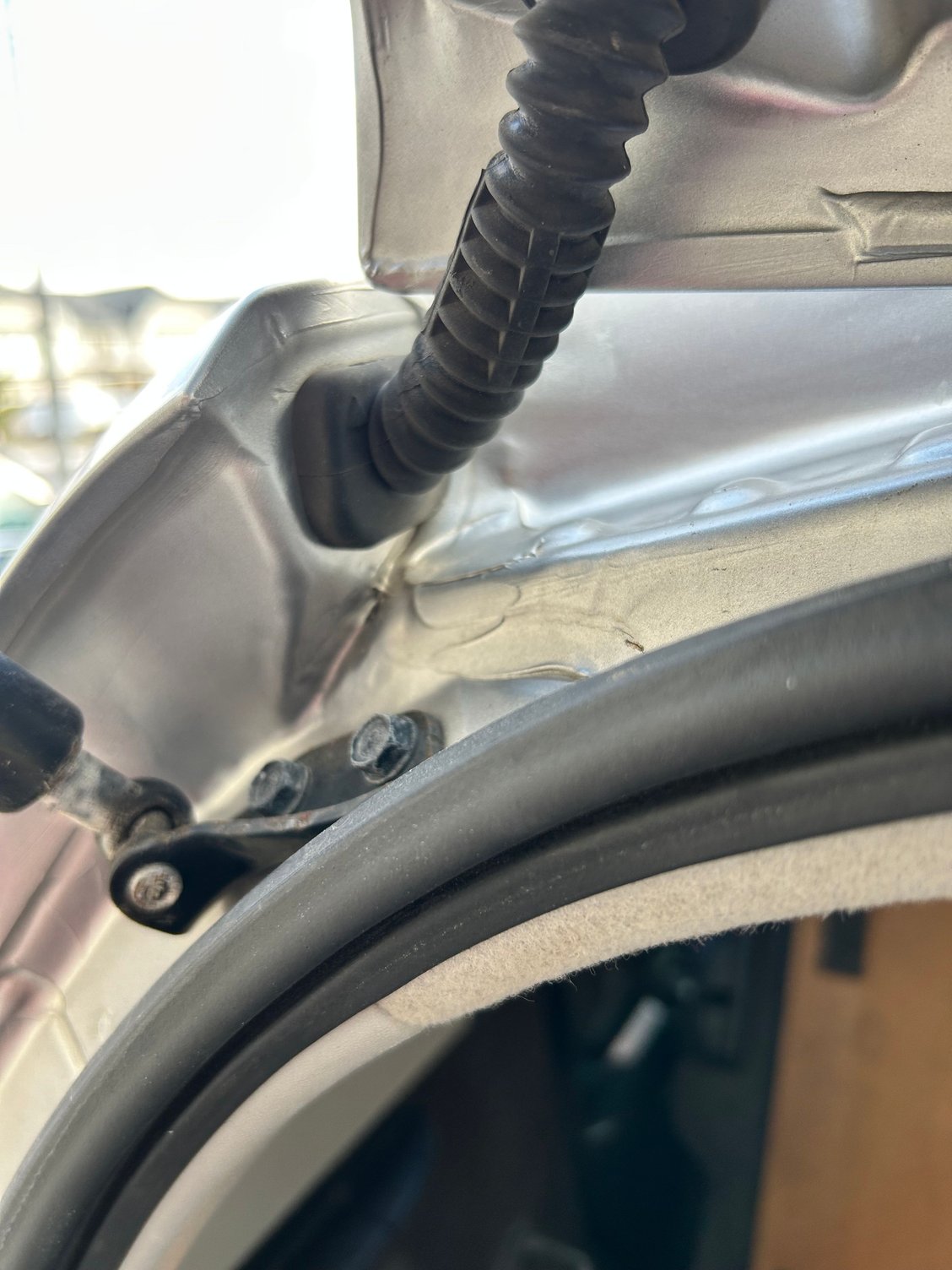

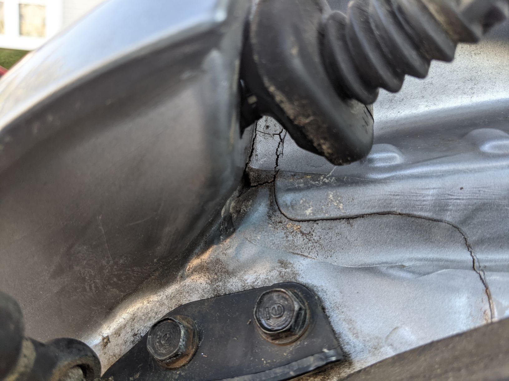

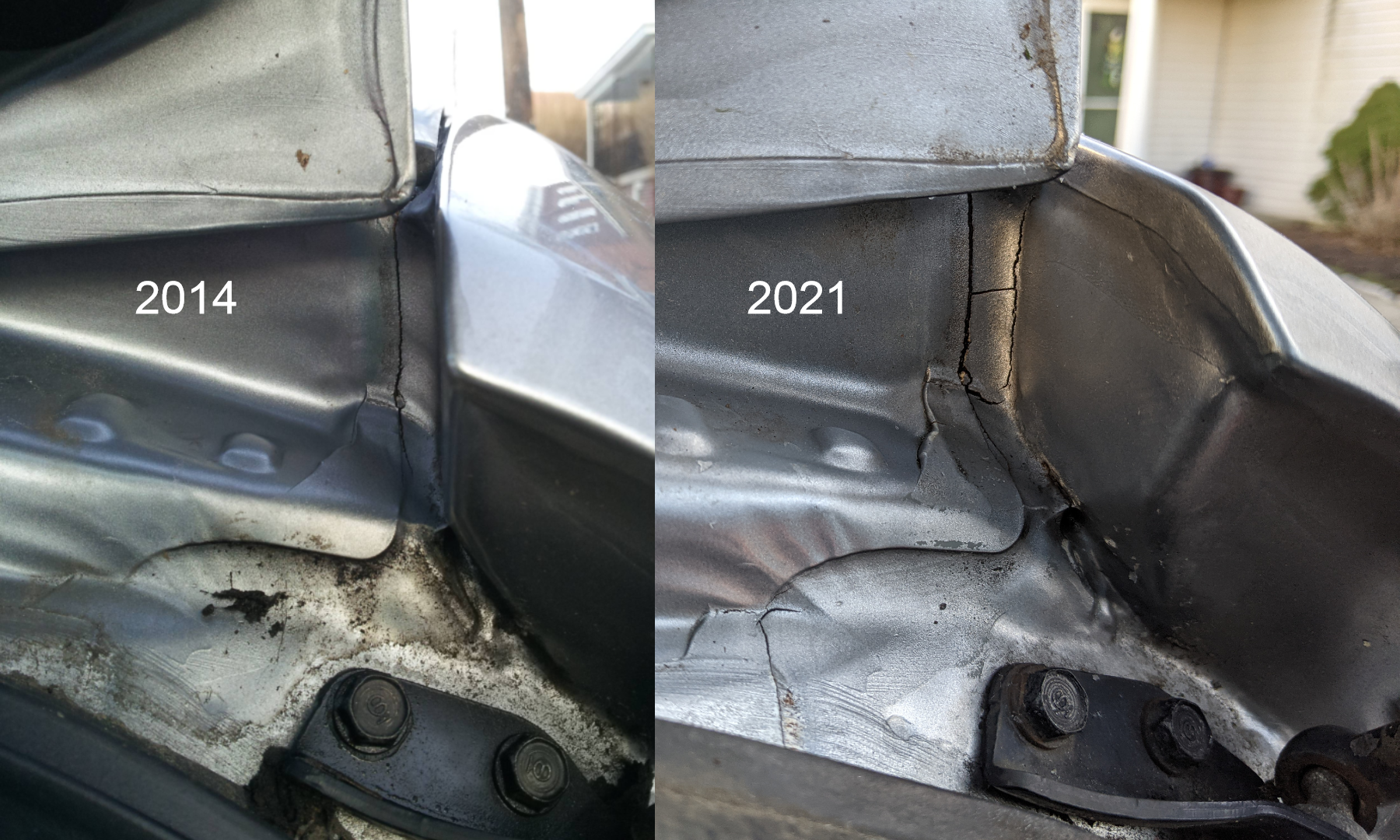

As mentioned, I have water in my spare tire area again, so have to reseal. I noticed that the cracks have grown in the 7 years since I last looked at them- check this out:
In my opinion, it's pretty amazing how the cracks have progressed in 7 years. The upper right section now looks like it's about to lose a rectangular chunk altogether, and notice how a crack emerged near the overlapping arch-shaped piece of sheet metal towards the bottom. It extends underneath the weather stripping, so I pulled that back and sealed it up too:
The left side is harder to see because of the rubber wire protector, but it has also seen the cracking progress significantly in 7 years:
Finally, the hinges themselves have seen some cracking appear around them. The right side is the worse of the two. Here's a pic of that:
The cracking around the roof rails is a little nuts to me. It seems as though eventually the only real solution may be to do some small scale real bodywork, wire-wheeling or grinding out the old seam sealer and applying brand new stuff.

All that cracking is just sealant though, and not the welds underneath, right? That's quite annoying but thankfully not the end of the world. I haven't noticed any leaks in mine but I haven't really looked at the sealant itself yet.

Yep, just seam sealer. Not the end of the world, just annoying.

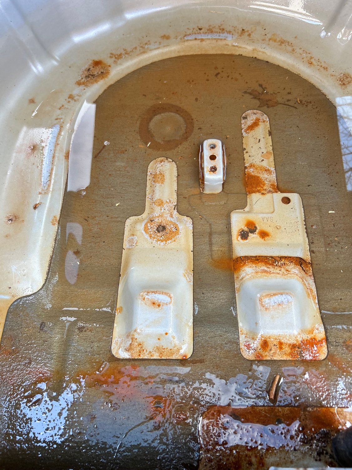

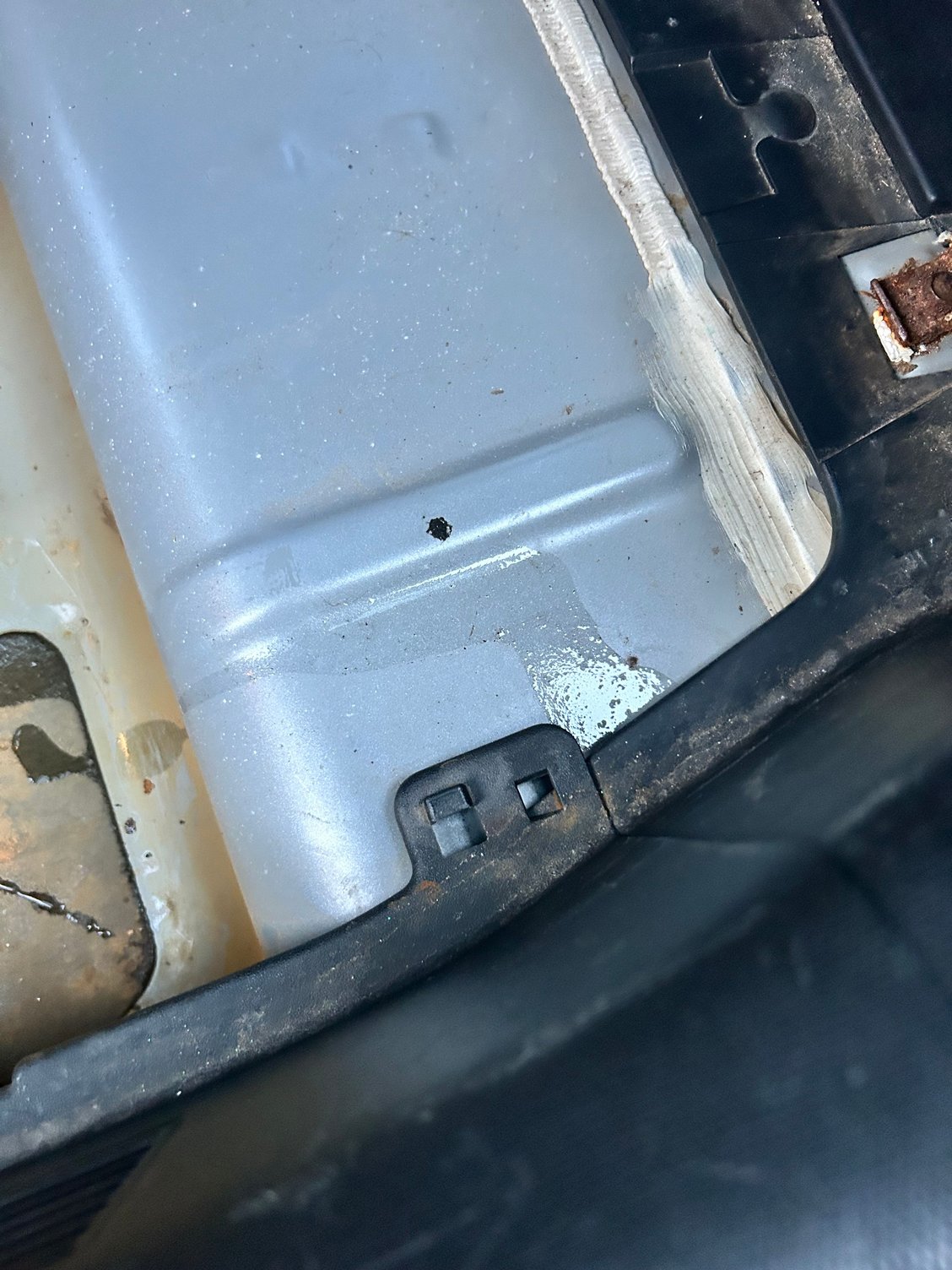

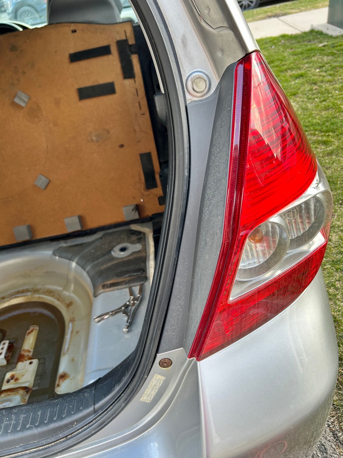

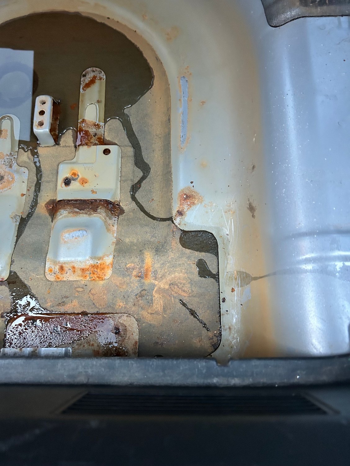

Well I find myself dealing with this issue. I had no idea why my car smelled like dirty boot water. Well I found a pool under my spare tire. Check this out.
i
checked my seal. Seems fine. I checked around the struts for the hatch and seem fine. Even the bottom of the cover is dry and no signs of water trickling down into the spare tire. Any idea where this water continues to come from?

Check the tail light gaskets?

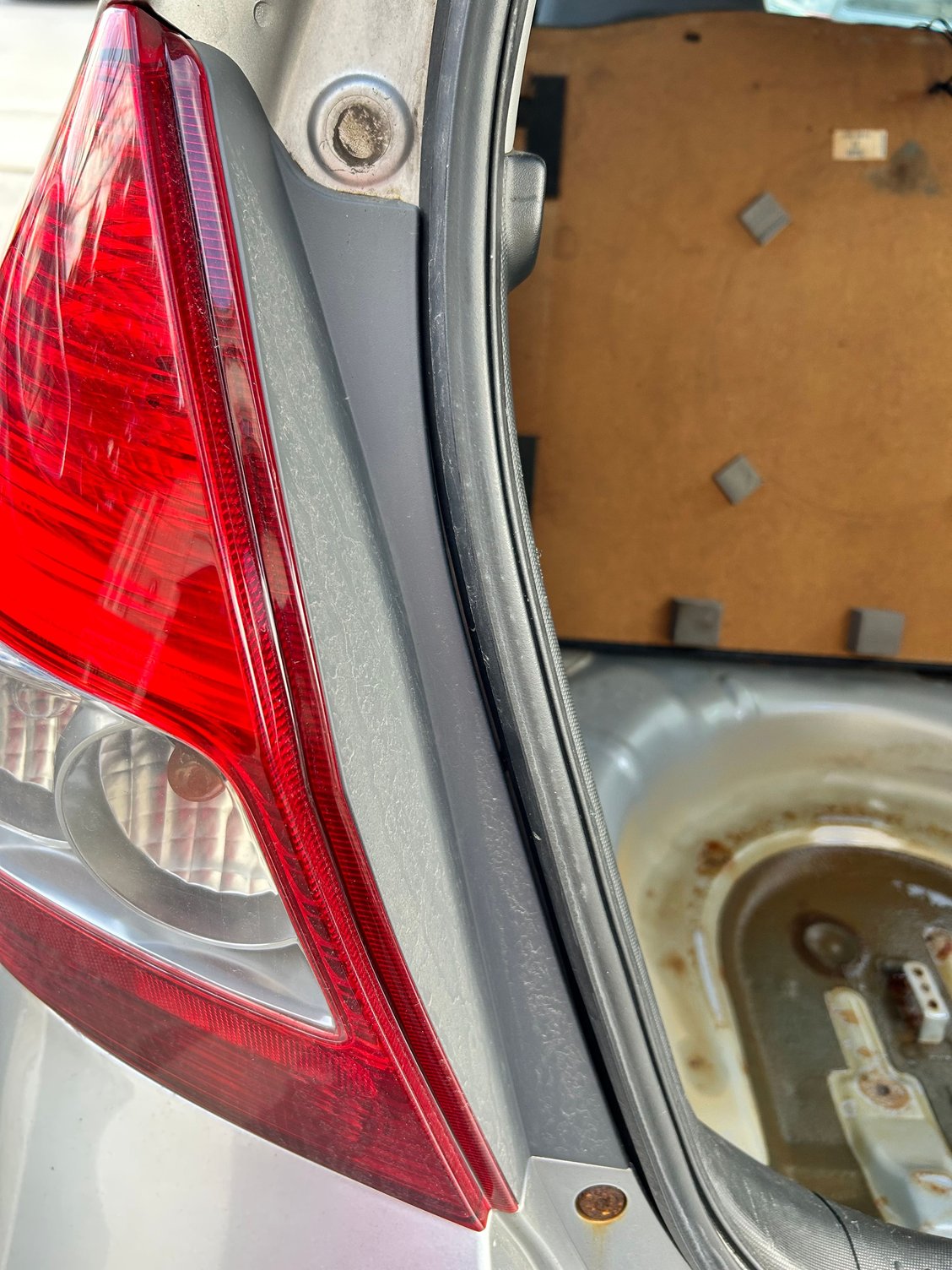

Originally Posted by bobski;[url=tel:1488932
1488932]Check the tail light gaskets?
have not checked that yet as I haven’t pulled out my taillights. Those gaskets are real cheap at about $23 a pop. But I did pop open my access covers to change the bulbs and didn’t see any sign of water in that area. So that would mean the gaskets are fine and the water isn’t coming from there no?
Huge rainstorm last night. I think it’s coming from the right side as I noticed a stream this morning. The foam under the centre interior panel by the latch was soaked too. I just have no idea where from the right it’s coming from.
