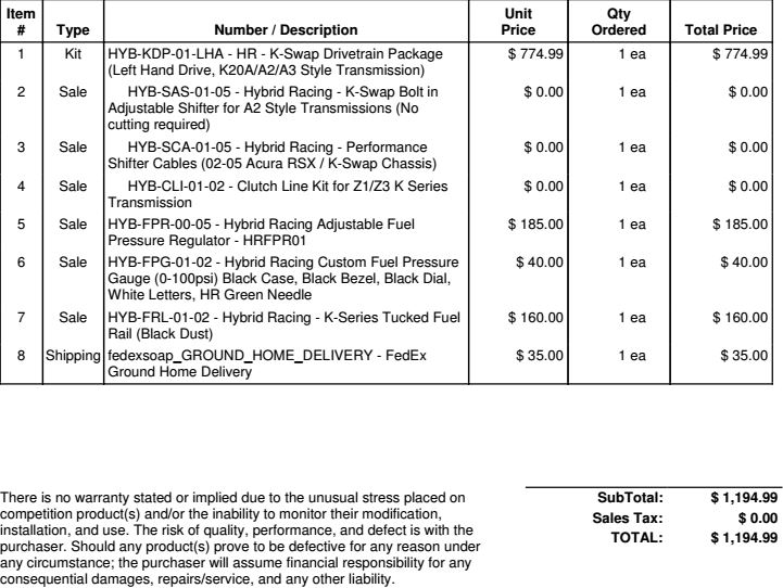

I was into the same thing, turned out to be too costly, you'll essentially be paying the price for another used Fit or something. I mean, I would totally do it but I could just get a better Civic Si for 12k instead.
Here is an estimate for some of the bits and pieces from Hybrid Racing.
Cables, fuel stuff, etc.
on top of this you'll have to supply:
Engine Mounts by Hasport - about 300 dollars (?)
K20 engine - about 3000 dollars
Tranny from an RSX - 1500 dollars
ECU from RSX - 500 dollars
then there are engine components like the headers and stuff.
