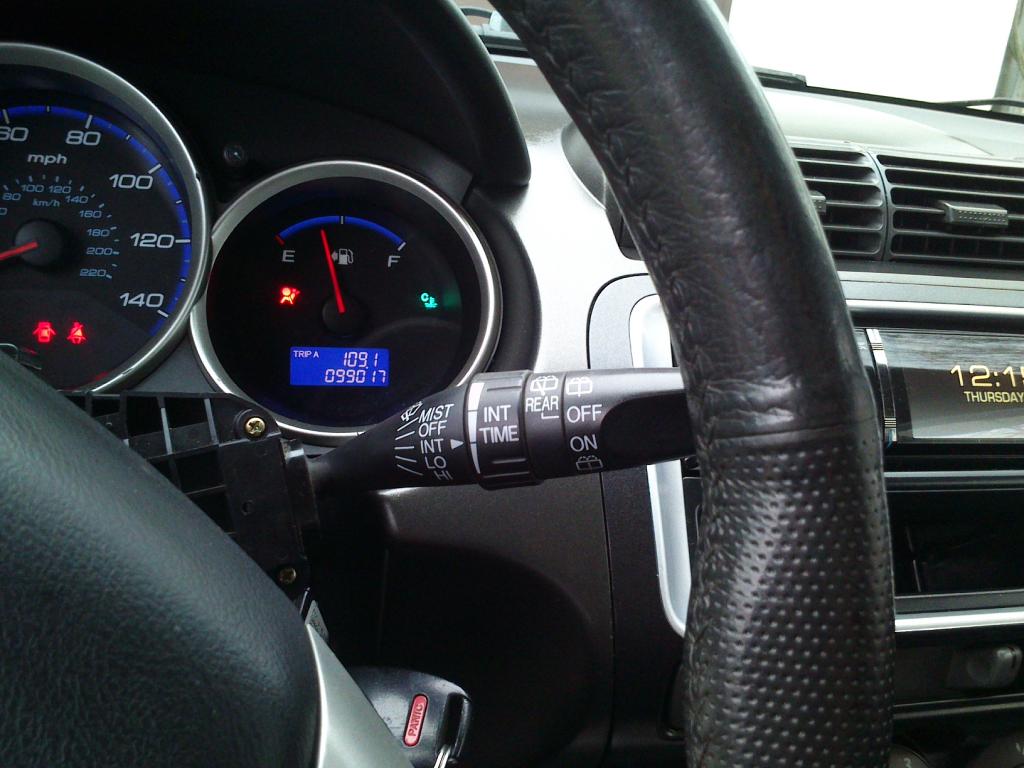

I did it.
I just bought a used wiper stalk from 2006 FR-V, and installed.
No another pins or wireless needed.
Plug and Play.

Original Honda part number for Honda FR-V wiper stalk is: 35256-SJD-G01
Stock 2007 Fit Wiper Stalk (On Top)...
FR-V Stalk on Bottom

Yes, i have lived in Czech republic, which is in the middle of Europe. But how you can see, i am a 2007 USDM Honda fit (1.5 AT Sport) owner. So i installed a European Honda part into a US market car. And it woks.
Here in Czech is not problem to go to the Original Honda dealership with a US part number and make a order... Yes, it takes for example 2 weeks, beceuse the shipping takes some time... But I can wait :-) I know it bacause i ordered a rear engine mount for my US Fit.
So maybe You in USA can make a order for European part, when you have a number...

I have original Vin number that FR-V from whose i used the wiper stalk. It is JHMBE57206S200144. So i called to the Honda dealership, and asked for the exact part number. They gived to me a little bit different part number. 35256-SJD-E01. I donīt know what the difference between G01/E01 is, but my wiper stalk has a E01 on the end...
