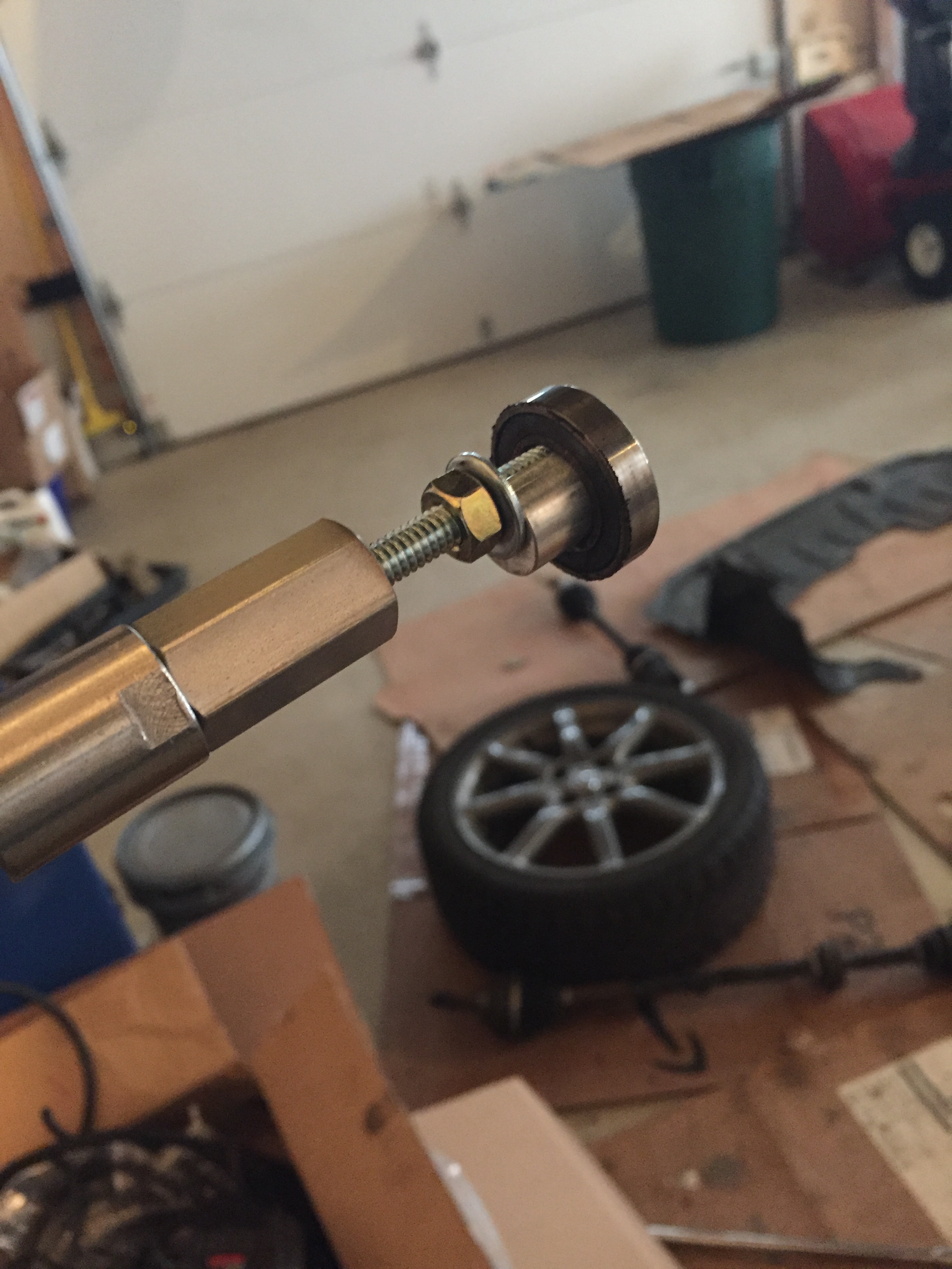

I really couldn't find much info on changing a clutch on the GD so i figured I'd chime in and give my experience.
I bought my 07 sport with 42k miles. At 50k it started getting notchy going into gear. When hot it would get so bad I had to really force it into gear. I tried adjusting the clutch master rod, but once I got it shifting smoothly, it started to slip. I backed off and dealt with it but finally it started slipping again so it was time to get in there and have a look.
If you have ever done a clutch before, this is just as straightforward as any other job. You don't have to drop the subframe, don't have to disconnect any coolant lines and you dont even have to unbolt the starter from the engine. One starter bolt passes through from the transmission side so just take that one out. Once you get the intake and battery out of the way, you have lots of room to work with. You could even leave the pass side axle in place, but I didn't want to risk damaging the boot so I took it out. It gave me the opportunity to lubricate the splines to make sure it comes apart in the future. The clutch slave unbolts and once you unbolt the line you can lift it up and out of the way. The worst part of the job was separating the tranny from the engine. The dowels that held it together where so corroded that I had to literally hammer screwdrivers between the block and tranny, wedging them in place to spread it apart. I show the location in the attached pic for reference. You want to make sure to spray penetrant in that area pry close to area to get it free. I have done lots of clutches but this was the worst I have dealt with.
I used lots of long extensions to get to the motor mounts and engine to transmission bolts and that definitely makes the job easier. I did it on a lift so I used a screw jack to support the engine while I did the job. The kit i used came with a pilot bearing. I made a small tool to pull it out using a slide hammer. Any pilot bearing removal tool would work. It doesnt take much force to pull it out, I just didn't have one. One other issue I ran into was with the Sustec lower tie bar that is on the car. It was in the way, so I had to unbolt it. Unfortunately, the previous owner didnt grease the lower control arm pivot bolts. The driver side came out easy, but the pass side was siezed to the bushing sleeve. Luckily I was able to unbolt the rear pivot of the LCA and the lower ball joint, then swing the arm and tie bar down enough to get it out of the way. The hole in the tie bar is big, and water must have gotten in between the bar and the subframe causing the rust. I will have to deal with that some day, but I will be prepared when that time comes. That lower bar is a flimsy thing. I could literally bend it with my hands. I cant even see how it even does anything.
Once I pulled out the clutch I looked at the disk and it was in really good shape. I was shocked and was kind of worried. It was about 6.5mm thick and my new one was about 7.5mm thick. I was worried I ripped into it for no reason and may have had a hydraulic issue and overlooked it. Then I noticed that the springs on the diaphragm weren't flat. A few of them were collapsed. Who knows what caused it, but that was the reason the clutch was dragging causing it not to disengage and shift smoothly. Relief.
I ended going with an Exedy hck1006. I resurfaced the flywheel and changed the pilot and throw out bearing. While I was in there I changed a noisy axle and 3 of the 4 motor mounts. When the previous owner did the lowering springs, he pinched the axle boot and grease was slowly getting out and moisture was probably getting in. When cold it would click, but would go away after 10 min of driving. After it went back together I filled it with 1.6 qts of new Honda fluid.
I'm really happy with the hck1006. I should be able to get 200k out of it. I never go through clutches on my daily drivers.
I have attached a few pics.
If anyone has any questions, feel free to ask.

I found a photo as I was putting the trans back in. You can see how I was able to maneuver it around the lower tie bar since I couldn't get it out.

Update on this.
The rear mount is def a pain to do without the subframe removed. Youll need some long extensions, 14mm swivel socket and some gearwrenches. To just replace the mount either the tranny or subframe need to be removed, so definitely change that when the tranny is out.
I just pulled the tranny again at 113k miles. Ever since i bought the car with 42k miles it sounded like it had very loud engine valvetrain. At about 100k miles the noise got much louder. The throwout bearing from the Exedy kit started making some really loud noises so I knew that was another issue. By 110k the transmission sounded scary. The engine speed related whining and ticking had now gotten to the point that it sounded like you could hear each gear of the input shaft mesh and scrape. I bought a new EXEDY clutch, OE throwout bearing, fluid and found a 3000 mile transmission.
When I drained the fluid I was expecting chunks to come out but it wasnt that bad. The fluid definitely had alot of metal in it. The throwout bearing was shot and the clutch springs were rattling around. This made me hesitant to use the Exedy again, but since I already bought it I used it.
***DO NOT USE THE EXEDY THROW OUT BEARING!!!! BUY OE***
I changed the mounts again, swapped in the replacement tranny and the car has never sounded so quiet or driven so smooth. I cant even imagine how the previous owner caused so much damage, but its obvious that if he broke a clutch and destroyed a honda transmission in 42k miles he was beating the shit out of it.
Another note. I used an Anchor transmissoin mount, and when bolted in place the mount was completely misaligned. I had to use a stack of washers and a longer bolt in order to get it to line up properly and not tear the mount.
