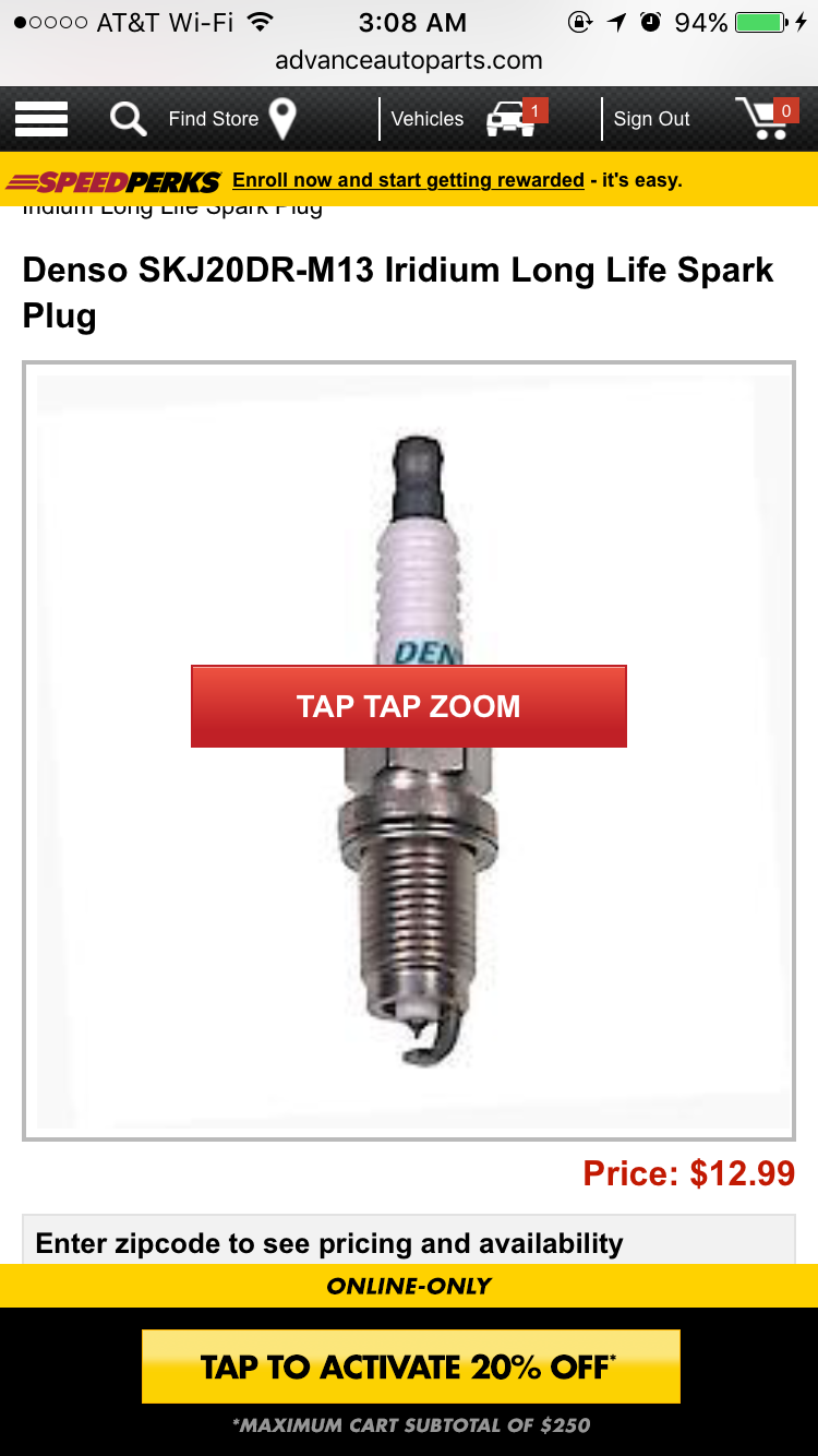

Honda OEM
Honda uses Denso long life from factory. See below for part number for Denso.
Attached Thumbnails What You Choose, iridium or normal?-80-img_8502_297fb9da8f2bd05c81cd27920201cc8bf2483be2.png
