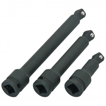

I used my Wobble Extensions for the lower bolt on the alternator.
They aren't as 'floppy' as a true u-joint for the ratchet so it's easier to get it on the bolt underneath without it turning away from the 'target'.
Harbor Freight has both 3 piece sets and 9 piece sets...
