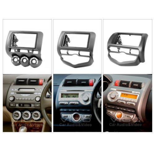

Hi all ,
does anyone has knowledge or has done before from manual dial air conditioner control to an automatic dial air conditioner ?
the left pic is the one I having in my car at the moment , looking to convert to the right 2 pics
Thanks !

You would need to switch out the entire HVAC air box under the dash and install all the wiring required to supply power to the control head and deliver its commands to the new air air box. It could be done if you had a donor car to scavenge all the parts, but it is a very large job.
I know that some people have similar swaps on civics in the 1996-1998 generation to install the 1999-2000 hvac control panels.

This was done by one of the members here for a GE. But just take a read of what kind of work involved.
