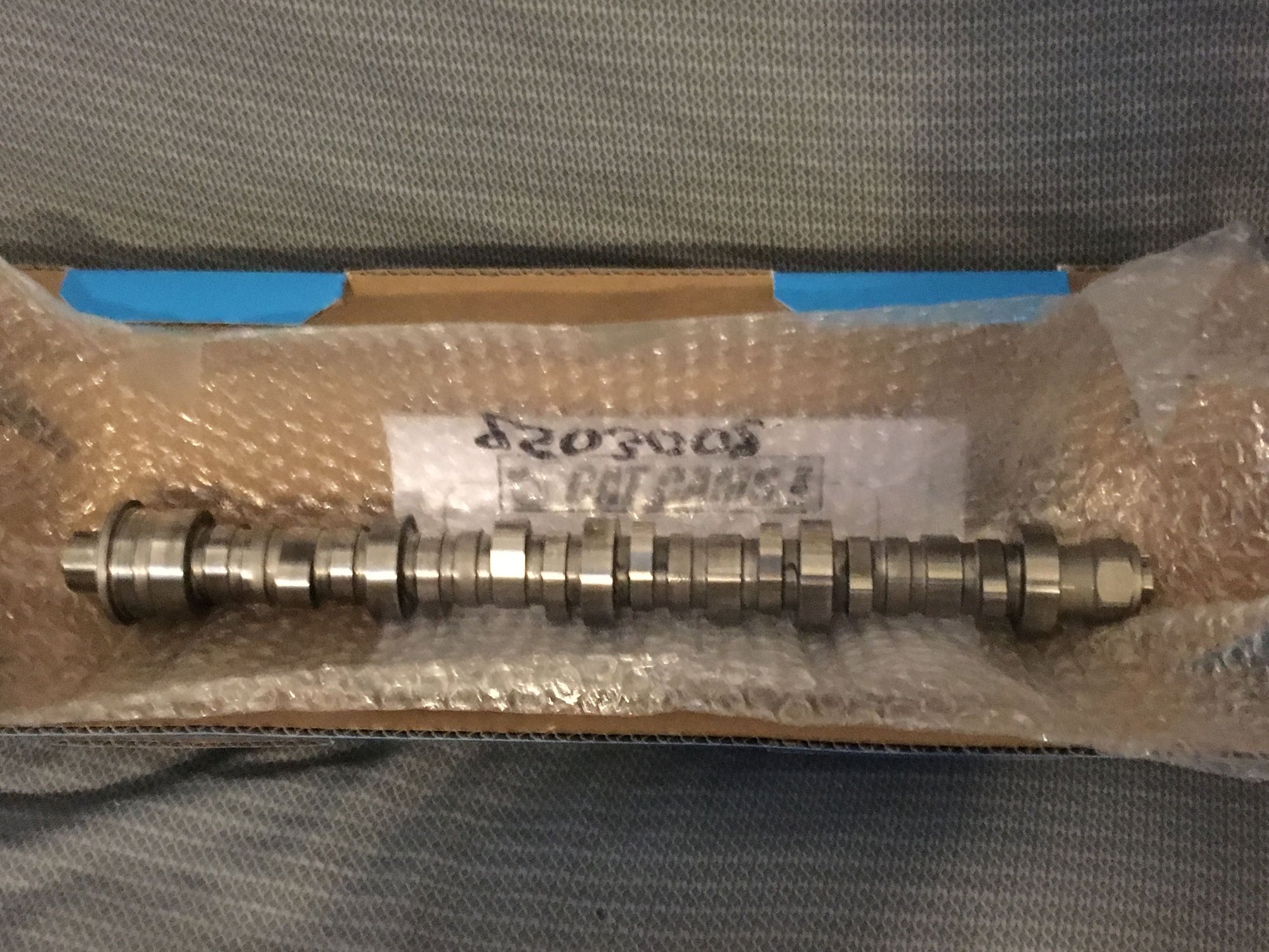

This came today...

Started the cam install tonight. Is going to take me longer than expected. It has to come out the side of the head which means it has to go through the space occupied by the main wiring harness. Can't come out without removing the fuel rail/injectors and complete harness that runs all the way over to the alternator. Thankfully, I'm not in a hurry. This is also Halloween week so lots of plans with the son. Maybe I'll have it done by end of next weekend.

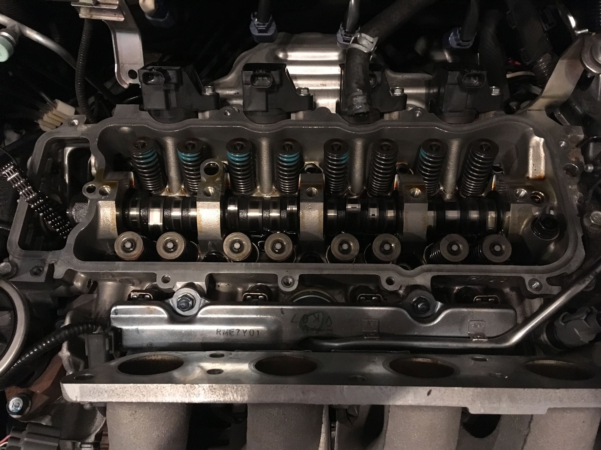

Not a whole lot to see, but here goes...

Stock cast camshaft above and Cat Cam billet below for comparison.

There we go! Seems a bit ridiculous to not have cam caps and be able to lift it straight up on a OHC cylinder head, but ok Honda. At least you didn't have to remove the head.

Yup, it is basically wrong. I have the FSM and this section just isn't accurate or is glossing over major steps. One glaring error is it says to use a 27mm wrench to hold the camshaft. Well, it's 29mm, not 27.
One of the things it glosses over is that "remove harness holder from bracket" on 6-24. It only lists a few of the items you have to disconnect in order to remove that harness from the bracket. It's all one wiring bundle all the way to the alternator and includes the fuel injectors, starter motor, etc connections.
If there's a way to do it by removing less, I don't know what it would be. Even with what I removed, I had to pull pretty hard on that wire you see on top of the camshaft. The cam can't fit over without also removing the radiator hose, so I lifted it up and pulled the camshaft out between the two.
None of it's hard. Just takes time.
Here's where I'm at now...
