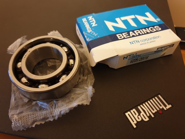

Yeah I don't really know how actually compatible they are, but I used videos of Civic transmission rebuilds as a guide and everything was completley identical. Of course that's just on the high level, the dimenions could be slightly different somewhere and they'd never work together. Still, economically it would make more sense for Honda to have compatible gearboxes rather than build several different ones for no good reason.
Great that you god the LSD. I kind of considered it since taking everything apart was by far the biggest pain in the ass, but it wasn't really worth it for a low powered beater I thinkl.
The input shaft bearings were NTN 6205/26V16 and SC05B97, about $10 and $15 I think. Didn't touch the other ones since, again, beater.
