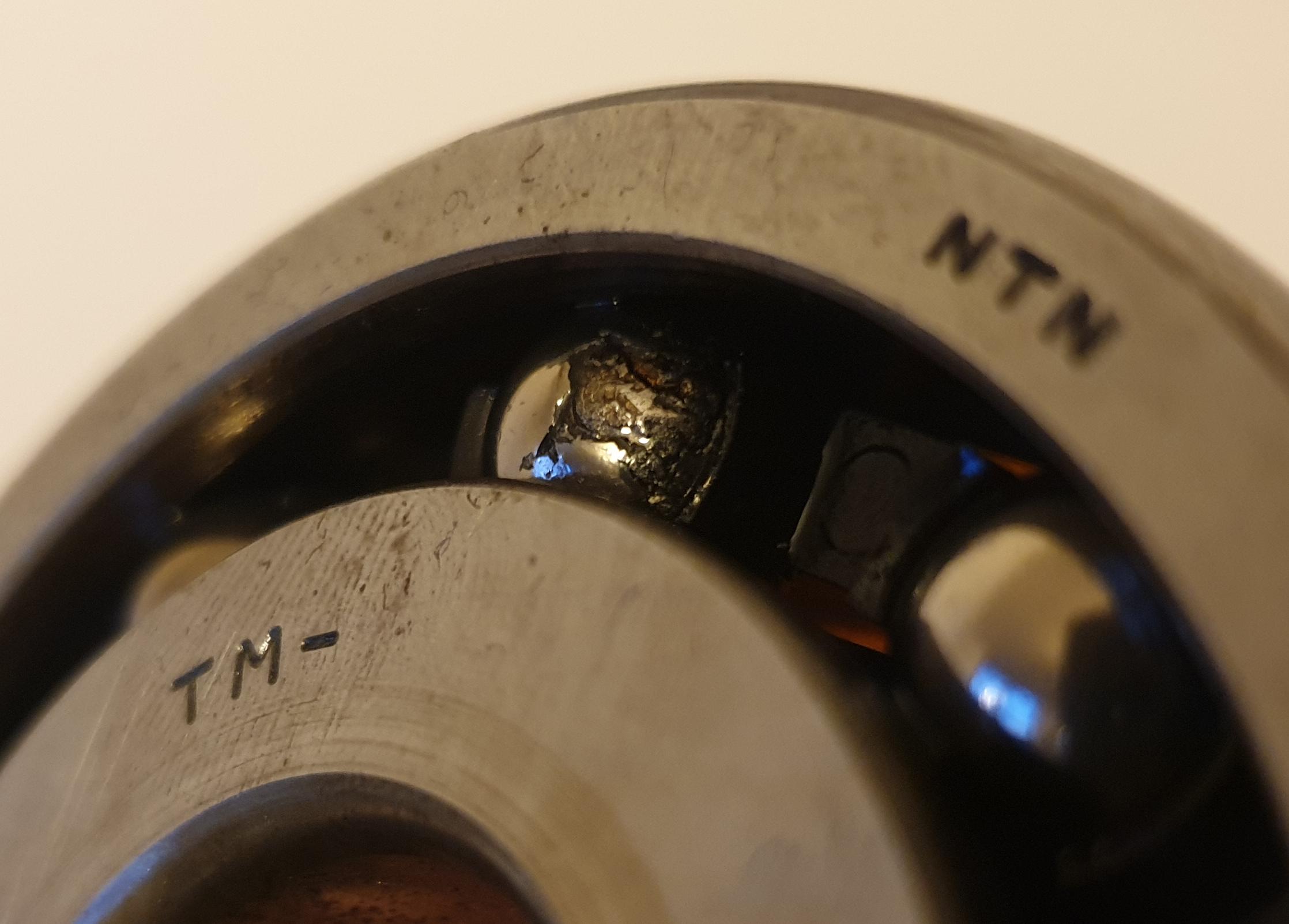

Nope, that was just my gearbox spinning away at idle speed lol.I just finished replacing it, it was mostly the larger rear bearing:
https://i.imgur.com/89kPqbj.mp4
You can get direct replacements from NTN, as you can see they made the original ones too.
