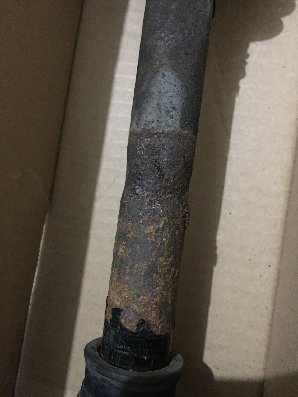

From: Middletown, CT
Originally Posted by BilgeRat
It's an issue, and it's the salt put on our northern roads in the winter. The salty road water gets into the damper and stays there, corroding the axle inside the damper until there's not enough solid metal left to handle the torque.
About ten days ago, I tried to leave a traffic light. BANG! SHUDDER! CLICKCLICKCLICK... No forward or reverse. I looked under the car, and there was nothing obviously adrift, but I'm in the middle of a busy intersection with a no go car. As I couldn't see anything adrift underneath, I started suspecting the transmission.
Anyway, two cops helped me get the car out of the intersection and into a driveway, and I called a local shop that I deal with when I can't do the work myself, and had it towed there. They called me later that day to say that the right half shaft had snapped inside the damper, and that was the reason for no go and nothing adrift. They asked if I wanted to replace both half shafts, and I said HELL YES, taking no chances on a repeat. A week later and $700 bucks lighter, I had the car back. The shop owner and the lead mechanic both said that they had heard of this issue, but my '07 Fit was the first one that they had seen. They also opined that this should be a recall issue.
The thing about this that scares me green is that I just came home from a 2000 mile round trip from home to a friend's place in Texas. I hate to think what the result would had been if this had let go on I-35 at 78 mph. That broken shaft would have beat the underside of the car to death. I'd say to anybody with a Fit driven in the north on salted roads (and I see everyone here so far deals with salted roads) and with more than, oh, let's say 75,000 miles on the clock to consider replacing both half shafts, especially if they show any rust near those damn dampers.
I had just opened up the forum to write up my experience and post photos, but the first thing I saw on the header for the 1st generation forum was "Axle Problems???"
Anyway, here's the photos of the remains of my half shaft.
Tom
Update: there are six cases of this failure that have been submitted to the NHTSA.
The whole thing.
The silver areas was all that was still transmitting power to the right wheel at the end
A look into the damper.
BilgeRate, few days ago I had similar situation: my 2009 Honda FIT just exited a highway, stopped at the traffic light and whenI tried to turn right, I heard some noise like if I hit a curb. BUt there was no curb! The car would not move neither forward nor reverse. It just would roll back. When I looked under the car I could not see anything underneath. Called Geico and requested the towing. Waited an hour for the towing to show up and confirm that the front passenger side axel is broken. Luckily, the guy was a tech so he towed my car to the shop and replaced the broken axel with the new aftermarket one. The guy checked the front driver side axel and recommended to replace it too as it looked pretty rusted.

2013 107000 miles Drivers side cv axle shaft broke
To answer the question above its a cv acle bearing for my car its https://www.hondapartsnow.com/genuin...7-sr3-008.html
chances are he just greased the splines a lot and made a bit of a mess. If its not loose or loud its fine
To add to this thread my 2013 Fit Base AT broke its drivers side shaft under the vibration damper. I was pulling away from a stop sign and heard a ping then no movement.
There were none available locally for over 24 hours so I pulled the inner joint and inner half half shaft out by cutting the boot. I then used zip ties to control the wheel side shaft so I could flat tow it to a garage (kept it under 20 with the engine running)
it took about 6 days to get one from rock auto
Replacing it wasn’t too bad but I struggled a little with the ball joint.
I do plan on replacing the passenger side too next oil change. This is definitely new to me doing half shafts as preventative maintenance. 7 years or 100000 miles
New vs old
My zip tie “cage“
A close up
I made a video of the replacement too
If it happens to you please file a complaint with nhsta. If there was more traffic when mine broke it would have been a very sketchy situation. The car almost rolled away on me because without the halfshaft park does not work.
