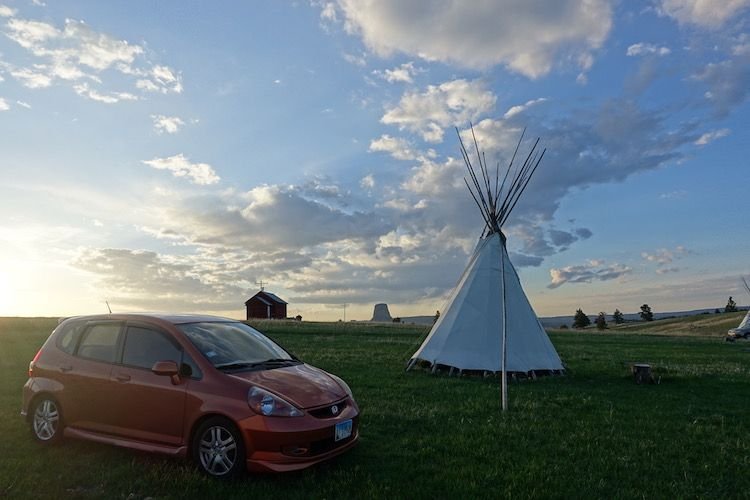

I have progress springs with Tokico HTS and have gone on a 2000 mile road trip loaded with a cooler and camping gear. Also a full 3 piece band's equipment with 3 of us in the car and there was no rubbing or excessive sagging in either trip. I installed this setup last October and it's been great.
I'd be very interested to see what your find out if you call Swift. Im considering a K swap and with investing in HTS struts just last year, I don't want to go out and buy coilovers to get a higher spring rate up front to support the larger motor.
Here's a picture of it loaded with camping gear from our road trip. Wasn't meant to be "hey look how well it sits" type of picture, but you get some perspective from it.
